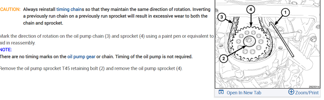

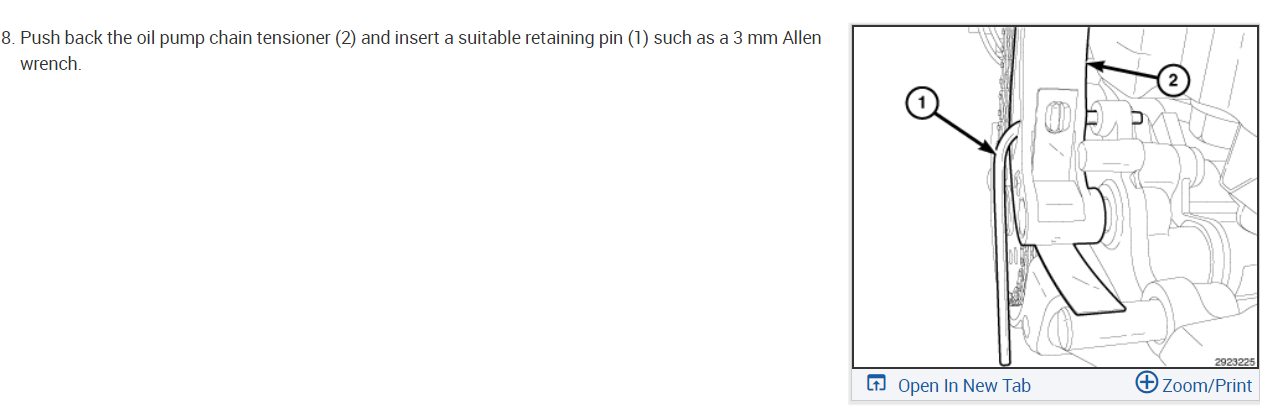

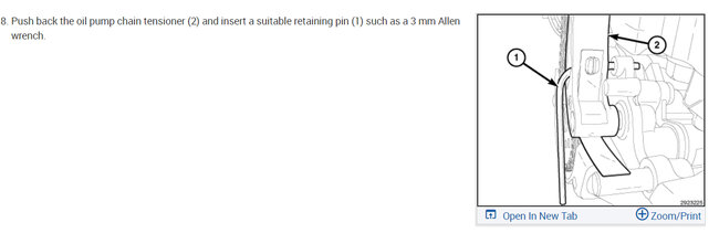

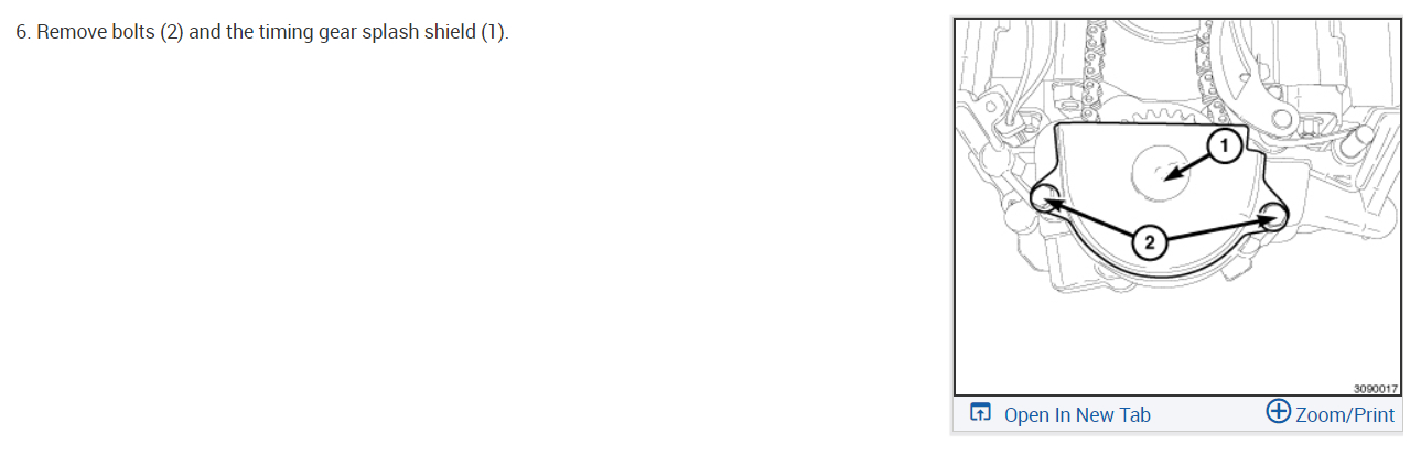

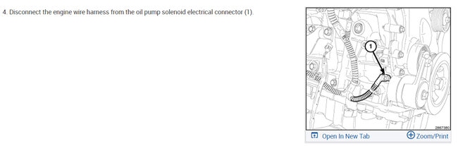

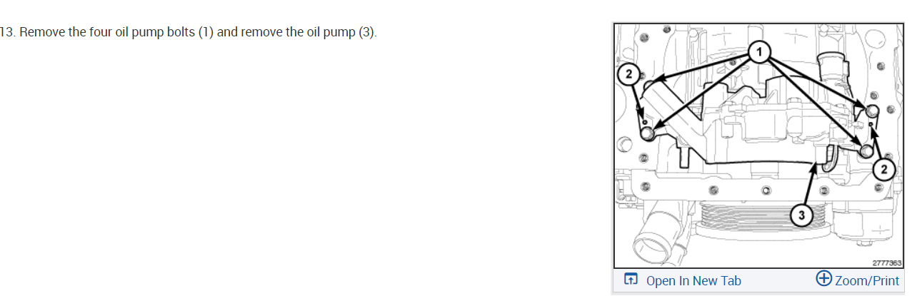

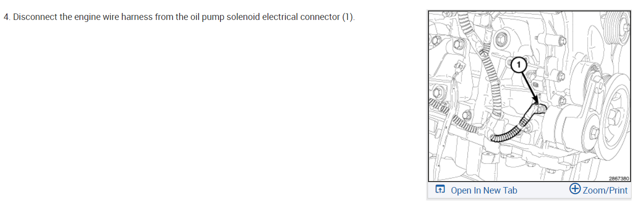

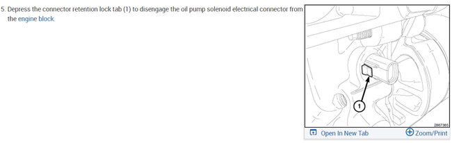

Yes as long as you have good oil pressure it is safe to drive. This means the control solenoid has probably gone out, but this light can also be on if the engine oil is low or the wrong weight.
The P06DD code on a 2012 Dodge Grand Caravan with the 3.6L engine refers to an issue with the engine oil pressure control circuit.

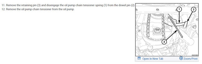

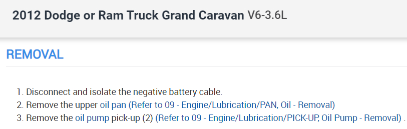

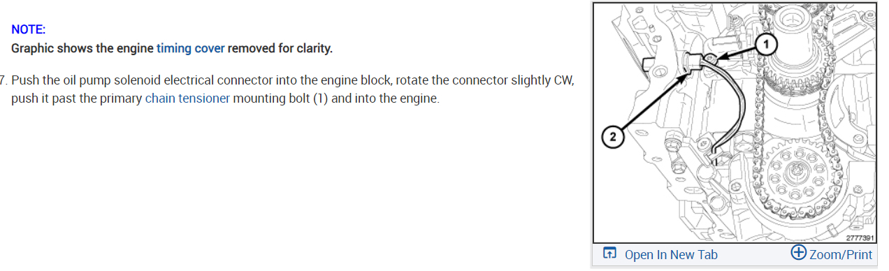

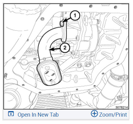

If the oil is correct and full here is how the repair to the oil pump can be done to fix it. Check out the images (below). Please let us know what happens.
