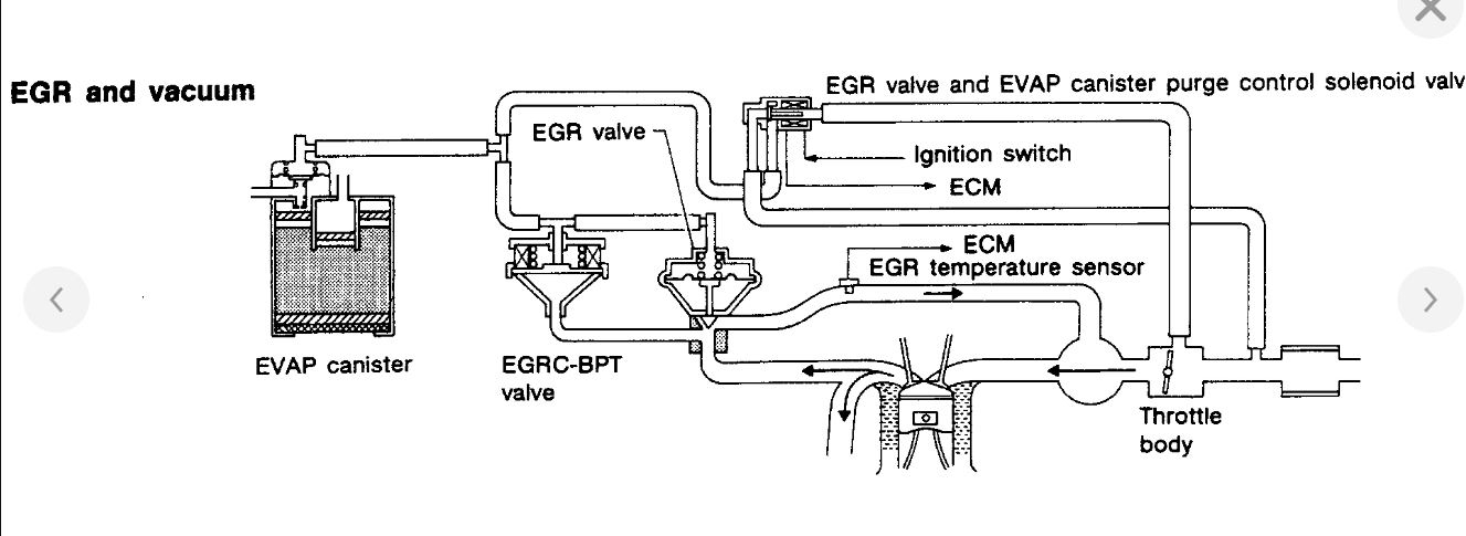

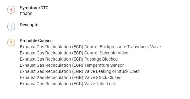

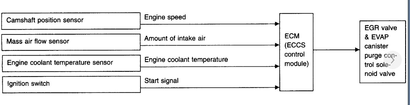

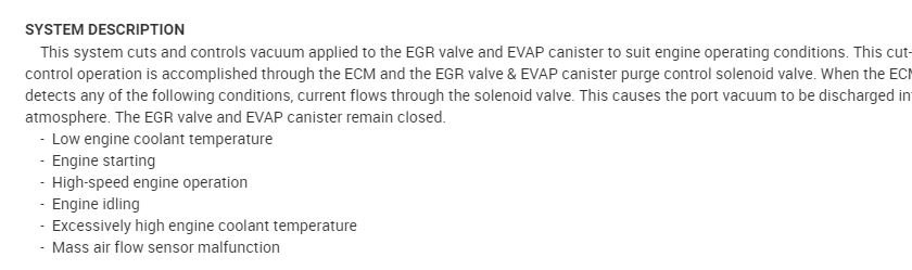

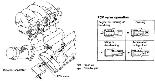

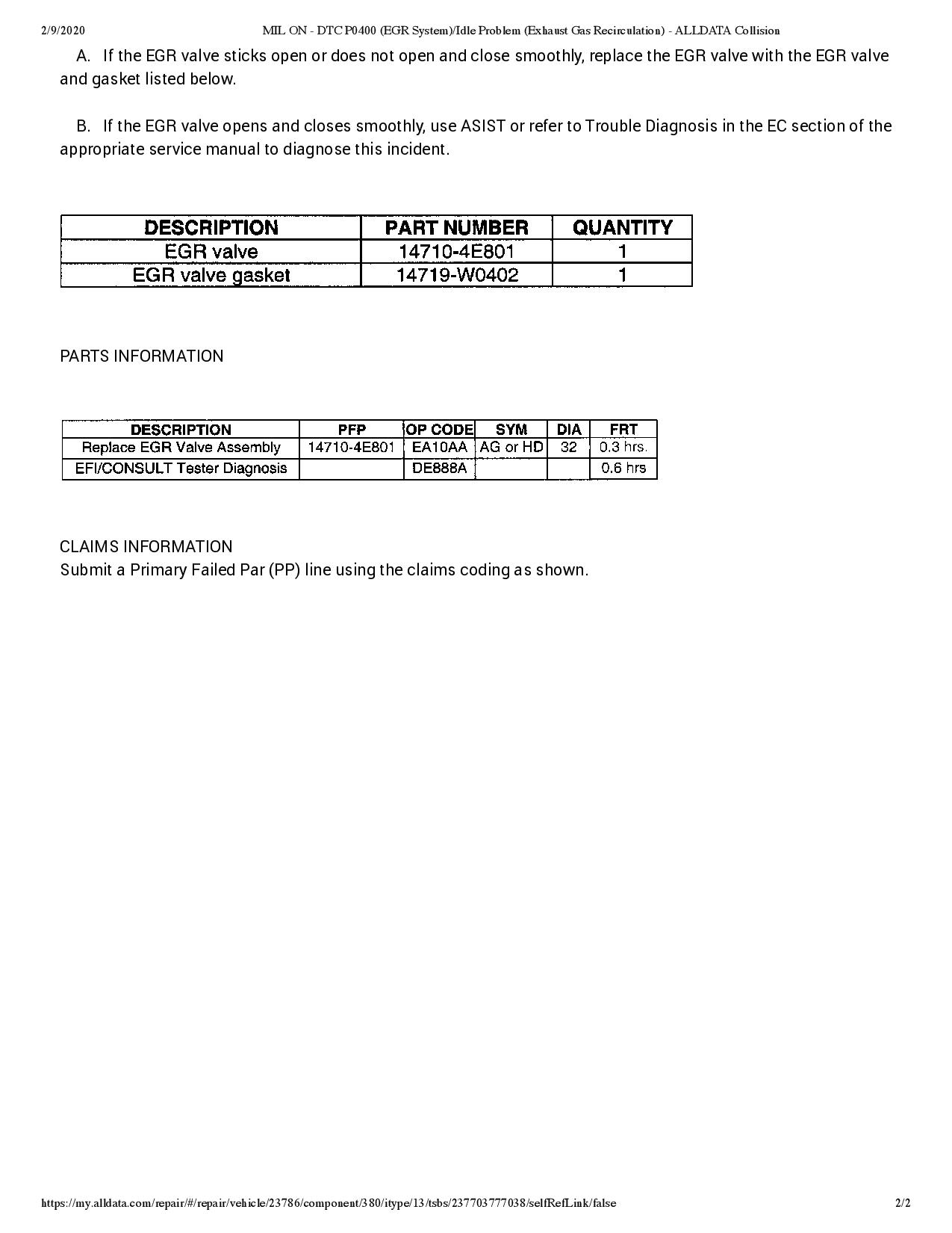

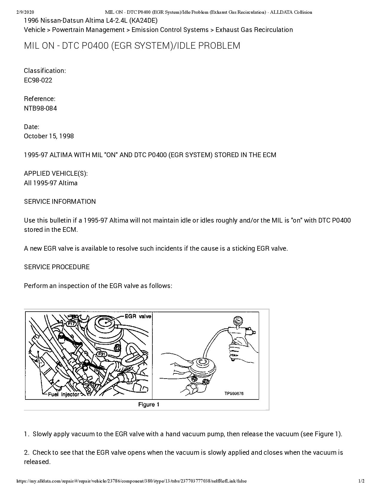

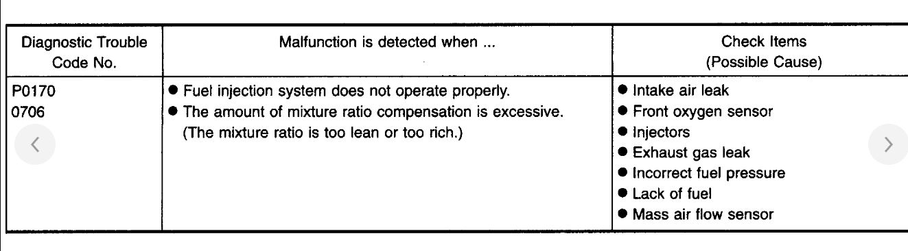

The 400 code is EGR related. The system needs to be checked to verify the failure. I posted the possibilities for you to view.

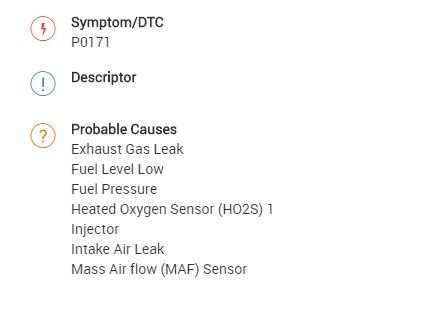

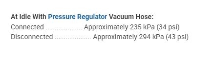

The 171 is for lean running. I would check and make sure there are no vacuum leaks. Beyond that, I would check the fuel pressure.
https://www.2carpros.com/articles/repair-lean-mixture-codes-p0171-or-p0174-on-some-manufacturers
NOTE:
When reconnecting fuel line, always use new clamps.
Make sure that clamp screw does not contact adjacent parts.
Use a torque driver to tighten clamps.

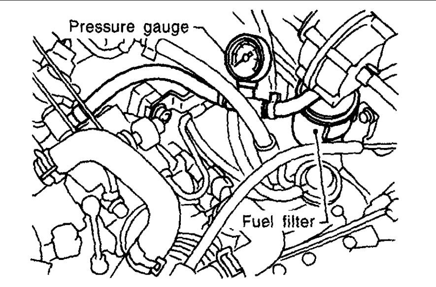

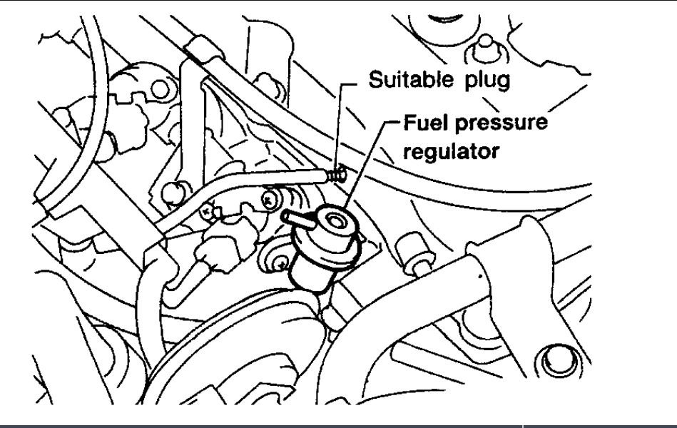

Use Pressure Gauge to check fuel pressure.
Do not perform fuel pressure check with system operating.
Fuel pressure gauge may indicate false readings.
1. Release fuel pressure to zero.
2. Disconnect fuel hose between fuel filter and fuel tube (engine side).
3. Install pressure gauge between fuel filter and fuel tube.
4. Start engine and check for fuel leakage.
5. Read the indication of fuel pressure gauge.

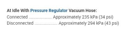

At idling:
With vacuum hose connected
Approximately 235 kPa (34 psi)
With vacuum hose disconnected
Approximately 294 kPa (43 psi)
If results are unsatisfactory, perform Fuel Pressure Regulator Check.
