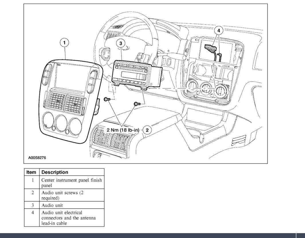

Good morning,
This video will help
https://youtu.be/jF_sDSS0n7I
2002-2006 are the same.
You will need to get the radio access code when you purchase the radio. If you do not and do not enter the code, the radio will not work.
Removal and Installation
1. NOTE: Make sure the ignition switch is in the off position.
Remove the center instrument panel finish panel.
2. Remove the 2 screws and the audio unit.
Disconnect the audio unit electrical connectors and the antenna lead-in cable.
To install, tighten to 2 Nm (18 lb-in).
3. To install, reverse the removal procedure.

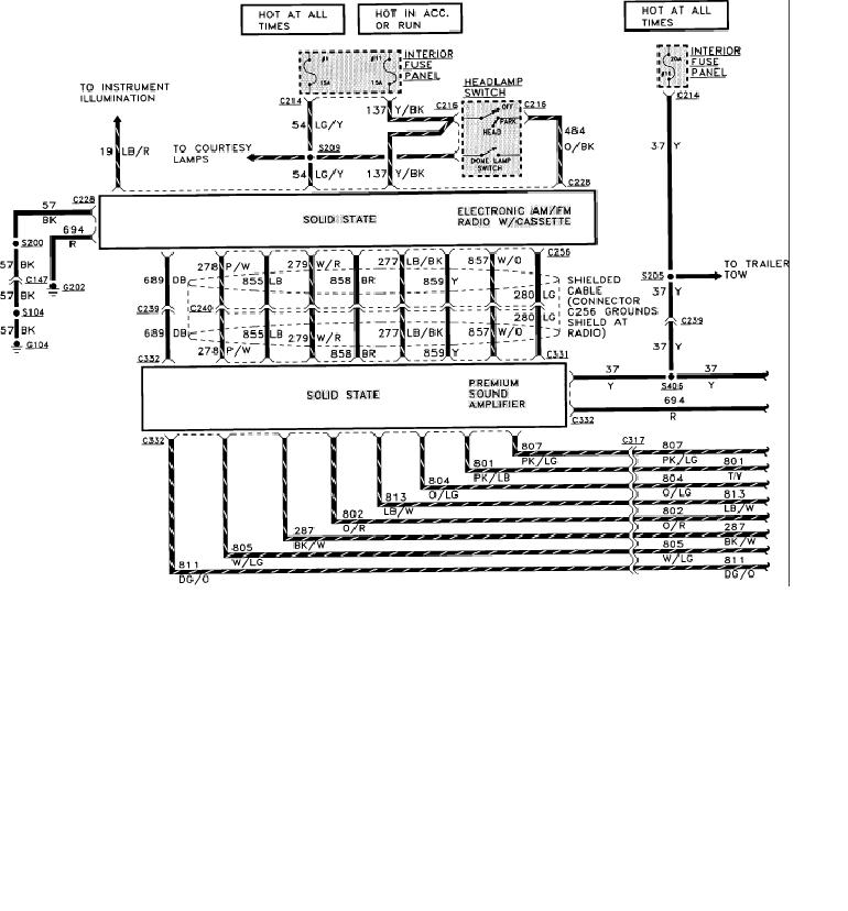

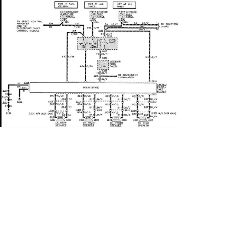

What do you mean, "the ignition is out"? The ignition is a system. When you hooked up a harness, are you referring to a replacement radio or something else?
Here is the radio wiring diagrams from AllData. The first one is for the standard radio. The second one is for the "Premium" radio with a remote amplifier.

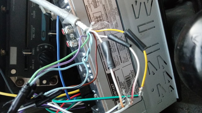

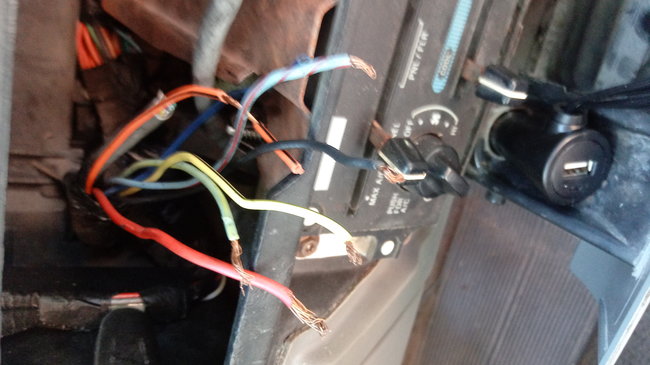

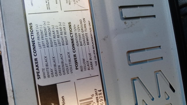

KADEN CLARK
  • 12 POSTS
Hey, I took some pictures of the wires and the radio. None of the wires have power now. Hopefully by seeing the pictures it would help you out helping me figure it out.
Nov 27, 2020 at 4:57 PM (Merged)

CARADIODOC
  • 34,306 POSTS
You are overlooking something very basic. You have to have 12 volts all the time on the light green/yellow wire, and there must be 12 volts on the yellow/black when the ignition switch is on. If the interior lights work, the light green/yellow circuit has to be okay. If you are finding 0 volts all over, check what you're using for ground for your meter or test light. On a lot of Ford products you will see a metal bar running along the bottom of the dash assembly, but that bar does not actually bolt to the body, so it cannot be used for any ground circuits.

  • 12 POSTS
The light green wire has power through it and works fine. Still struggling with the ignition/switched power I cannot seem to find a diagram for the inner fuse box but everything the ignition is connected to works, but the previous owner told me when he was messing with it. That wire has gotten red hot before. I do not know where that wire leads so I cannot really find if there is a fried part of the wire somewhere.

We often need to know the engine size to get the right wiring diagrams and parts lists, but not in this case.
Oh; that adds another dimension to this sad story. I used to tell my students it was not proper to run a new wire to solve a problem. The defect in the old wire must be found because whatever happened to it is likely to happen to the others in that harness. Common things are a harness fell down and was rubbing on the sharp edge of a metal bracket, it fell onto hot exhaust parts, or a screw got run through that harness. How long will it be before the same thing happens to the next wires in that harness, and where will your customer be on a dark Saturday night when he's broke down on the side of the road?
In this case we can assume the defect was caused by operator error, and while a hot wire will melt the insulation on adjacent wires, we are probably safe in assuming if no other damage has shown up in those other wires this far, they will likely be okay. This would be an appropriate time to run a new power wire for your radio.
The light green/yellow wire is for the radio's memory circuit so it is always live. My question is if the yellow/black switched power wire got red hot, why did the fuse not blow? That is just a 15-amp fuse. 15 amps will not turn that wire red hot.

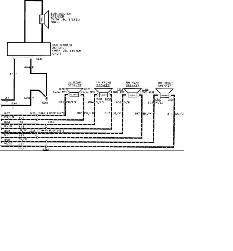

  • 12 POSTS
Hey, what wires coordinate with the speakers? I got everything resolved, but I got the speakers wires wrong. I tried the diagram but does not show which color.
CARADIODOC
  • 34,306 POSTS
Sorry that the diagrams reproduced too small to read.
Left front speaker is orange/light green and light blue/white.
Left rear is pink/light green and tan/yellow.
Right front is white/light green and dark green/orange.
Right rear is orange/red and black/white.
