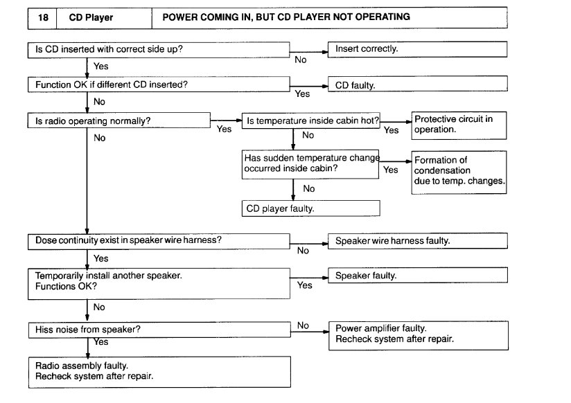

In the diagrams down below I have included a factory diagnostic troubleshooting flowchart for your vehicle's CD Player. Please go through this guide and get back to us with what you are able to find out.
