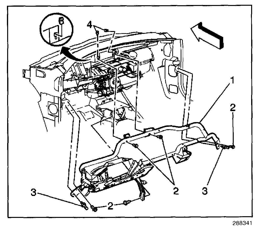

9. Remove the IP carrier.
pic 1
10. Disconnect the wiring harness from the cross vehicle beam (1).
11. Remove the attaching bolts from the right and left side of the HVAC module.
12. Remove the bolts (2) from the cross vehicle beam.
IMPORTANT: Place the steering column in the straight tilt position using the tilt lever.
13. Remove the cross vehicle beam (1) from the front of the vehicle.

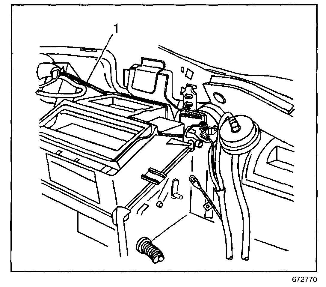

14. Remove the floor air outlet.
15. Disconnect the wiring harness from the HVAC module assembly.
16. Disconnect the electrical connections at the following locations:
^ The blower motor
^ The blower resistor
pic 2

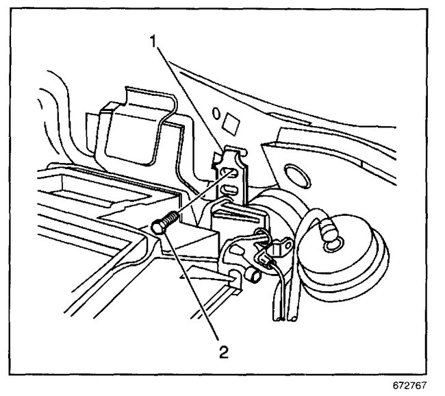

17. Remove the HVAC module attaching bolts near the heater hoses and the A/C evaporator lines.
Remove the HVAC module assembly screw (2) from the mounting bracket (1).
pic 3
18. Disconnect the gray source vacuum line (1).
IMPORTANT: Do NOT tilt the HVAC module assembly, or coolant may leak out.
19. Remove the module from the vehicle.

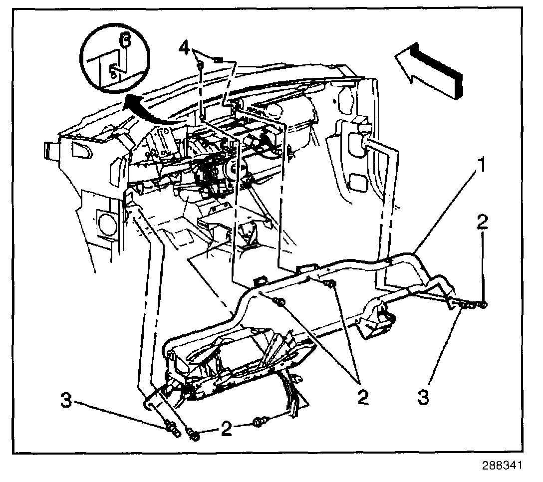

INSTALLATION PROCEDURE
pic 4
1. Install the HVAC module assembly. Align the mounting bracket (1) to the hole. Install the screw (2) to the mounting bracket.
Tighten
Tighten the bolt to 2 N.m (18 lb in).
2. Install the HVAC module attaching bolts near the heater hoses and the A/C evaporator lines.
Tighten
Tighten the bolts to 2 N.m (18 lb in).

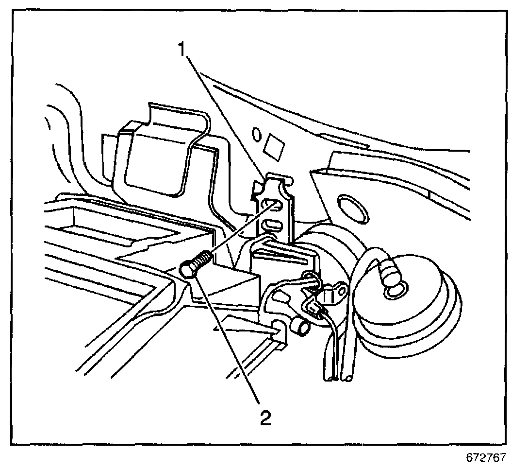

pic 5
3. Connect the gray vacuum line (1).
4. Connect the electrical connections at the following locations:
^ The blower motor
^ The blower resistors
5. Connect the wiring harness to the HVAC module assembly.
6. Install the floor air outlet.
