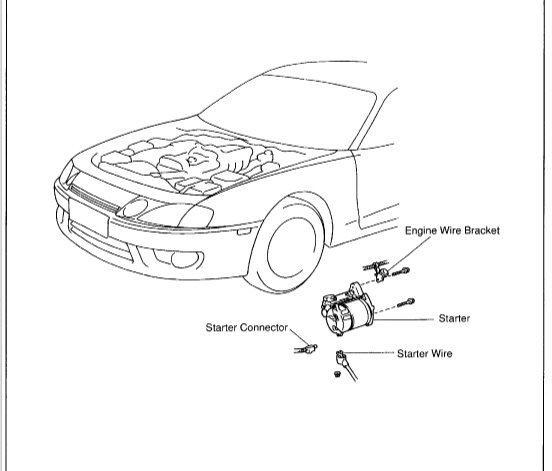

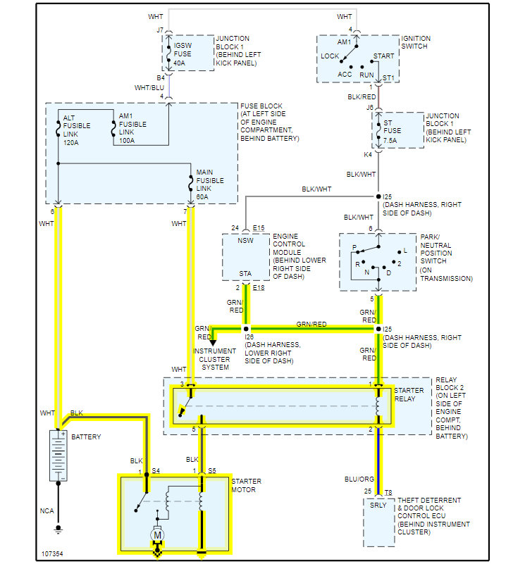

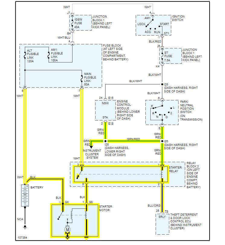

Good morning,
I attached the wiring diagram for you of the starter motor. I also attached the procedure for removing the starter as well.
Make sure you test all the fuses in the diagram as well.

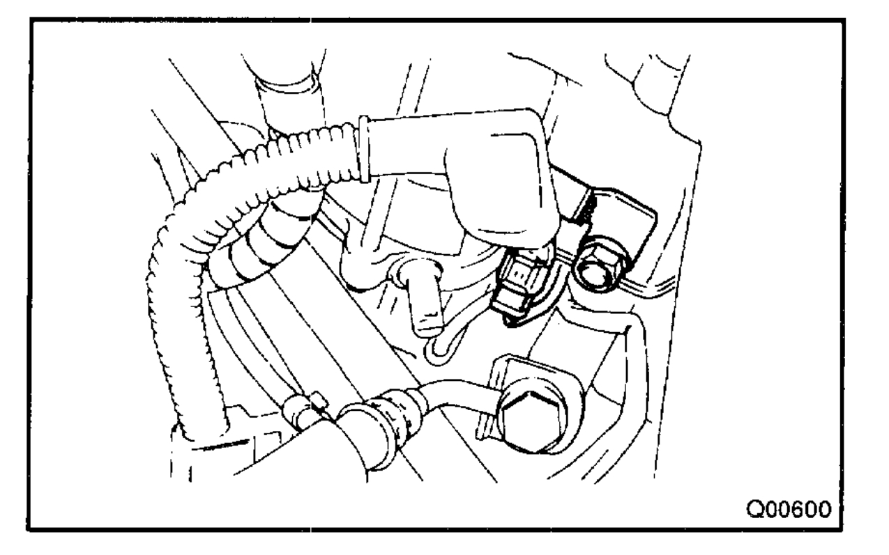

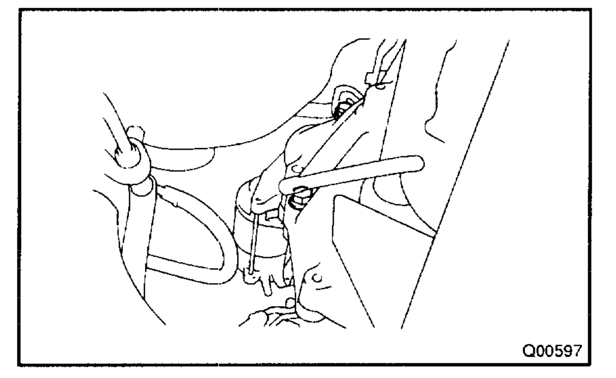

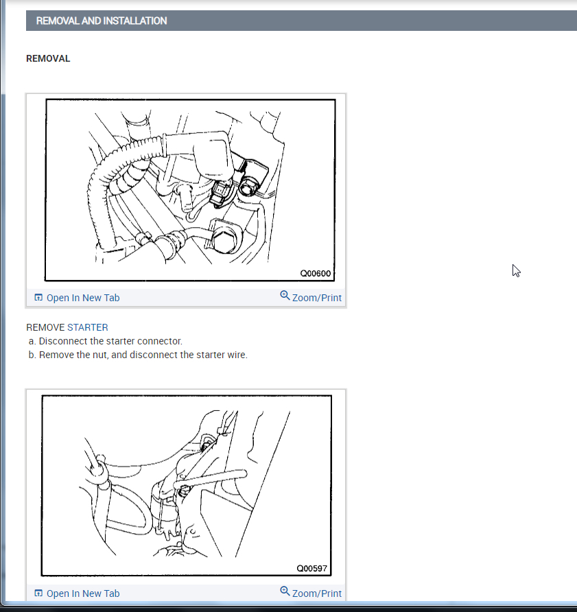

REMOVAL
REMOVE STARTER
a. Disconnect the starter connector.
b. Remove the nut, and disconnect the starter wire.
c. Remove the 2 bolts and starter.
Torque: 37 Nm (380 kg.cm, 27 ft.lb)
