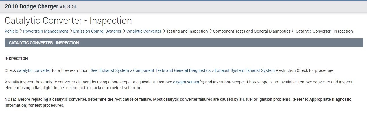

Hi, I'm Dan.
That sound is louder than normal in my opinion but sounds exactly like the catalytic converter shields when they are cooling off. I've attached the inspection procedure and a link to catalytic converter symptoms to see if that can help you.
https://www.2carpros.com/articles/bad-catalytic-converter-symptoms
