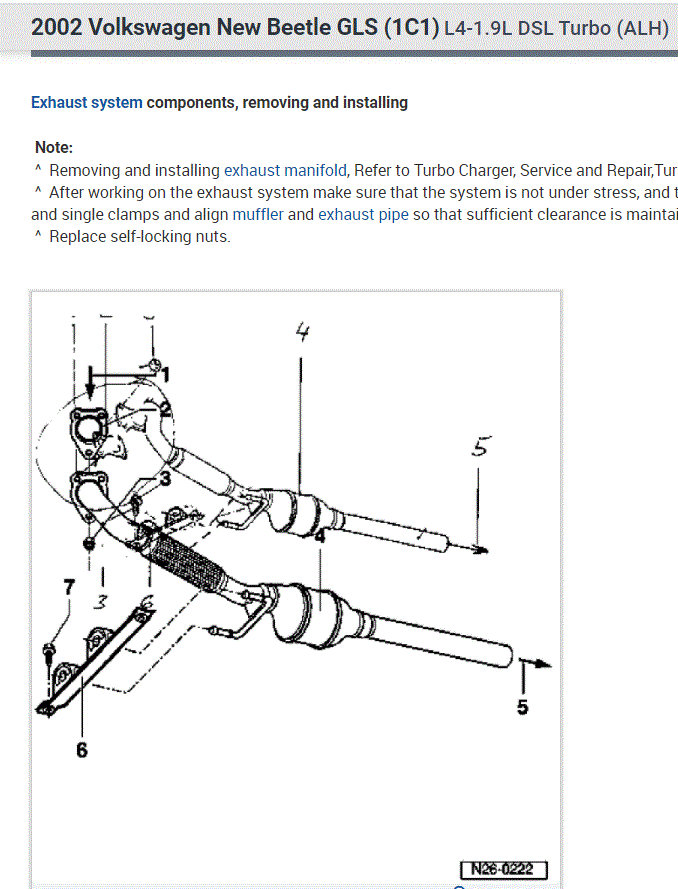

On the 1.9L diesel, there is one. It is located under the vehicle and is part of the exhaust system.

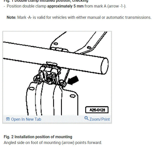

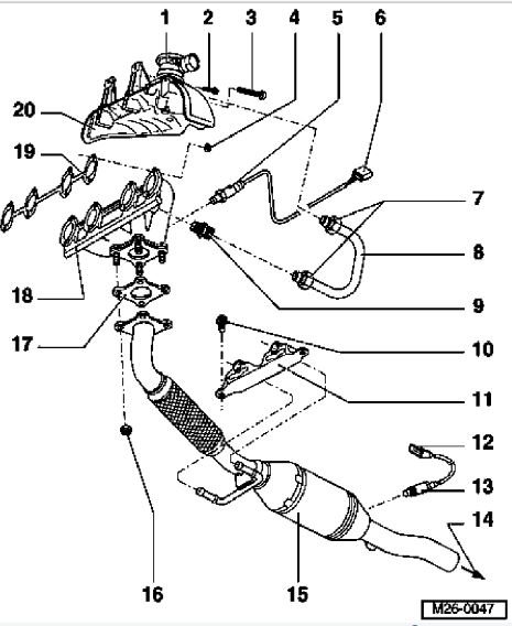

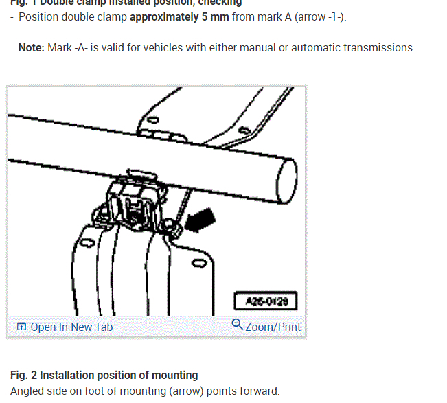

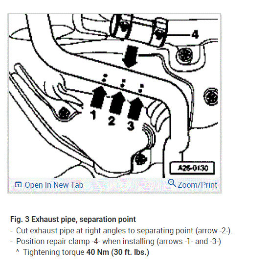

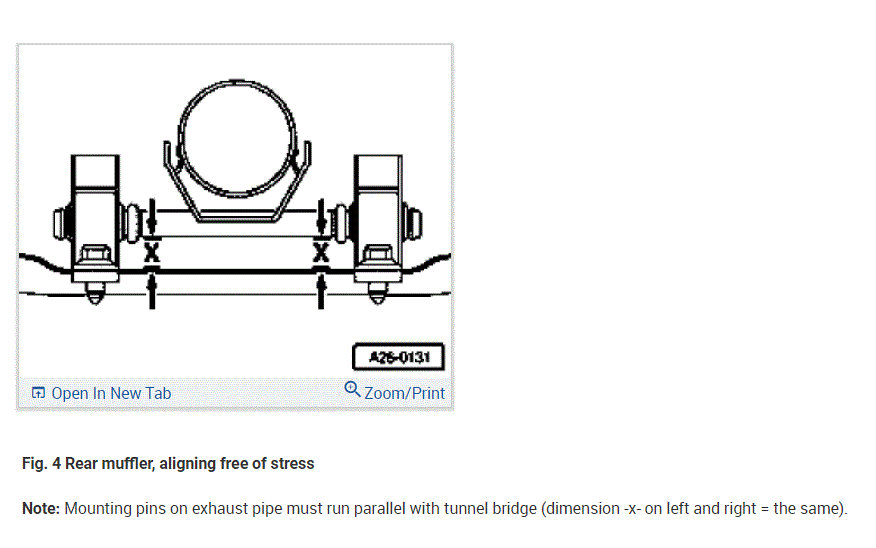

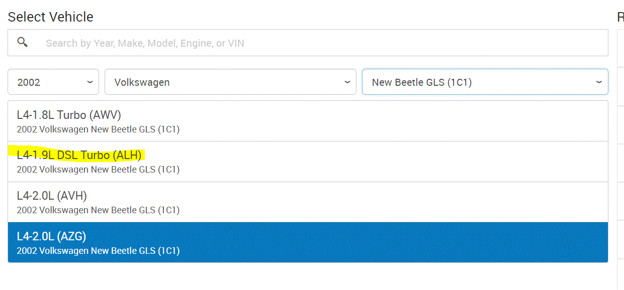

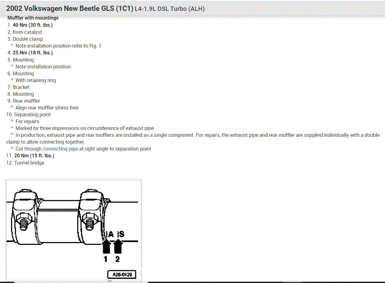

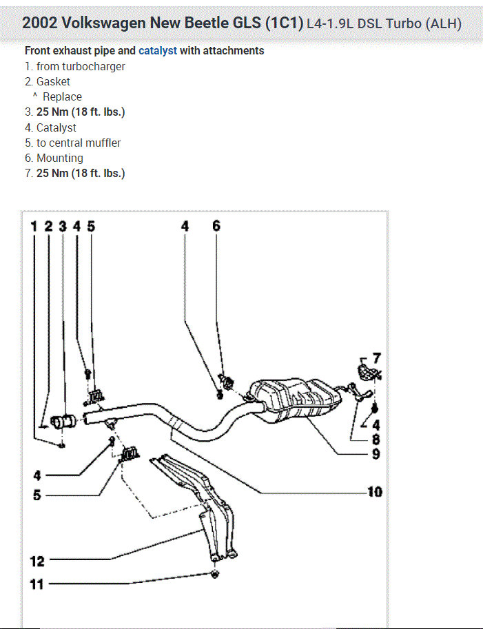

If you look at the attachments below, they include the directions for replacement and pics specific to your vehicle.
I hope this helps. Let me know if you have other questions.
See pics below. Note: The directions below are for all components on the exhaust system. I'm adding them in the event they are needed.
