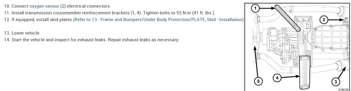

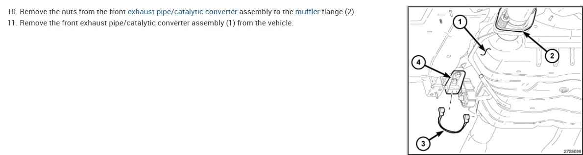

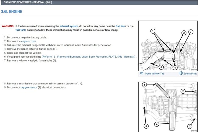

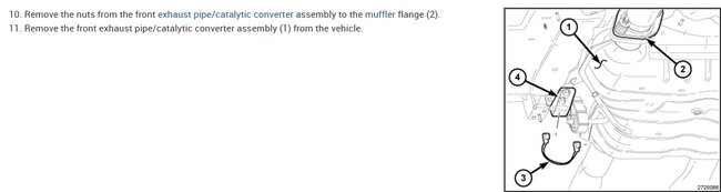

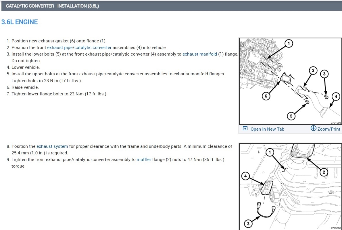

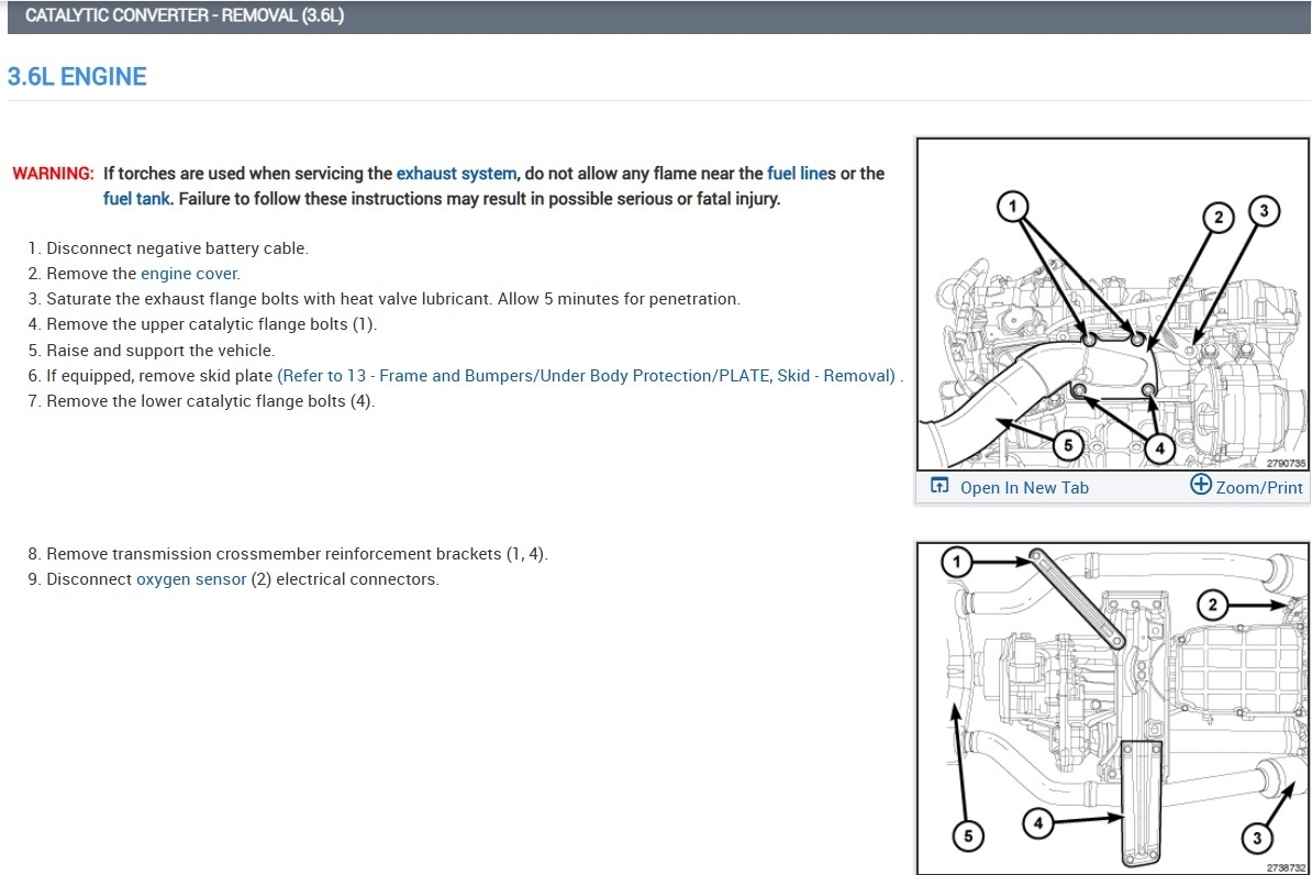

Heres the removal and installation on the Catalytic Converters, if you happen to be working on the ground replacing these, make sure to have extra jack stands to give additional support. Let us know how the repairs go.
