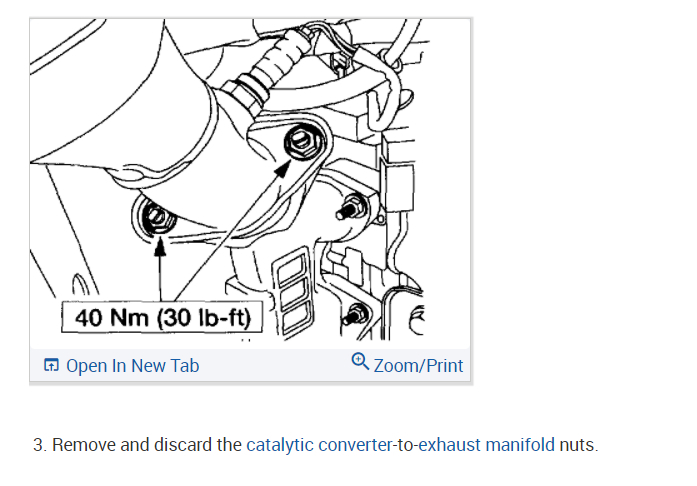

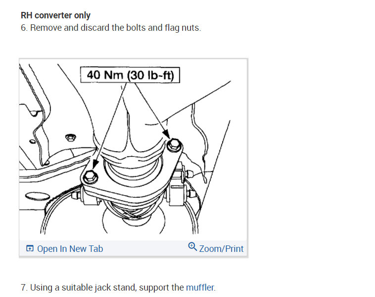

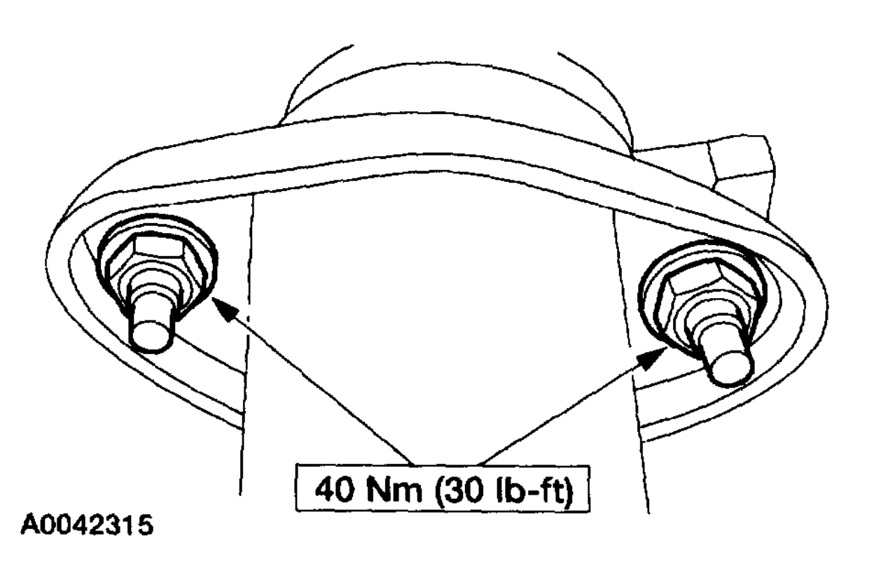

I would unbolt the front pipe from the exhaust manifold. on both sides. If the converters are clogged, the engine cannot breathe and will not start.

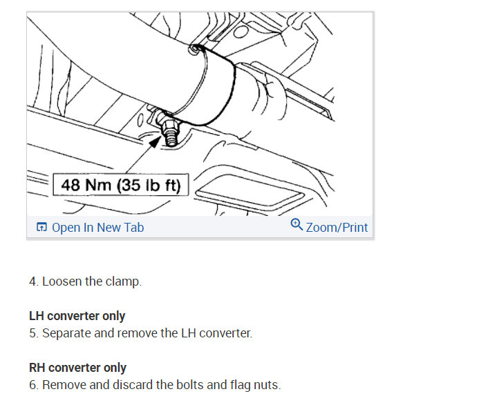

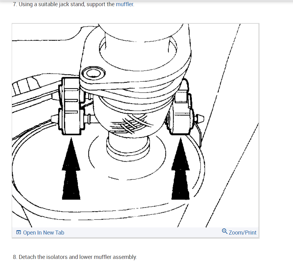

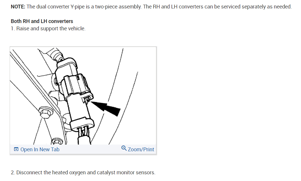

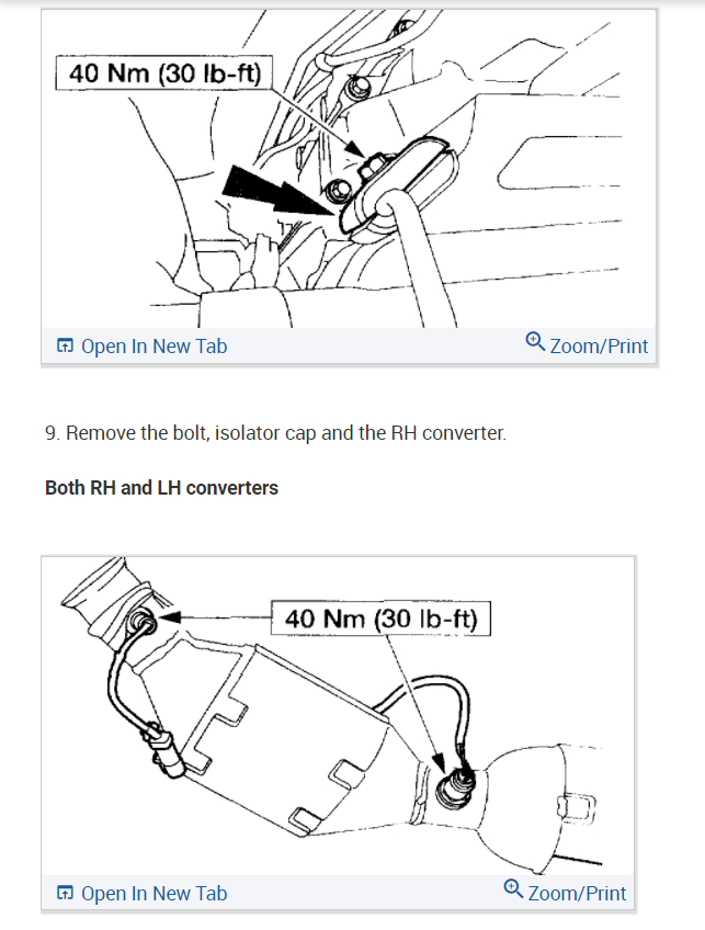

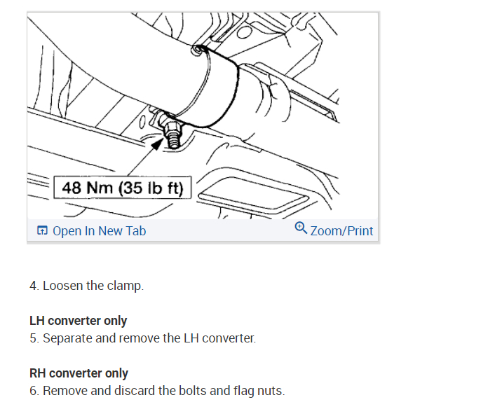

I attached a picture for you to view of where you remove the bolts for both side. Once the pipe is released, see if the truck starts. If it does, the converters need to be replaced.
I attached some other possibilities for you for it not to start below.
