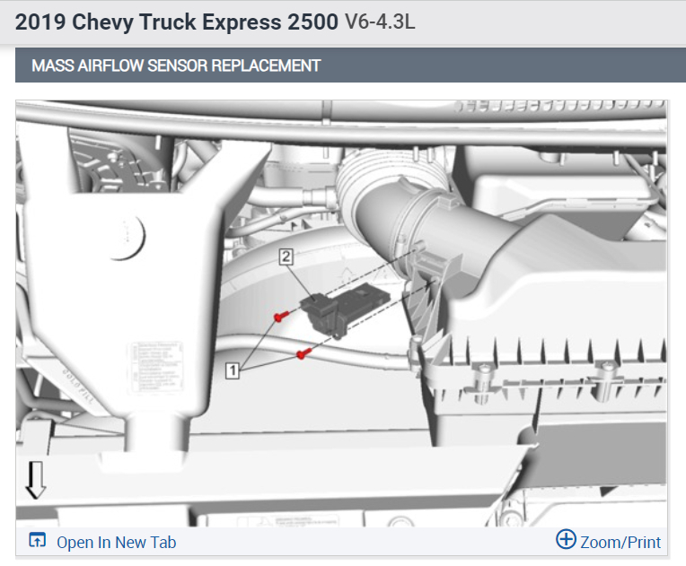

Yep, first the whistling noise sounds like the old catalytic converter material is stuck the muffler, the second problem is the aftermarket cats, they are cheap and don't work well and the computer can tell. Also, the MAF sensor can cause an issue with the air/fuel mixture which may overload the cats. I would get an OEM MAF and cat system to fix the problem. Sorry I know this can be expensive, but this is why factory parts can work better. Here is how to do the job correctly so you can see what needs to be done or if you want to try the repair yourself.
This video will show you how:
https://youtu.be/CORe9JyrexI?si=VZ-lff0mIUXmTmuP

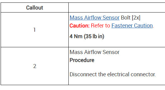

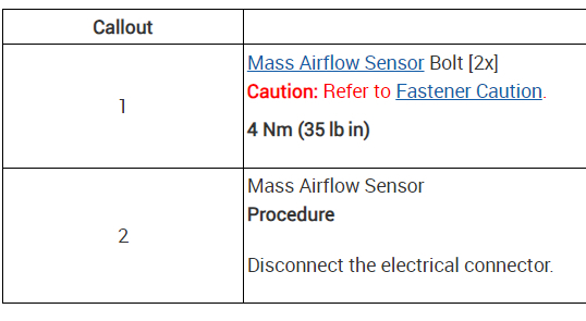

here is the MAF sensor replacement. Check out the images (below). Please let us know what happens.
