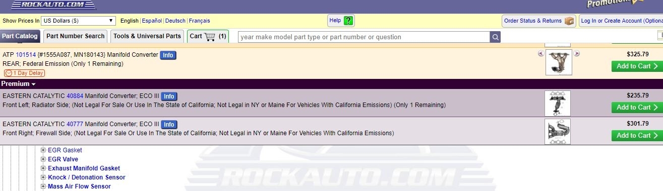

You have two catalytic converter. One on each exhaust manifold. One is in the front and one in the rear.
I attached a link to rock auto who has them but lists them as left and right.

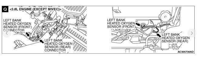

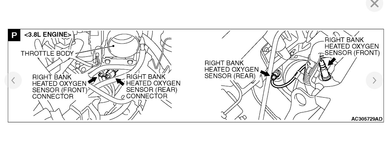

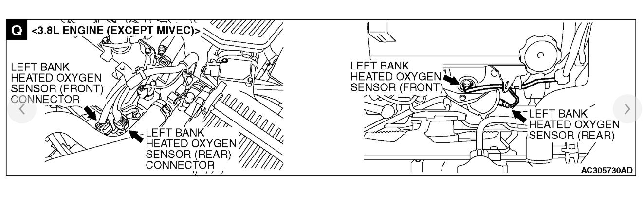

Secondly, I want to know which one is bank 1 and 2 is bank one the one close to the radiator? and in total how many 02 sensors does the car have?
Thank you so much.
Jul 17, 2019 at 8:02 AM
The firewall side is bank 1.
You should have 4 sensors. 2 upstream and 2 downstream.

Good Afternoon Roy,
Thank you for everything i saw the images but it said "non mivec" does it change anything because my engine is mivec.

You are welcome.
No, I live in central PA. I do not have any connections with that area, sorry.
Does not make a difference.
