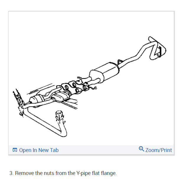

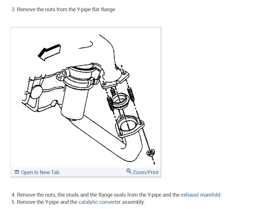

Good morning,
The first thing I would do is check the compression. Make sure you have 140-160 pounds. Low compression will cause this.

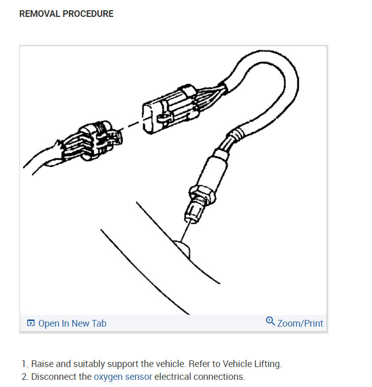

Before you go to the converters, disconnect the head pipe on both sides and see if it starts. If it does, the catalytic converters are clogged and the engine cannot breathe. I attached pictures of the removal of the catalytic converters for you below.
https://www.2carpros.com/articles/catalytic-converter-replacement

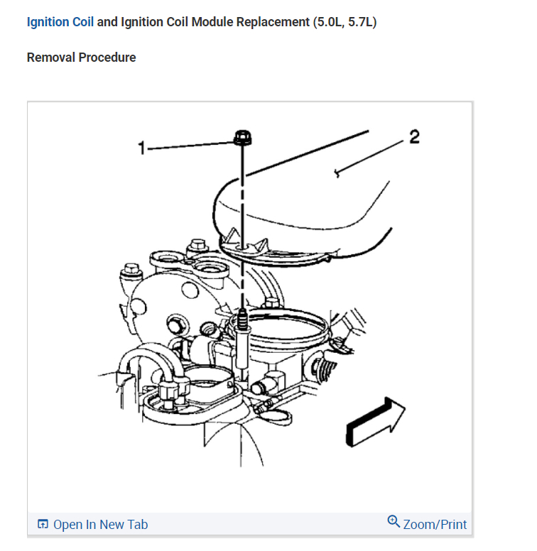

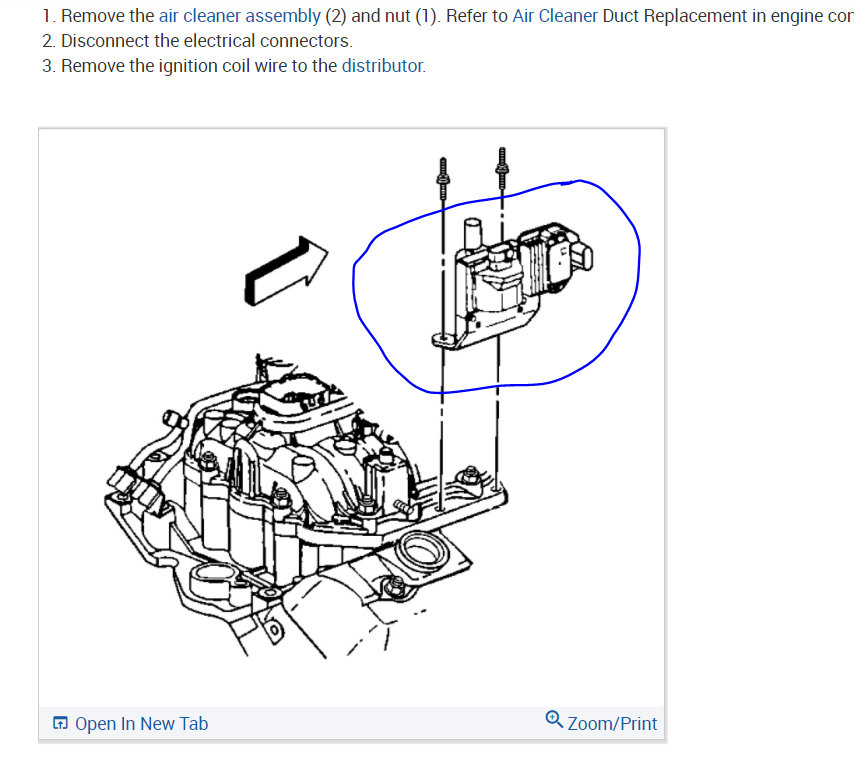

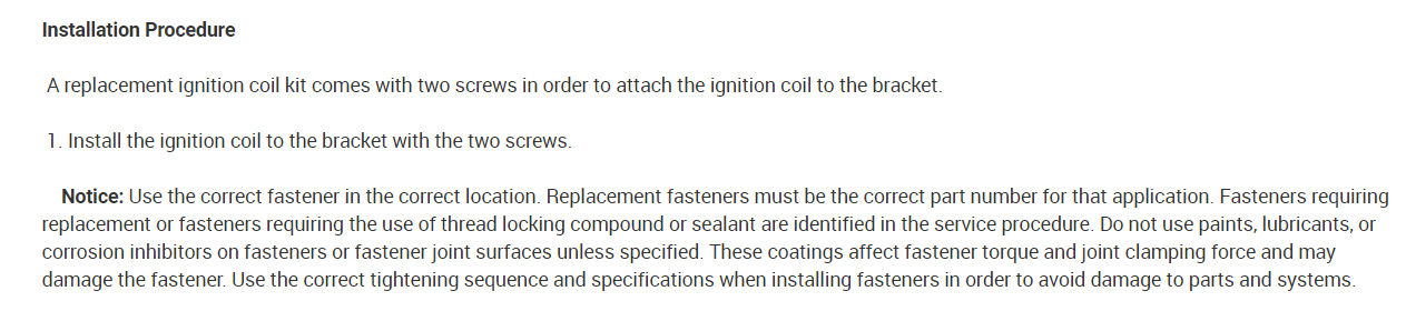

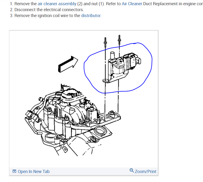

Also, I saw nothing about the ignition module. That is what controls the spark to the plugs. That would be something I would replace. I attached the procedure below for you.
Jun 13, 2021 at 4:04 AM

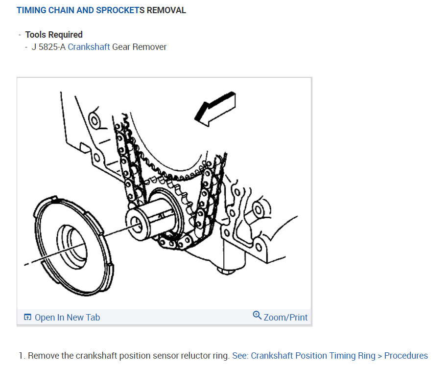

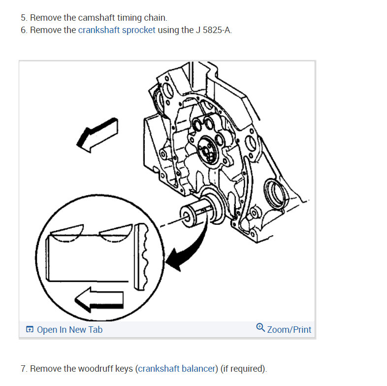

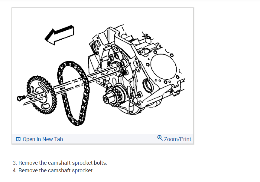

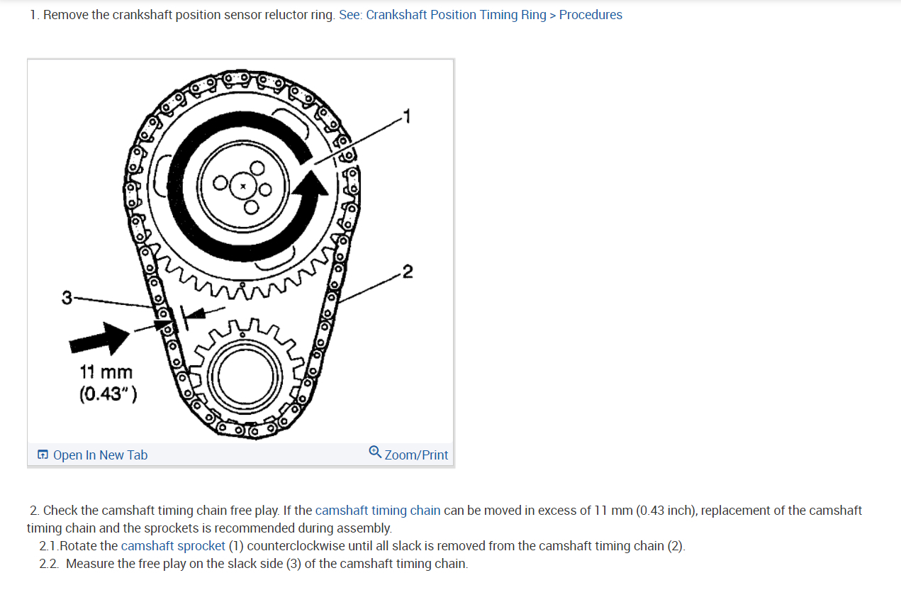

You are welcome.

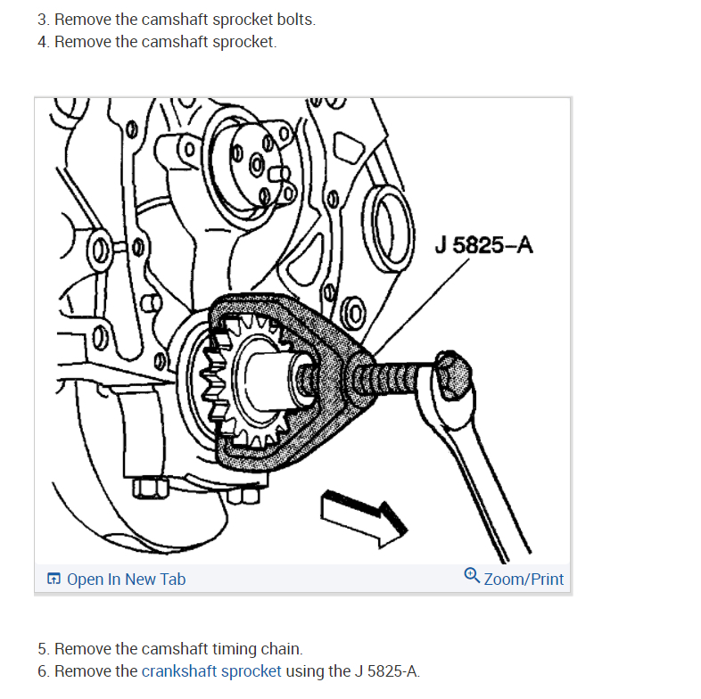

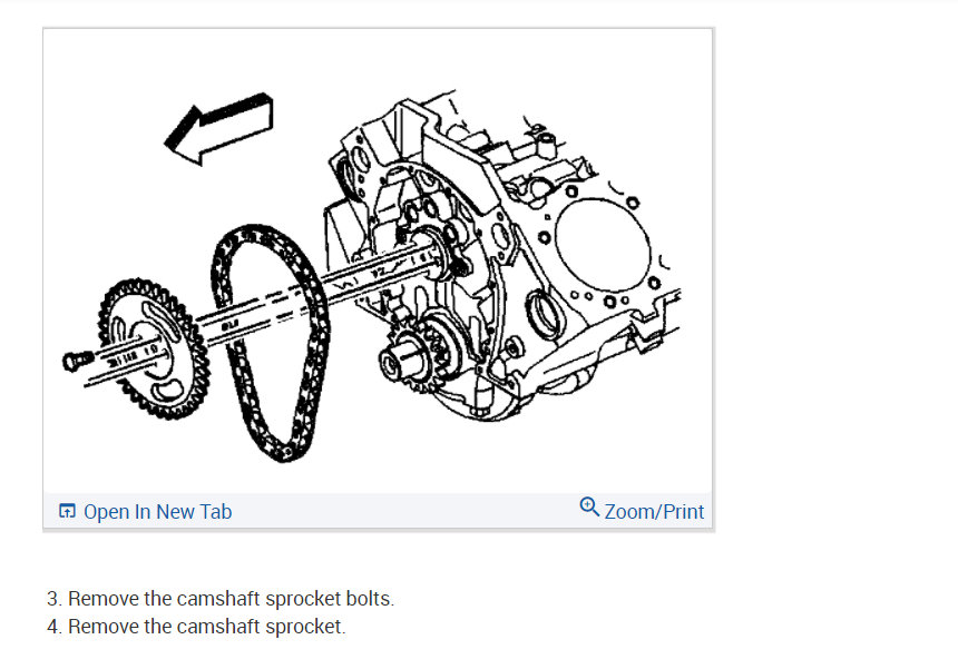

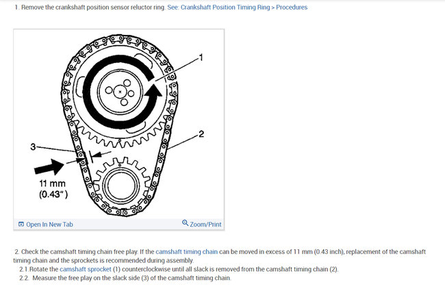

185,000 is beyond the recommended time to change it. 150,000 is when it is recommended. They put the cheap set when they made the motor.
When you replace it, I would use a double roller chainset. The original is not a double roller. The double roller became the standard around 2000. There was no recommended tie for changing that. They just state to replace it at the engine overhaul.
Jun 14, 2021 at 4:25 PM
