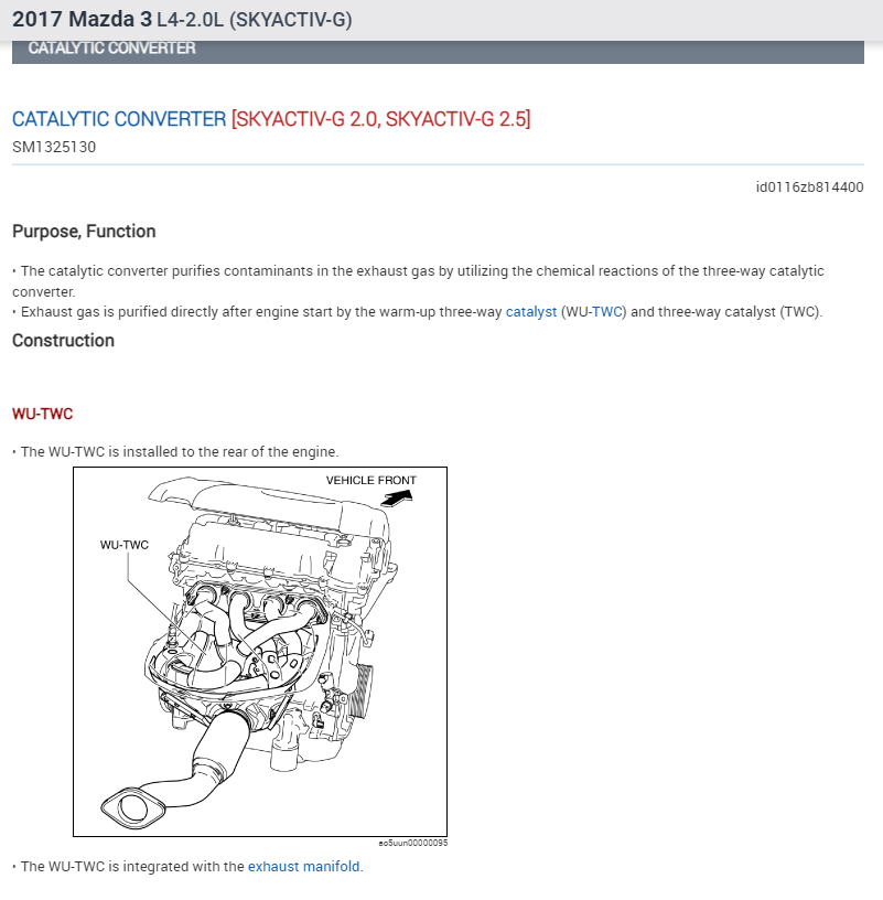

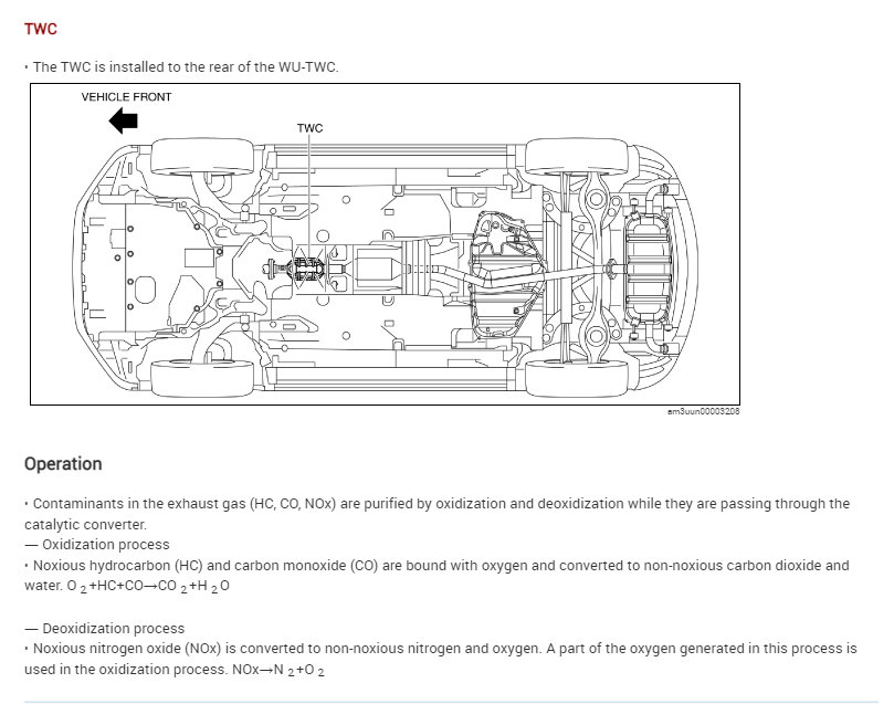

The wu-twc is hollowed and twc is removed in my car
How can i fix the wu-twc for the metallic sound! (which is expensive)
Should i put twc again or no difference?
A mechanic suggested to open wu-twc and put a pipe in it and fibers he said it will fix it. is it true?
