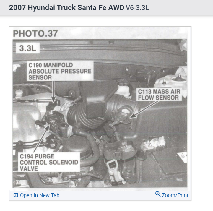

I assume the oxygen sensor codes are for sensor rich. This will make the cat overload and trigger a cat efficiency code. Have you checked the air filter if it is clogged it will cause this issue? If the MAF sensor is off will cause this issue also if you have injectors that are starting to go bad because they don't atomize the fuel correctly. Also, if you have the code numbers it will help. Here is the location of the MAF sensor so you can check it out and replace it if necessary. Check out the diagrams (below). Please let us know what you find. We are interested to see what it is.

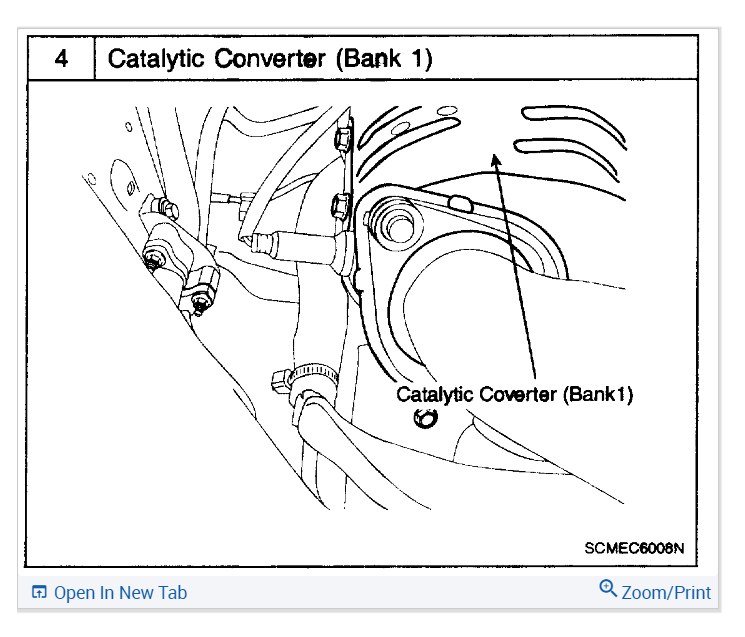

Question: what's the best way to get the bank 1 CAT on the firewall side out? Not a whole lot of room or access from the bottom. I'm assuming from the top is easier after removing the intake manifold? Shows 8 bolts and nuts holding the CAT on, how do I get to the bolts without hurting myself?

First make sure the engine is cold and spray WD40 on the bolts/nuts. Have jackstands under the car. Here is a generic guide that can help walk you through the steps with an image below.

Thanks for the info, however the CAT I'm replacing is the one that mounts directly on the engine manifold on the firewall side and comes down vertical. Very little space to get to. But I managed! Removed the intake manifold and got to unbolt it from the exhaust manifold from the top. I pulled the entire CAT upward and out.
