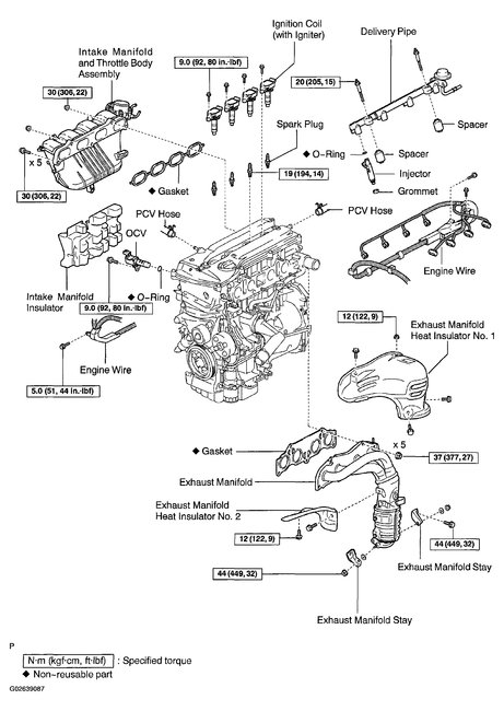

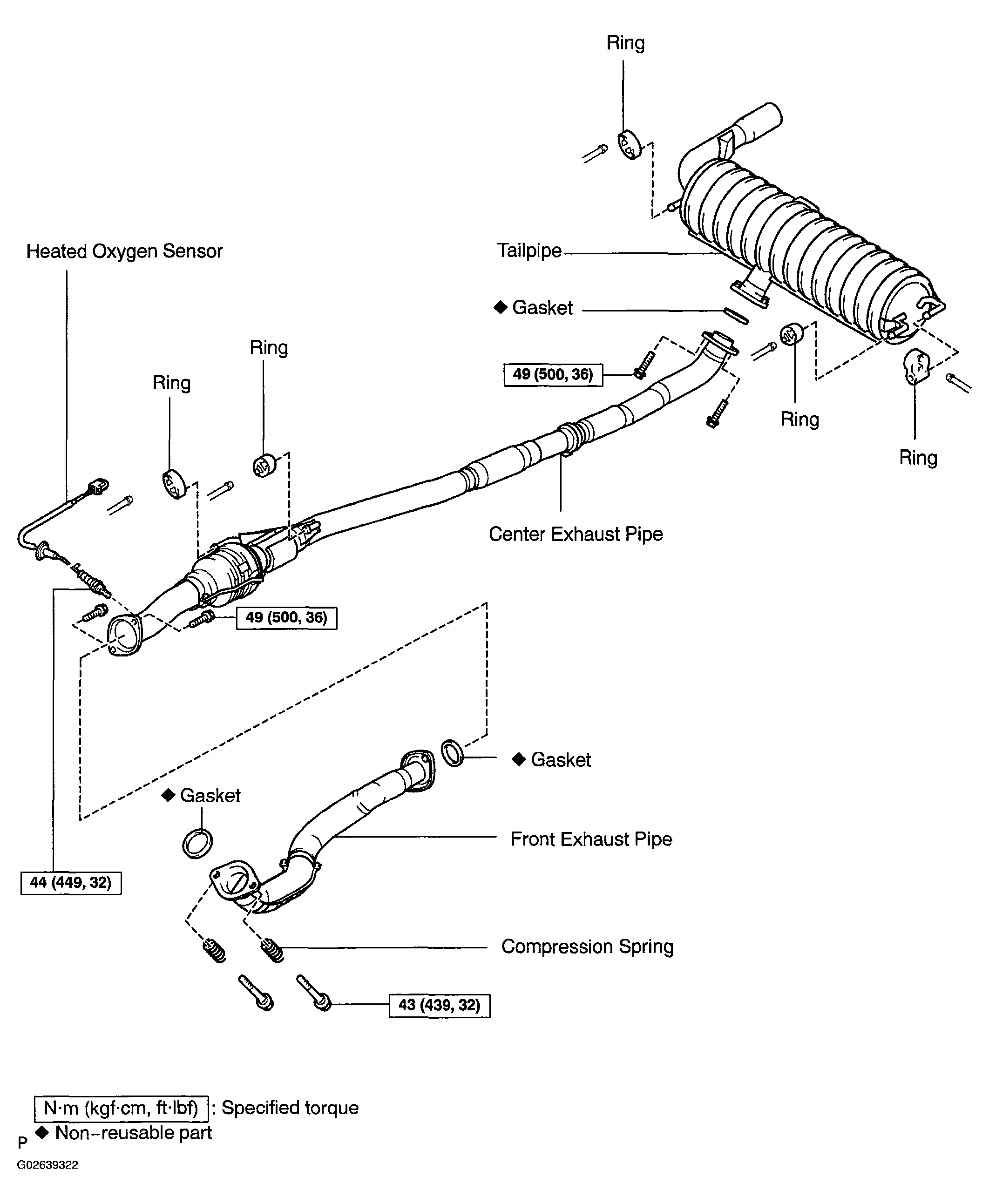

As to the two different convertors, Check your car as it should have come from the factory with both of those on it. The front one is the primary cat, and mounts on the engine the one under the car is the secondary cat. The front one is monitored by the PCM, the rear isn't.
Imagee 1 shows the under-car piping. Note the single O2 sensor in front of the CAT. That is B1 S2. B1 S1 is in front of the catifold. See second image.
