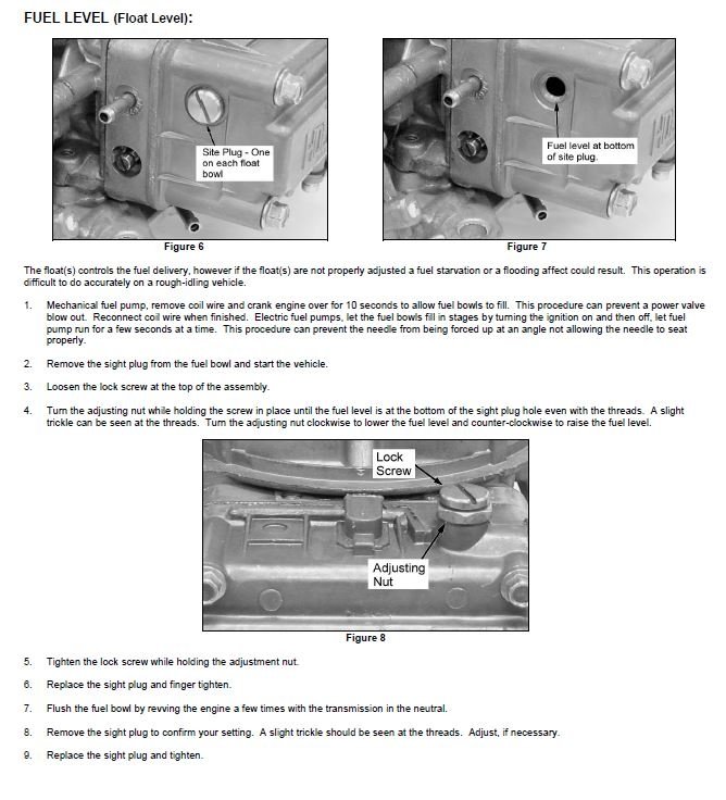

You might want to try adjusting the floats. I know you have to be careful when turning the screwdriver to loosen the float bolts because there is a gasket there, so I will get the instructions because it is important because if it is not done right after adjusting the float levels, it will leak gas from that bolt gasket.
I will be right back.
Here it is.
