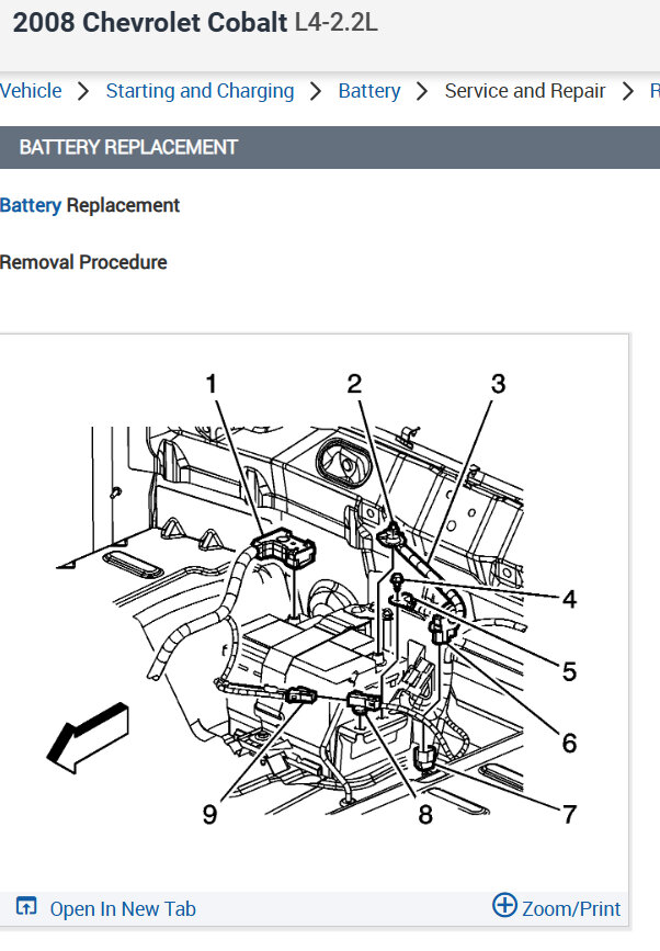

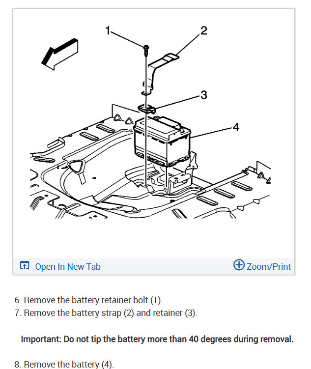

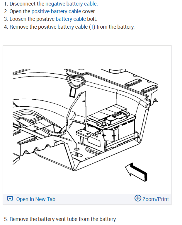

It can be a bad connection at the battery, also can you use a voltmeter to see what the standing voltage is at the battery, I have seen new batteries be defective FYI.
Please go over these two guides:
and
Please go over these guides and get back to us.
