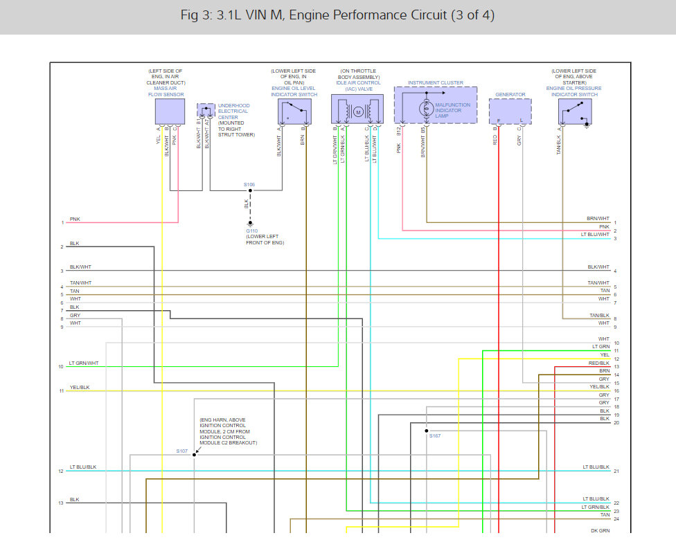

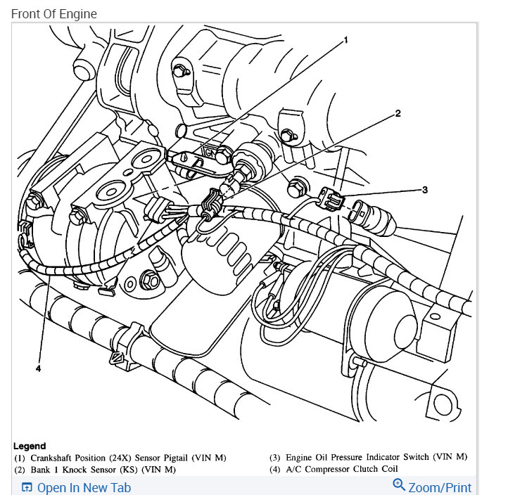

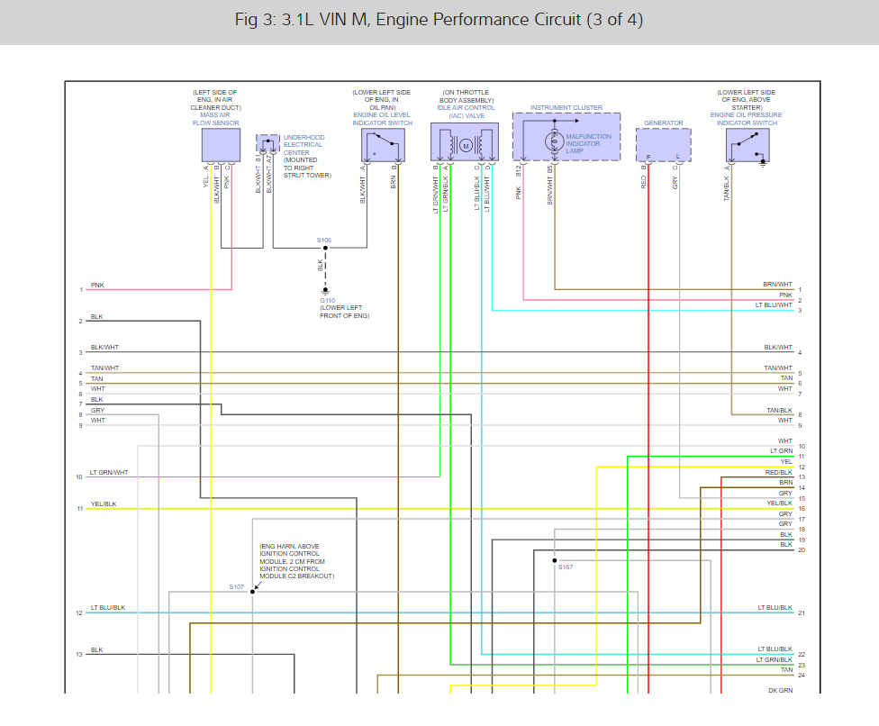

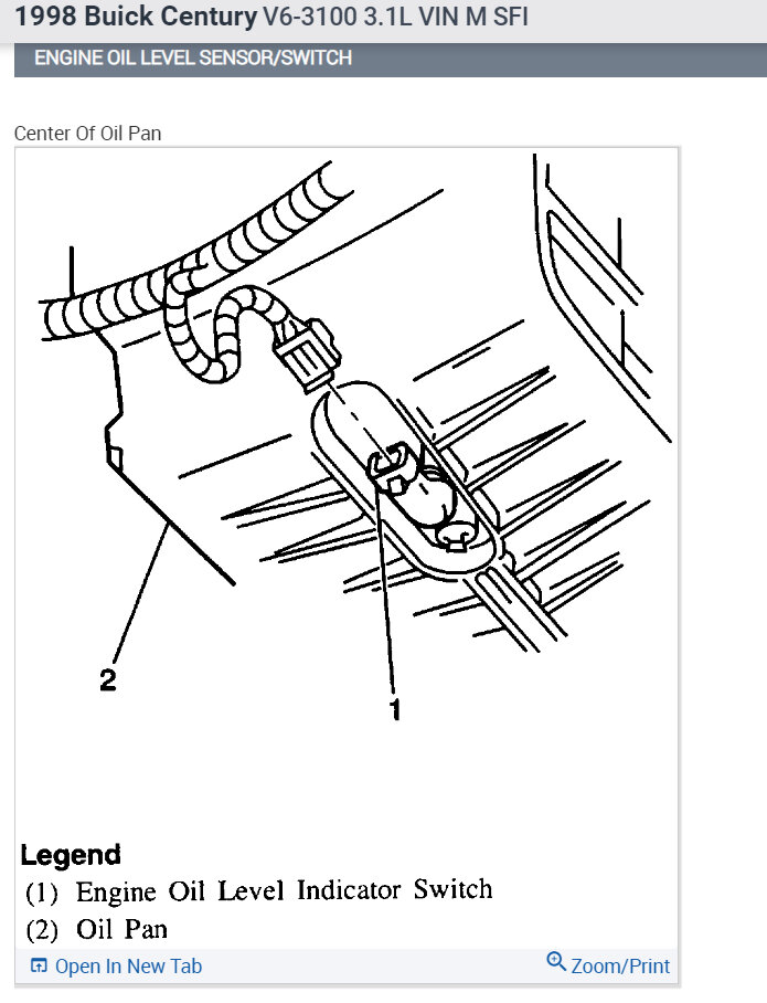

So, these engines have two safety devices that can go bad, you can try to bypass them to see if it solves the problem. the first is an oil pressure indicator cutoff switch and the other is an oil level sensor. If these sensors go out, they tell the PCM to stop the engine. Here is the location of the sensors and the wiring diagrams for them as well in the images below. Check out the images (below). Please let us know what you find. We are interested to see what it is.
