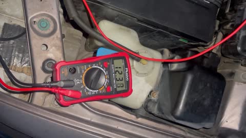

I just recently replaced my alternator and now my car won't start. I've confirmed that the battery is good, it's also brand new. I used a voltmeter to confirm the volts were around 12.6. I also know that the alternator is good, since I just replaced it.

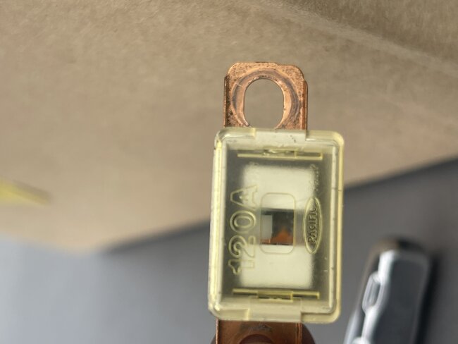

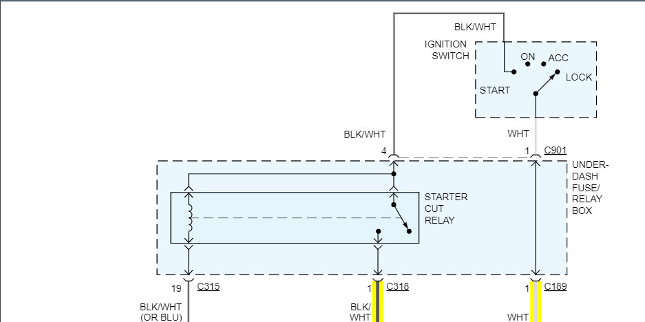

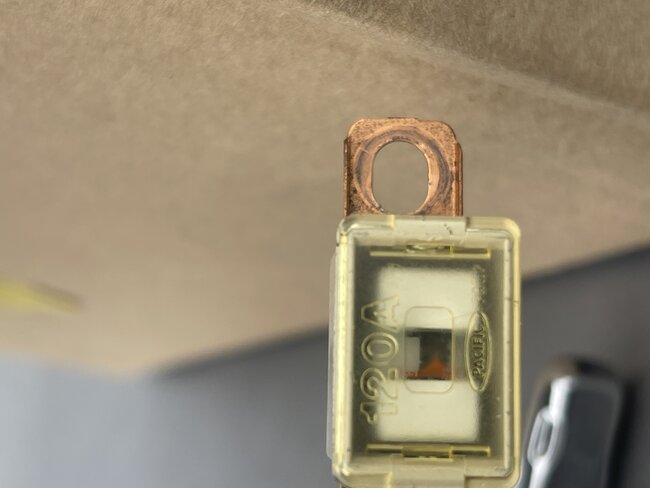

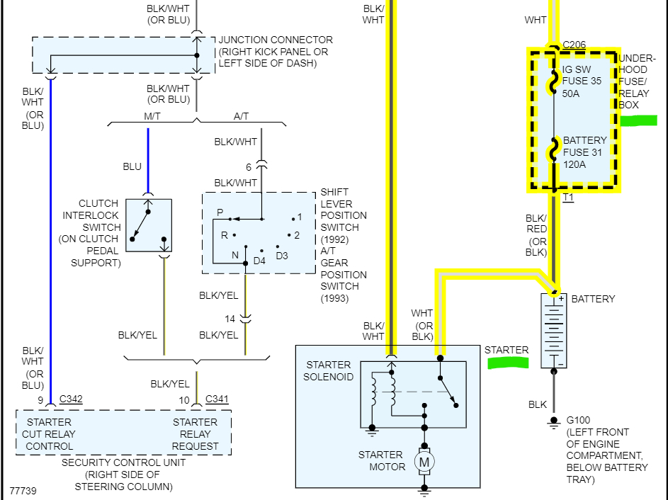

I checked the fuel pump fuse and a fuse labeled starter fuse. Both of those were good, I also confirmed that the main relay switch board was in good condition. When I turn the key, I have all of my electronics/lights, but I get no cranking at all. Not even an attempt to crank, I do hear a click which I believe is the relay.
From my research everything points to the starter. But the starter is in a difficult position. So, I was wondering if spark plugs, or coils would cause this issue? Before I go through the hassle of replacing the starter.
