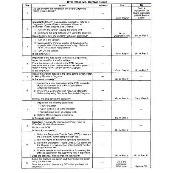

Good afternoon,
Just as Steve suggested, it sounds like a connection somewhere from the repair.
Below is an explanation of the code for you to view.

Test Description
The numbers below refer to the step numbers on the diagnostic table.
2. Command both the ON and the OFF states. Repeat the commands as necessary.
8. If you do not find trouble in the control circuit or the connection at the PCM, the PCM may be faulty. However, this is an extremely unlikely failure.
