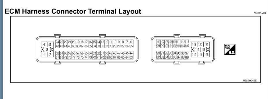

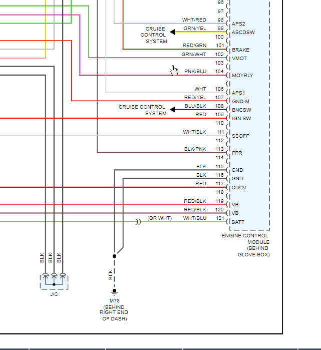

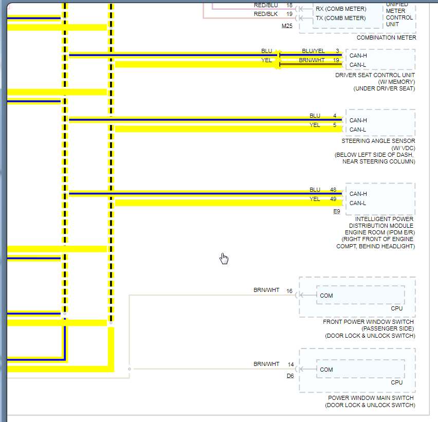

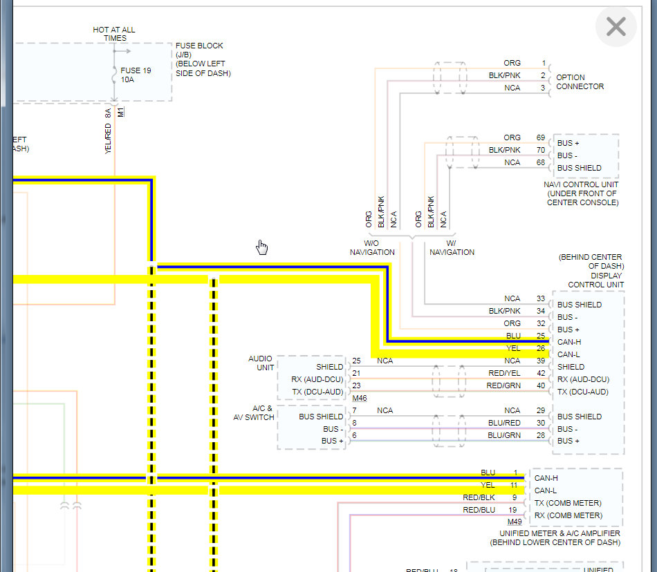

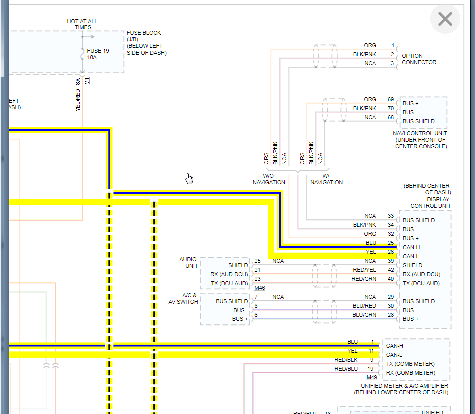

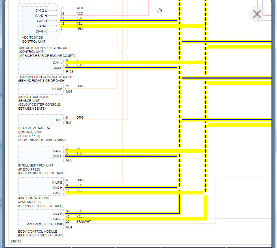

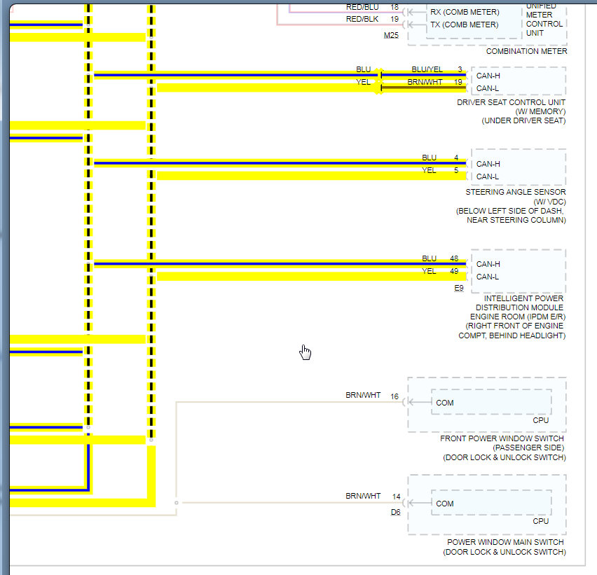

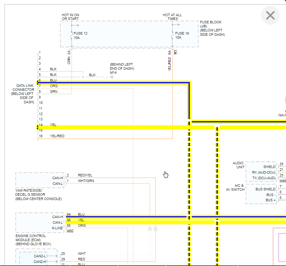

Based on the code, it isn't related to the parts but rather the CAN bus. The modules are unable to communicate with each other. Take a look through this and let me know if it helps. Also, the attached pic correlates with the directions.

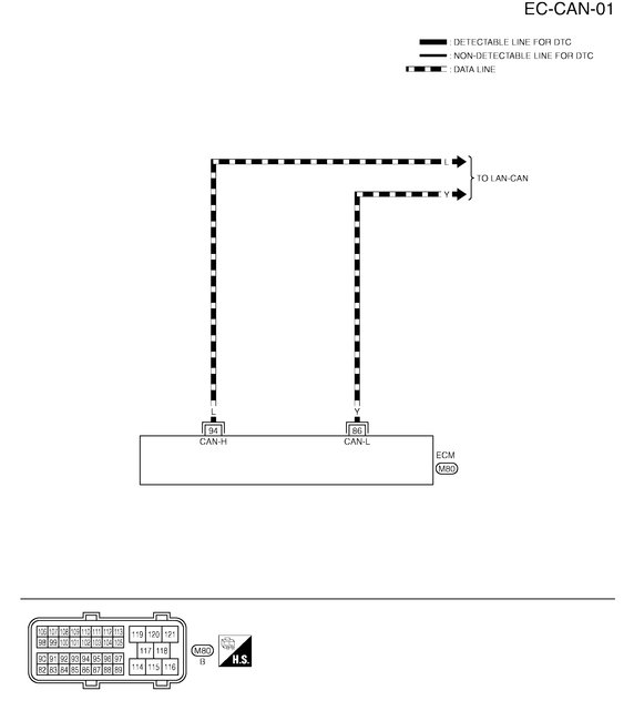

CAN (Controller Area Network) is a serial communication line for real time application. It is an on-vehicle multiplex communication line with high data communication speed and excellent error detection ability. Many electronic control units are equipped onto a vehicle, and each control unit shares information and links with other control units during operation (not independent). In CAN communication, control units are connected with 2 communication lines (CAN H line, CAN L line) allowing a high rate of information transmission with less wiring. Each control unit transmits/receives data but selectively reads required data only.
pic 1

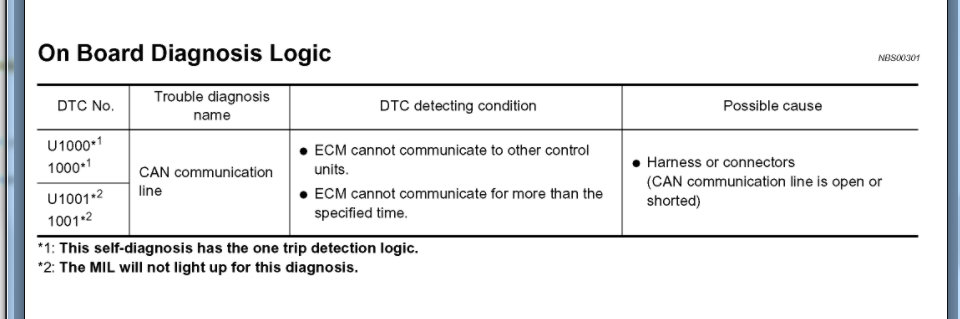

On Board Diagnosis Logic

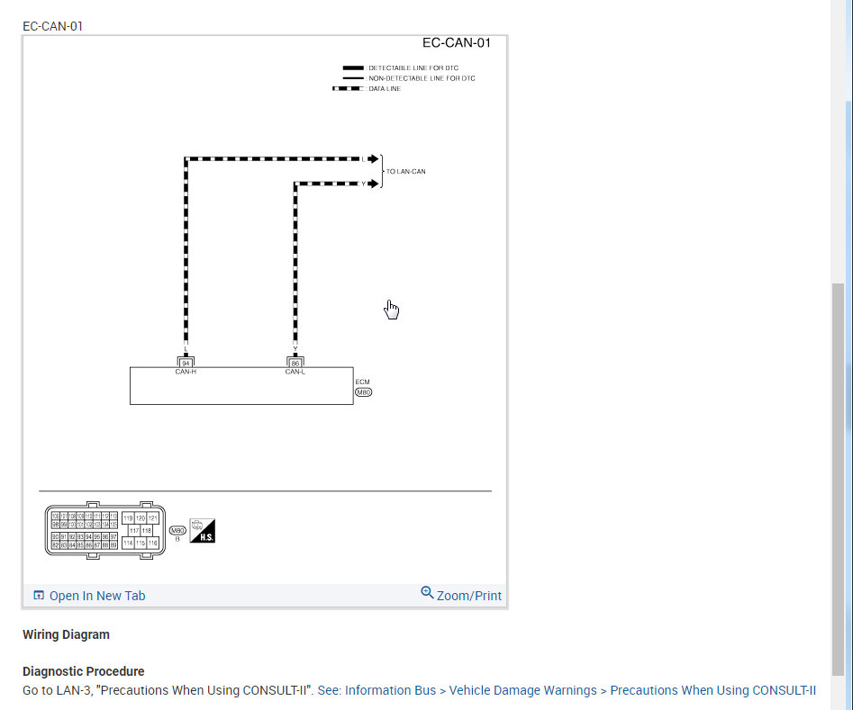

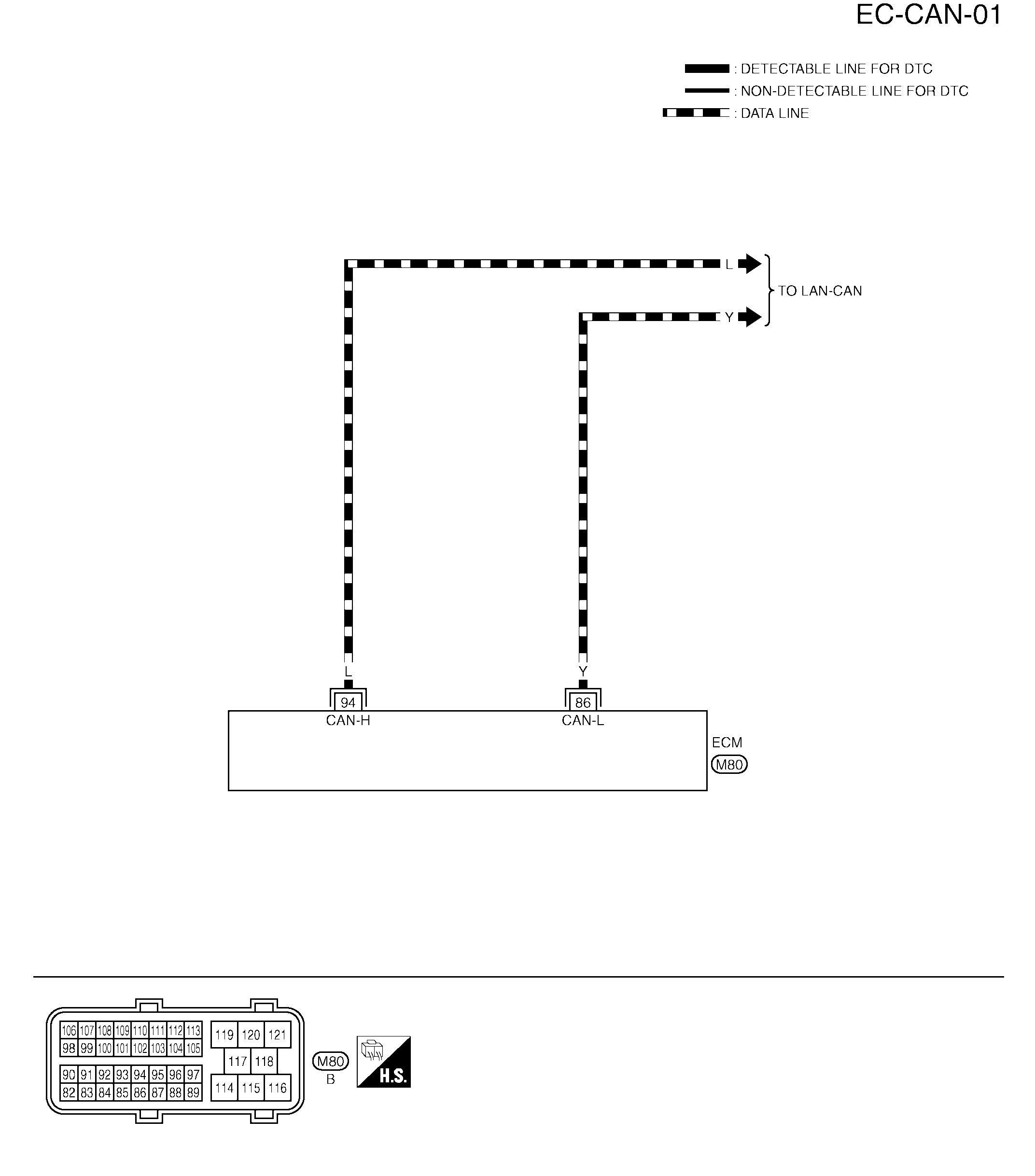

EC-CAN-01
pic 2

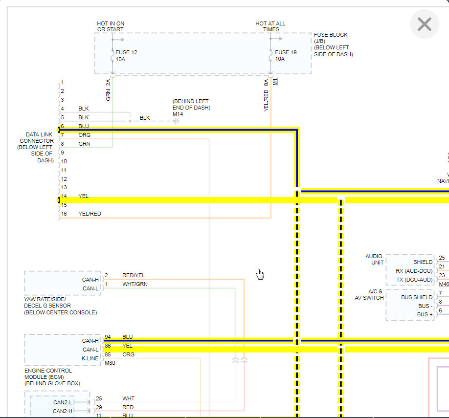

Wiring Diagram
Diagnostic Procedure

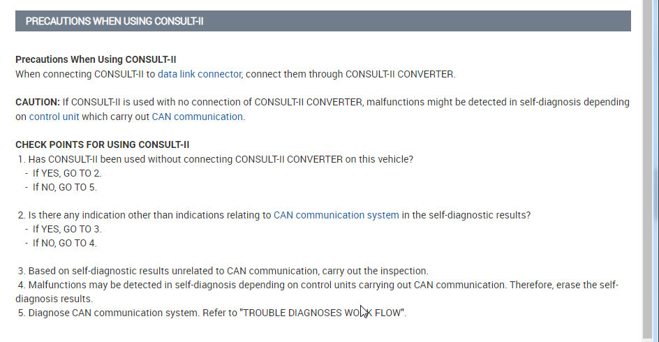

Go to LAN-3, "Precautions When Using CONSULT-II". See: Information Bus > Vehicle Damage Warnings > Precautions When Using CONSULT-II
