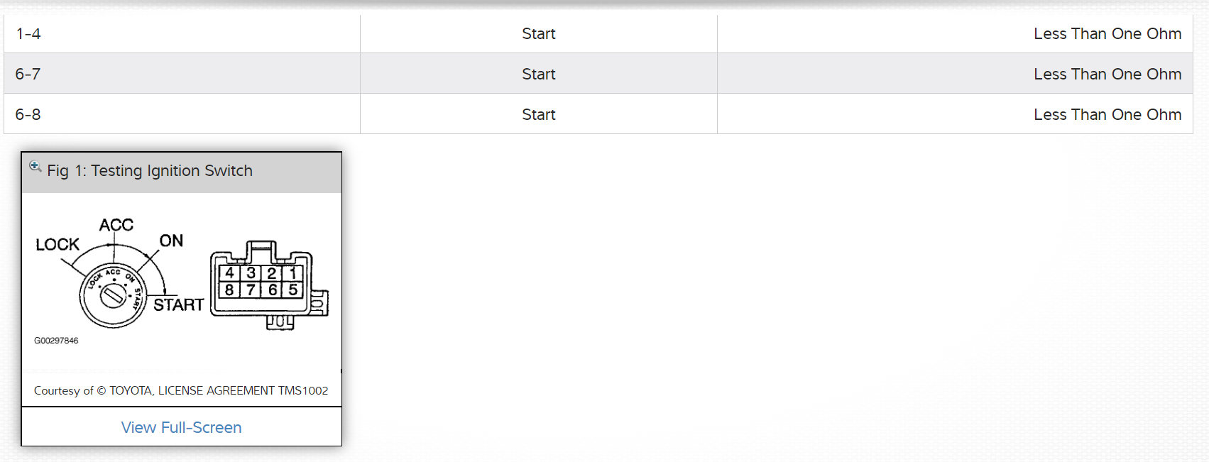

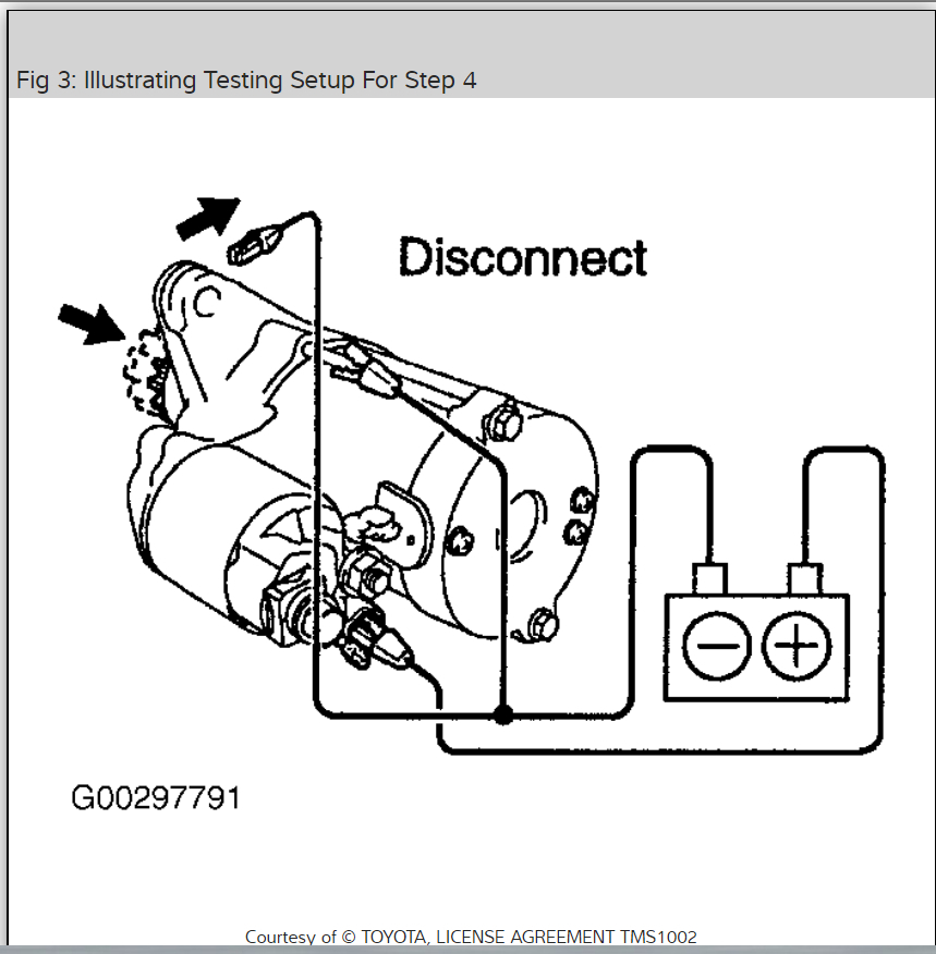

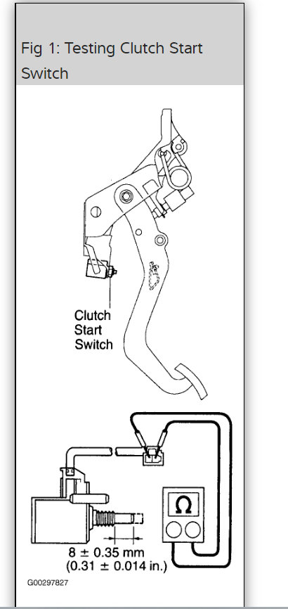

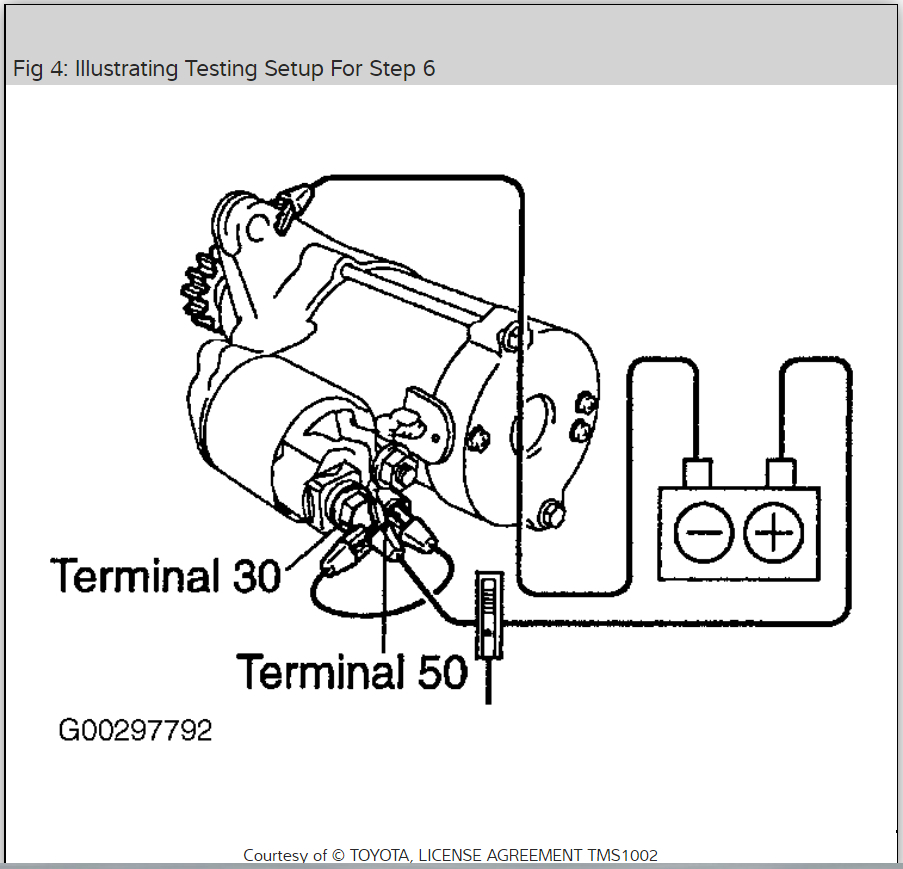

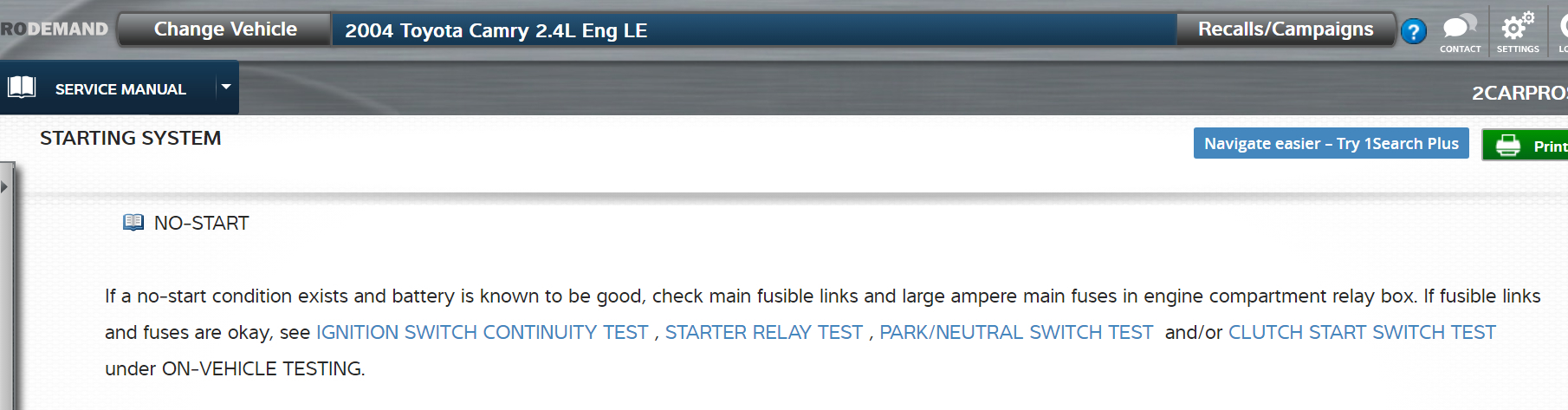

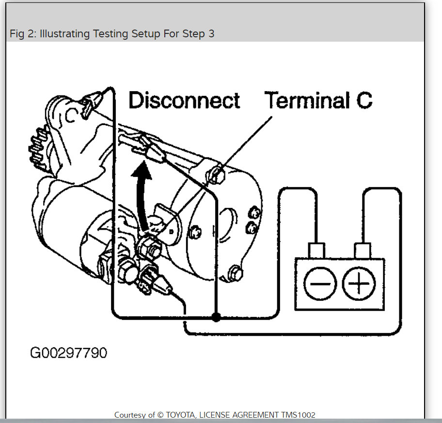

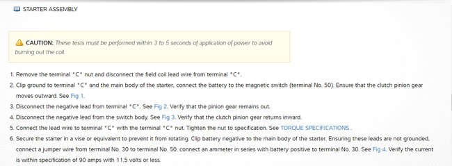

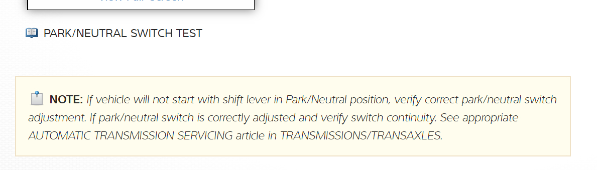

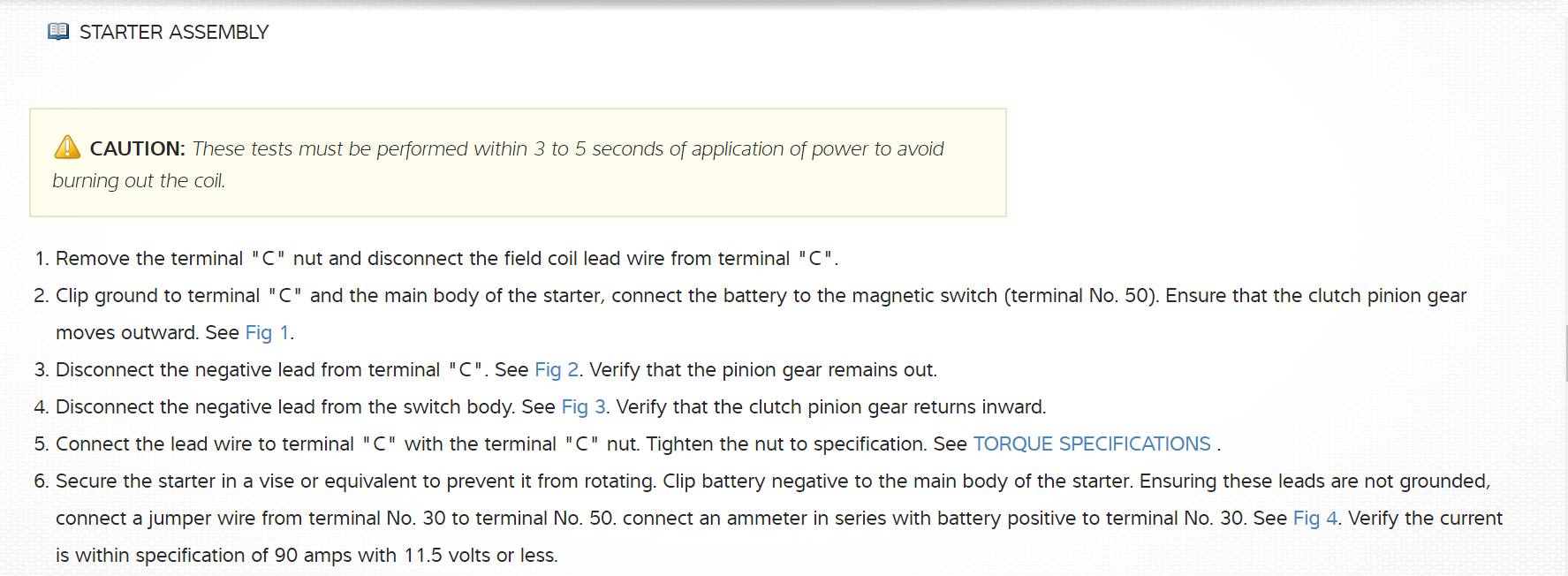

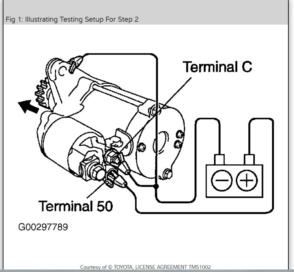

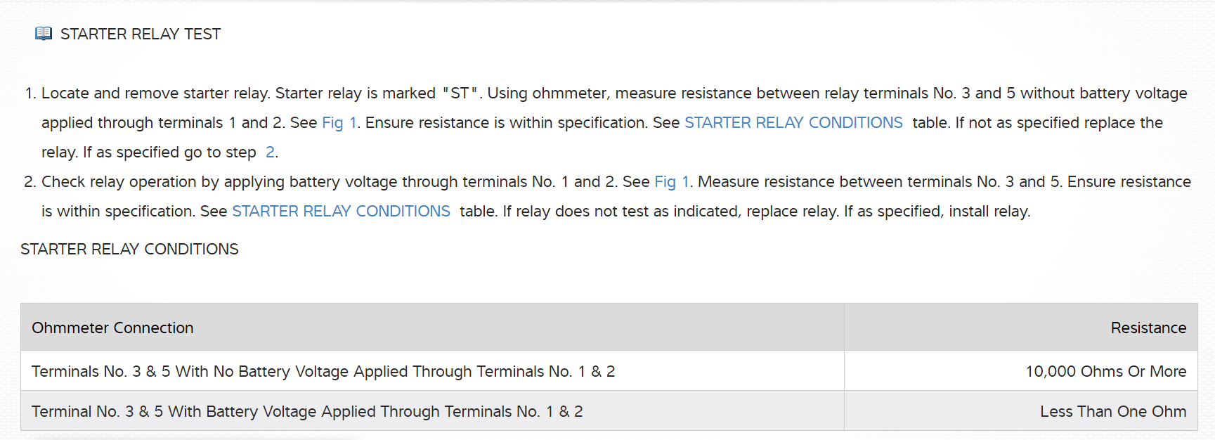

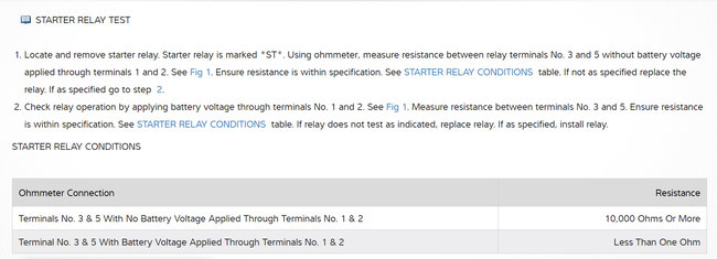

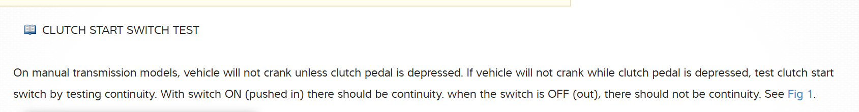

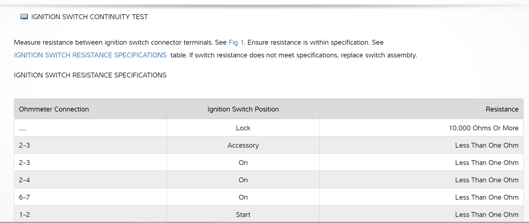

This could be a number of things. But to help you track it down I have included in the diagrams down below. Here is a guide to help you step by step with instructions in the diagrams below to show you how on your car.
Check out the diagrams (Below). Please let us know what happens.
