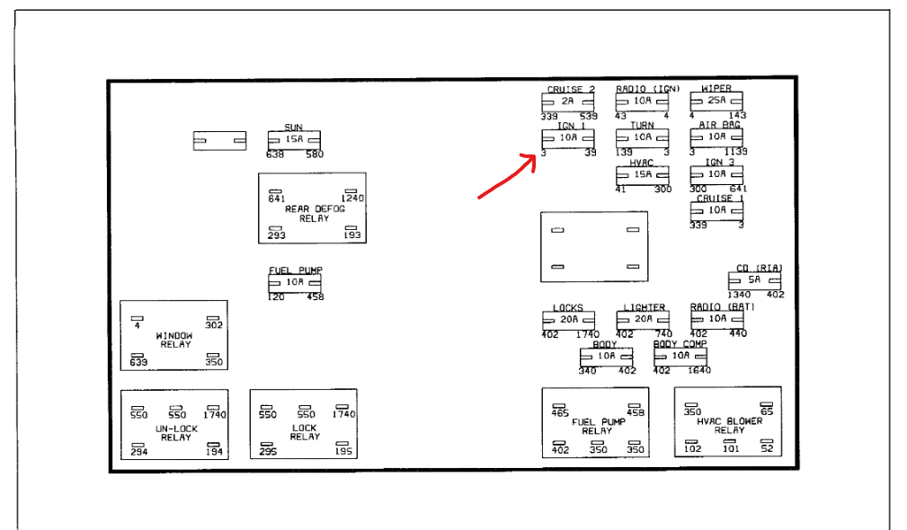

If it is not charging, can you check the IGN1 fuse (10 amp) in the fuse panel inside the car, here is a guide to help and i have included the fuse location in the images below:
Check out the images (below). Let us know what you find.

The alternator is charging the battery, so I pulled out and gently wiped the contacts on all the fuses and have not had a starting issue since. However, the battery light is still coming on and stays on for a while after starting.
