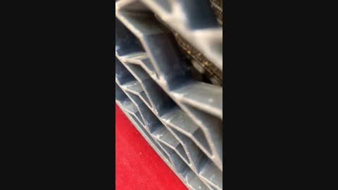

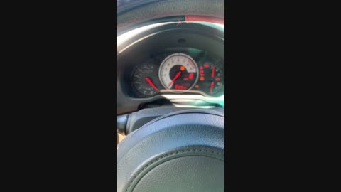

Attached some videos, I have a sprintex/innovate twin screw supercharger on my 2013 Scion FR-S.
It has its own separate radiator and was thinking that it went bad or the water pump.
It has a specific place to pour the coolant into so I know I poured it correctly, just the bottle wouldn’t stay full and before I knew it, it was dripping from the smaller radiator.

Do me a favor. Pull the plugs and inspect them to see if there is evidence of coolant getting to them.
Also, check the engine oil to make sure nothing is mixing with it. I looked up the supercharger and believe we could be getting coolant into the combustion chamber.
Let me know what you find.
