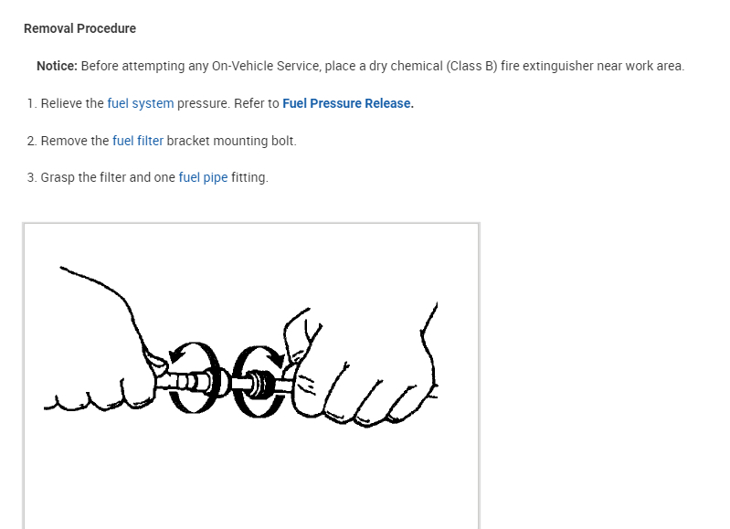

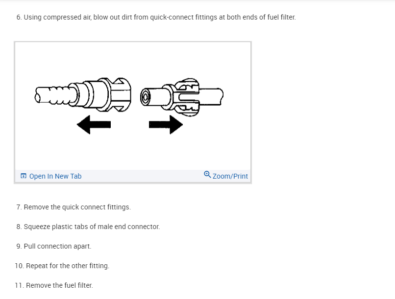

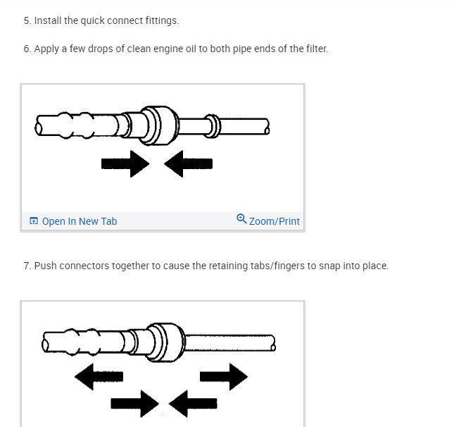

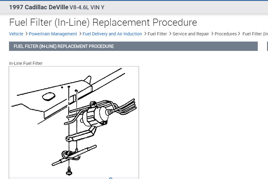

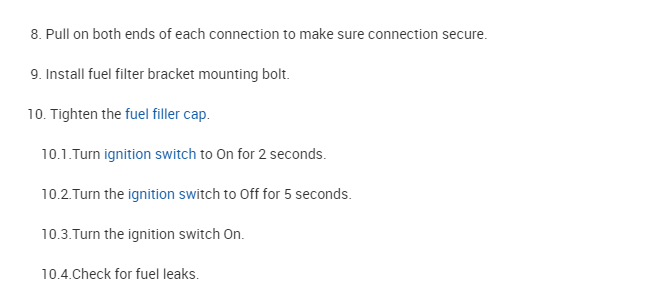

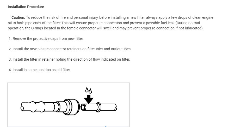

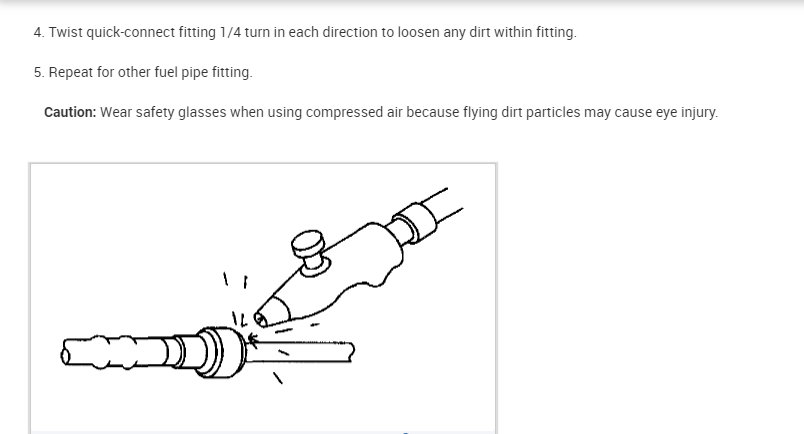

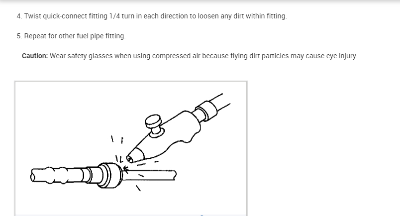

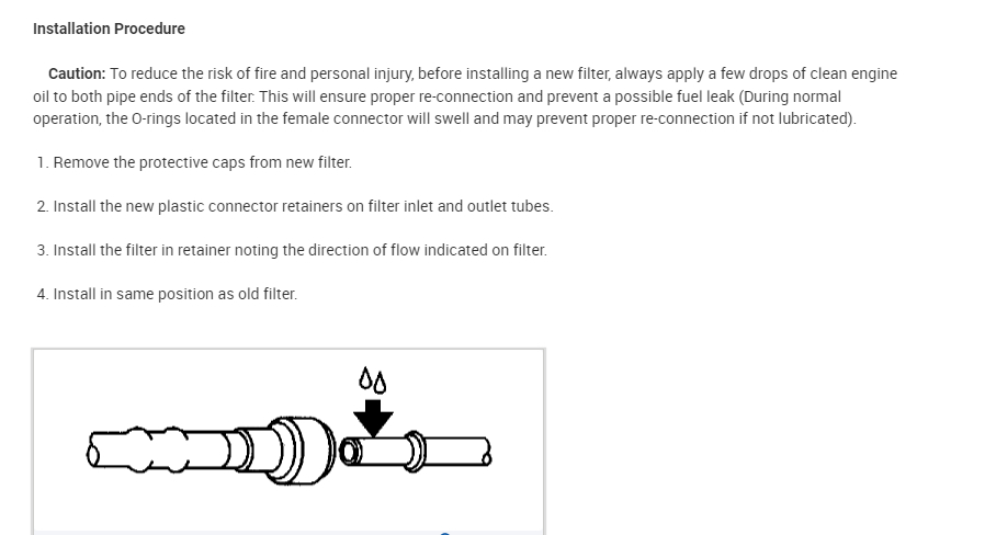

Usually when you turn the ignition key to "run" the fuel pump will come on for a couple of seconds to prime the fuel system. So with this in mind I would recommend that you change the fuel filter on your vehicle. Here is a generic guide on how to change a fuel filter:
https://www.2carpros.com/articles/how-to-change-a-fuel-filter
In the diagrams down below I have included a guide from the vehicle manufacturer on how to change the fuel filter specifically for your vehicle. Please go through these guides and report back with how everything turns out.
