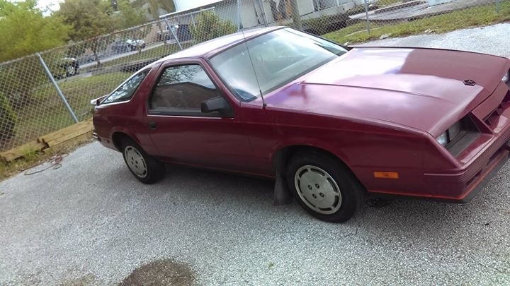

Car was running went into house came out three minutes later and it stalled. Gas is good , battery good. turn key on and off three times and gone no codes flashing. Tried some starting fluid in intake and nothing. turns over but will not start
