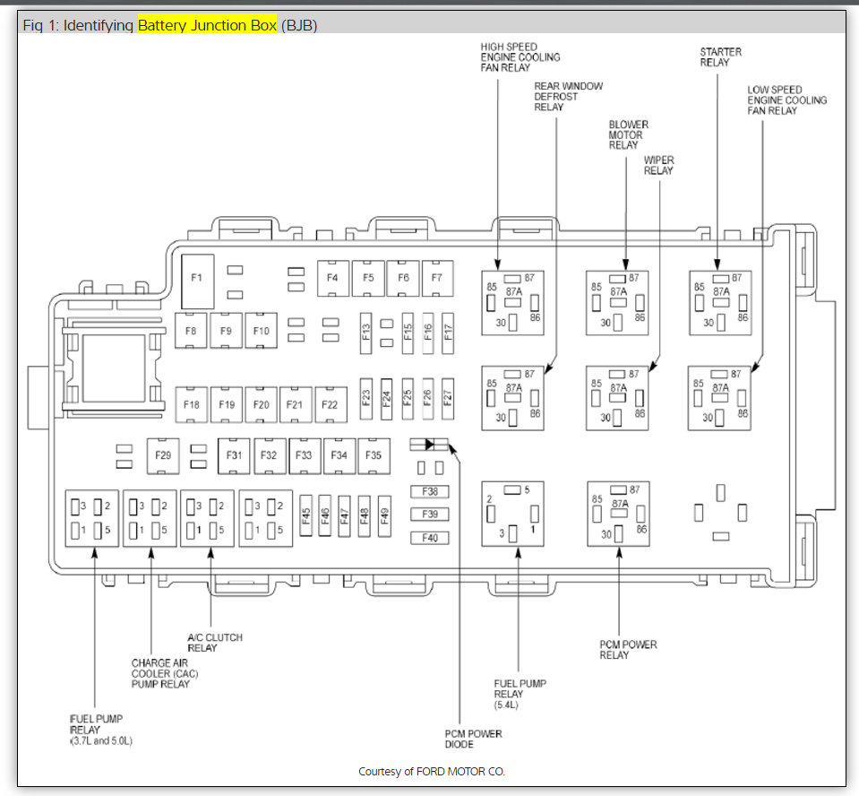

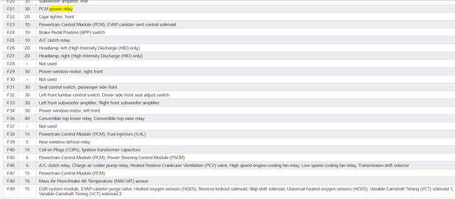

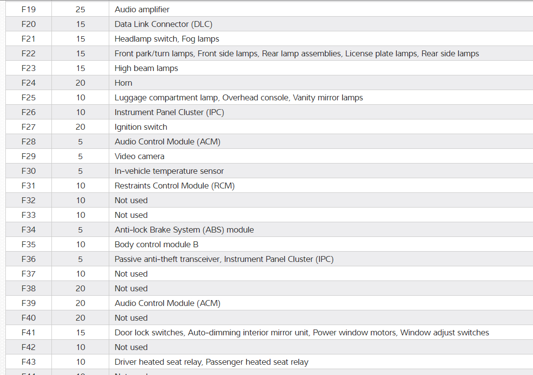

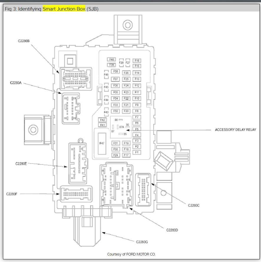

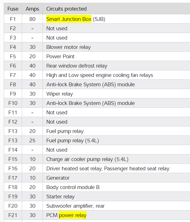

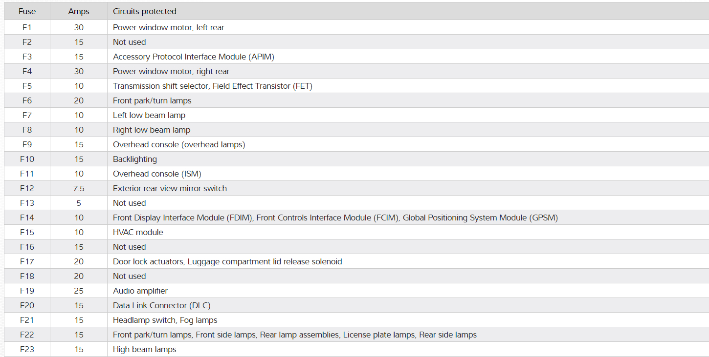

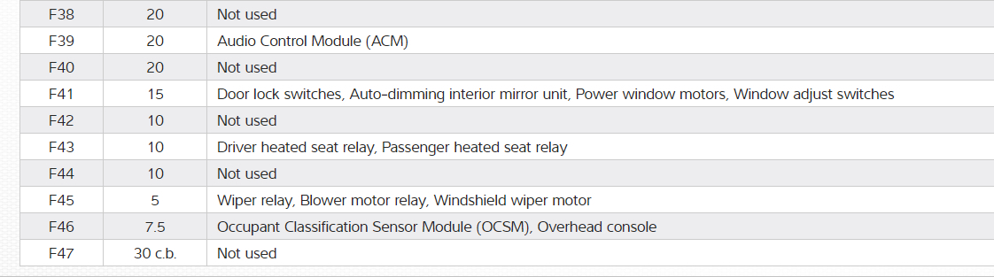

I would start by checking the fuses because if you have a power feed to one of the computers it will throw that code.
Here is a guide a diagrams to show you where the fuses are (below):
I know its basic but we need to start somewhere.
