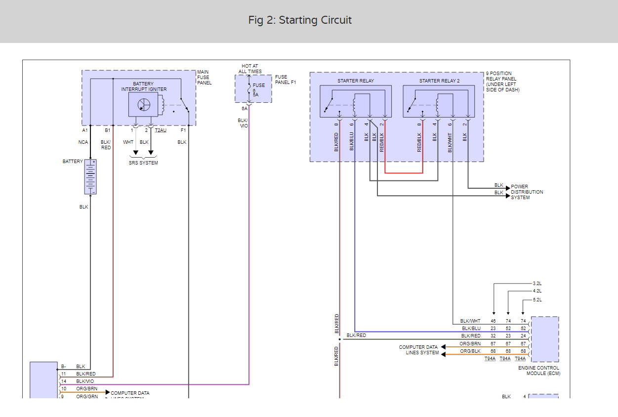

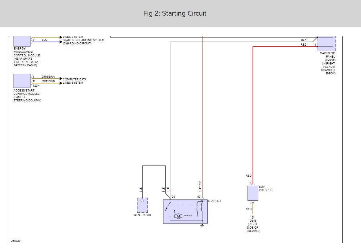

This sounds to me like you have got a short to power somewhere in the circuit between the battery and the ignition switch. In the diagrams down below I have included a wiring diagram of your vehicle's starting circuit. I would start by check your vehicle's battery interrupt igniter which is in the main fuse panel. Please get back to us with what you are able to find out.
Thanks,
Alex
