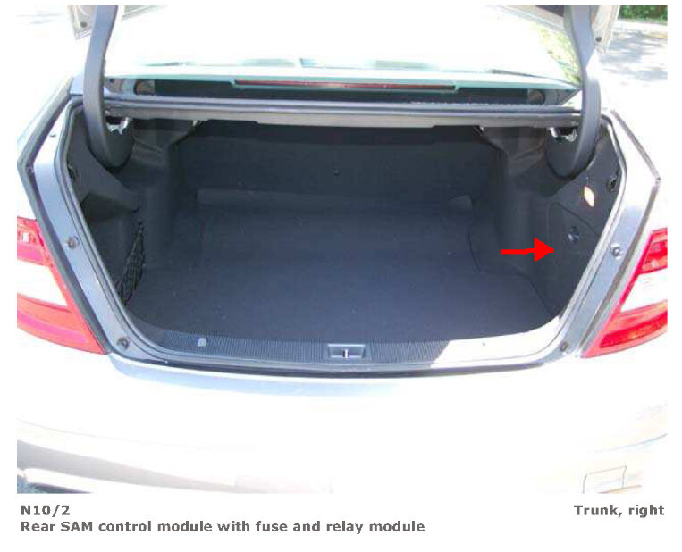

There is a fuse panel in the trunk of the vehicle as well on the driver's side. I would go through all the fuses, there may be more than one fuse that blew also. I'll find the exact locations of all the fuse panels for you.

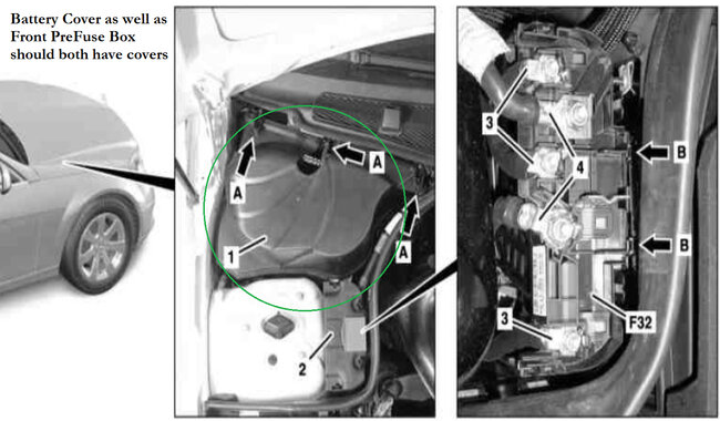

But I'm almost positive these vehicles have a cover that's supposed to be over the battery. The C Class has an additional battery on the right side of the trunk (passenger side) as well.

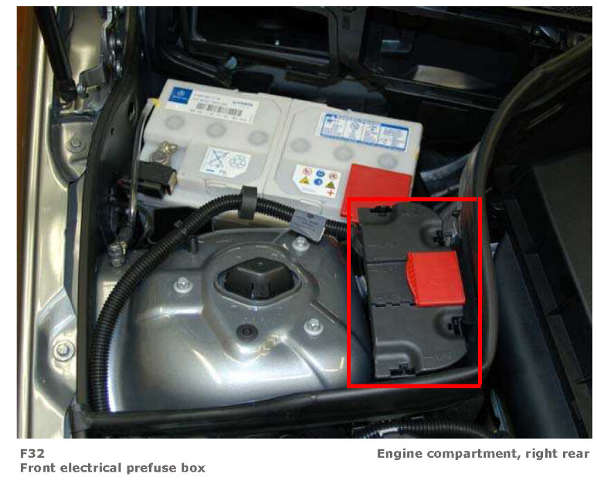

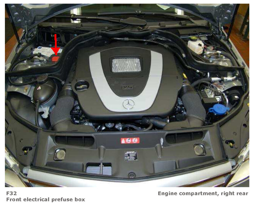

Well, this vehicle has 5 fuse panels, Diagrams 1-3 below are the Front PreFuse Box location and there should be a cover over the Battery in this location.

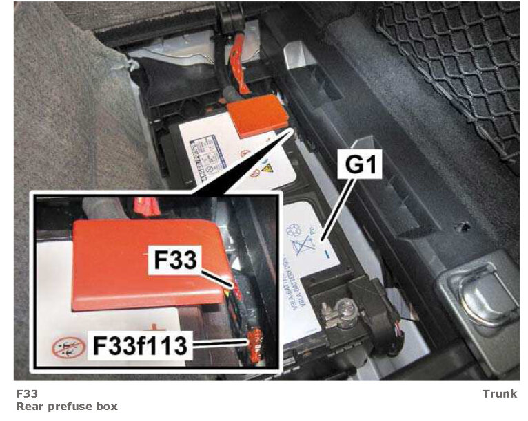

Diagram 4 is the Rear PreFuse Box, it looks to be under the carpet with some type of access cover,

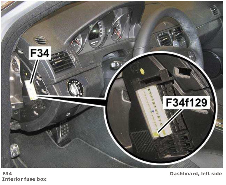

Diagram 5 is the Interior Fuse Box.

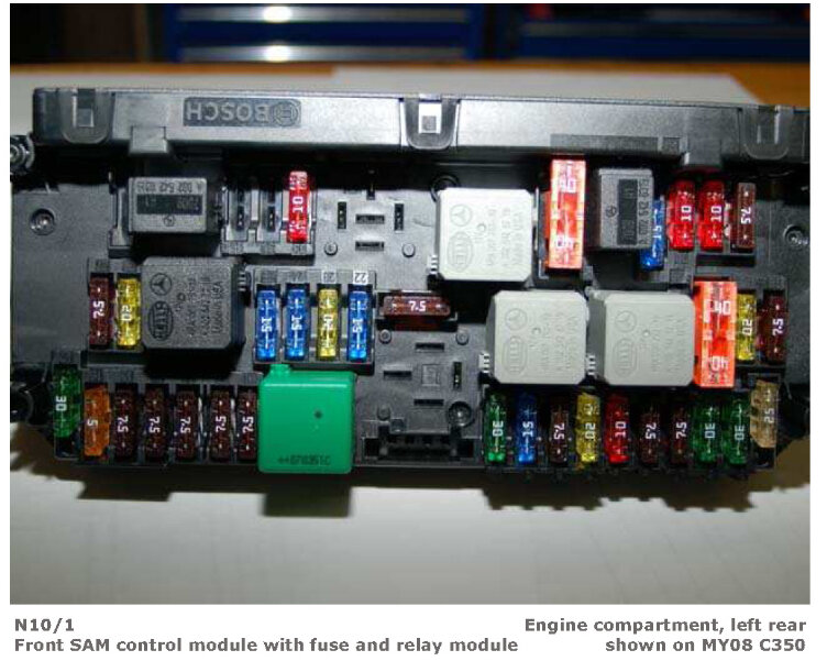

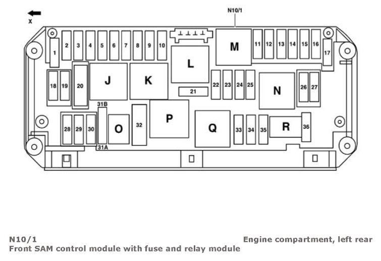

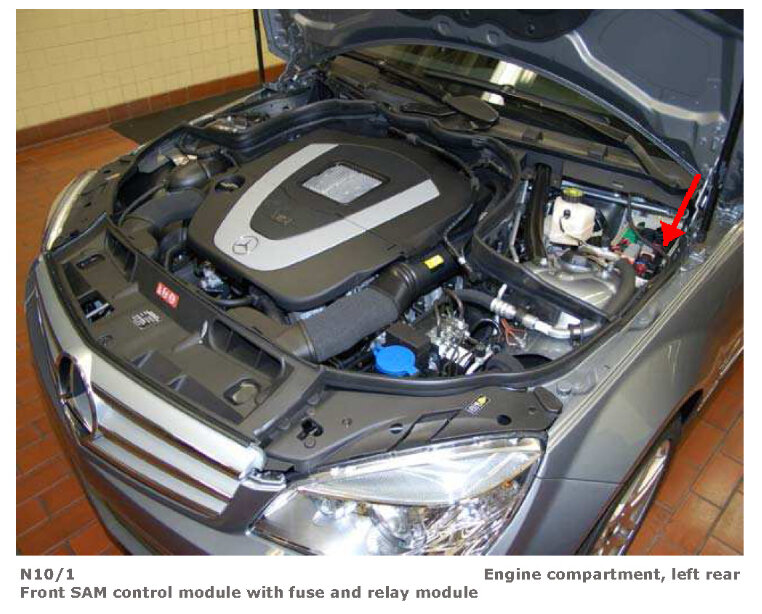

Diagrams 6,7,8 is the Front SAM control module and Fuse/Relay module, the SAM module acts as a sort of Body Control Module,

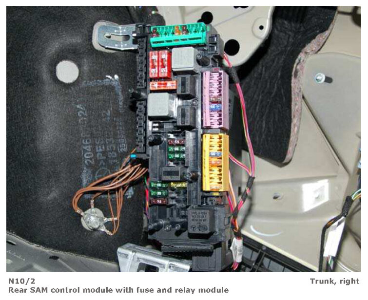

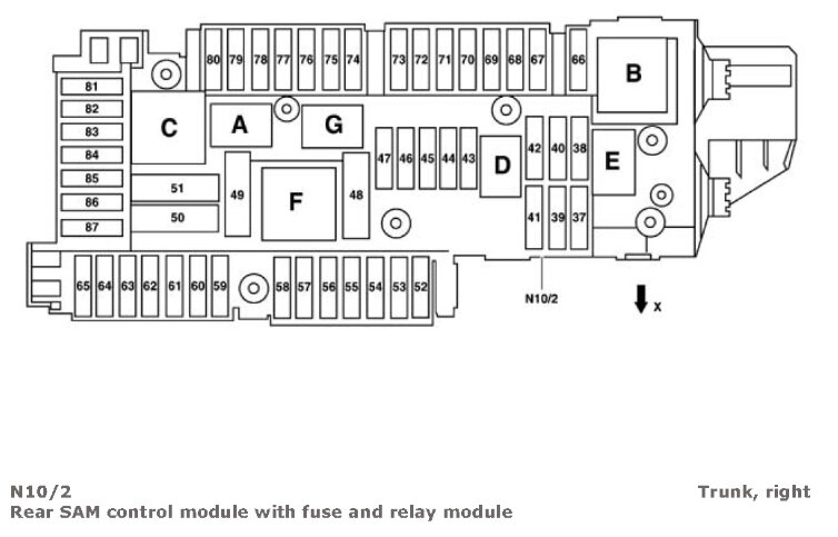

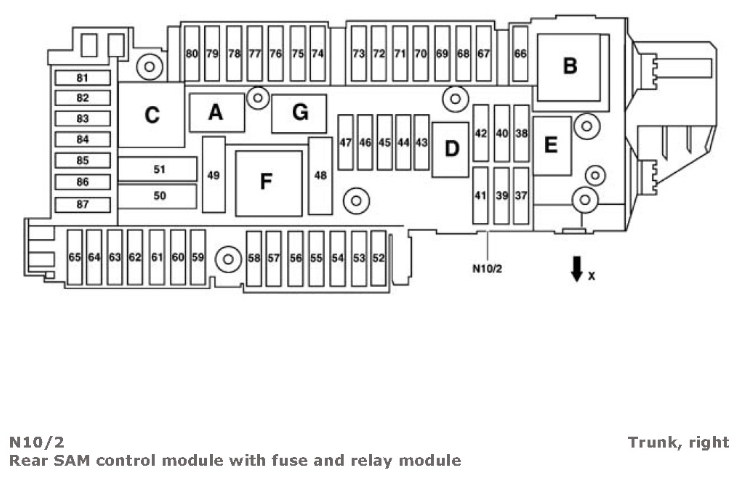

Diagrams 9,10,11, is the Rear SAM control module and Fuse/Relay module, behind a passenger side cover, so there are a lot of fuses to check in this vehicle to start with. If the Battery cover is missing, that's an issue. Sometimes it's not put back or forgotten about after a repair. Check for that as well.
