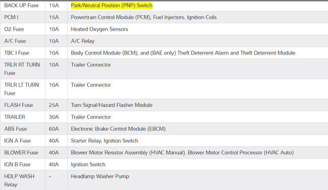

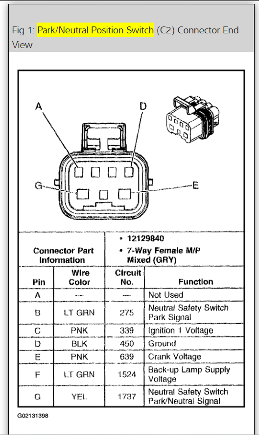

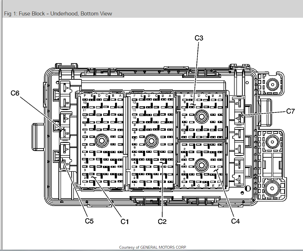

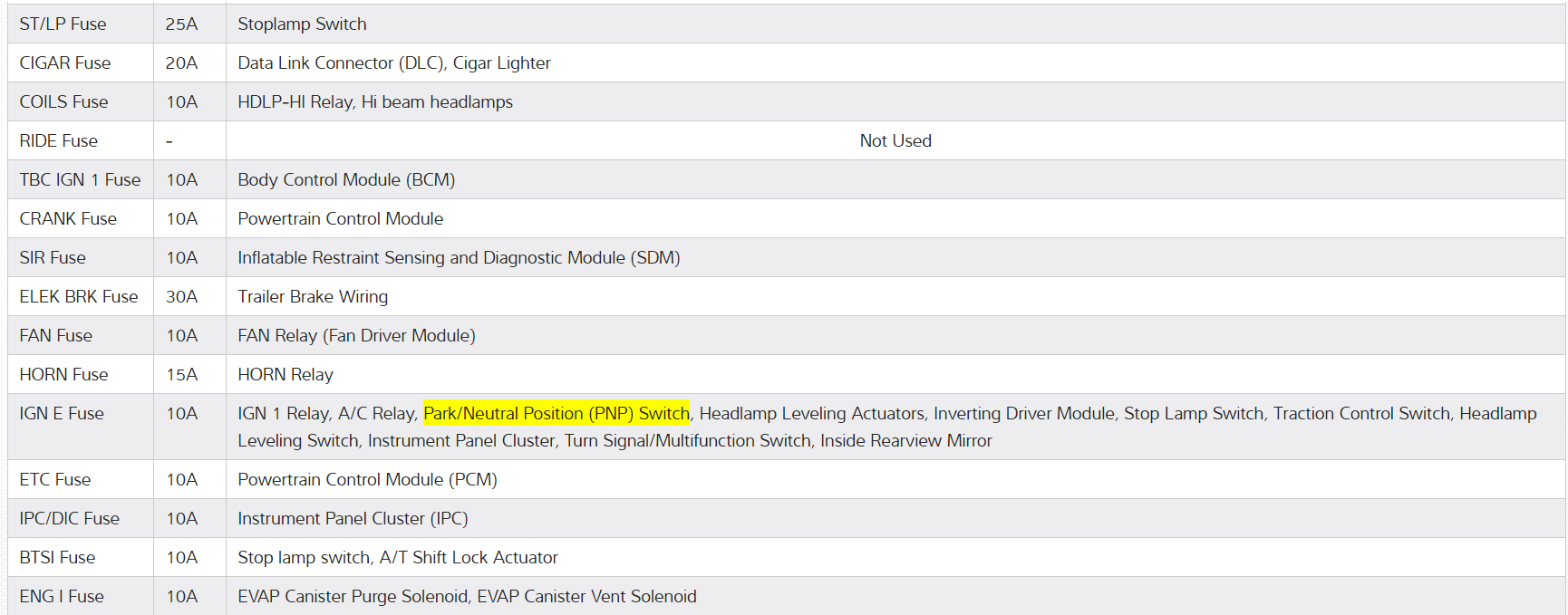

I had to get a replacement lever box and shift cable, once these had been replaced I am unable to get the starter to work?
Feb 23, 2019 at 5:27 AM
SCGRANTURISMO
  • 4,897 POSTS

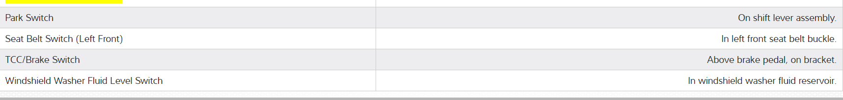

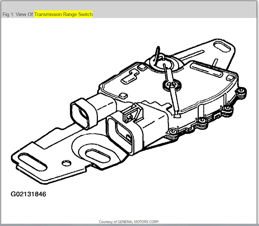

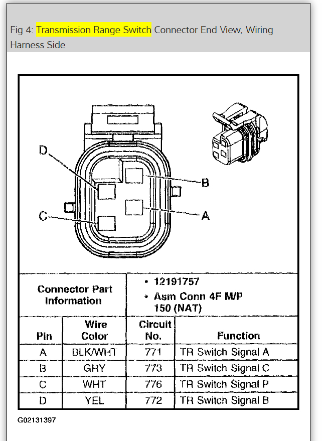

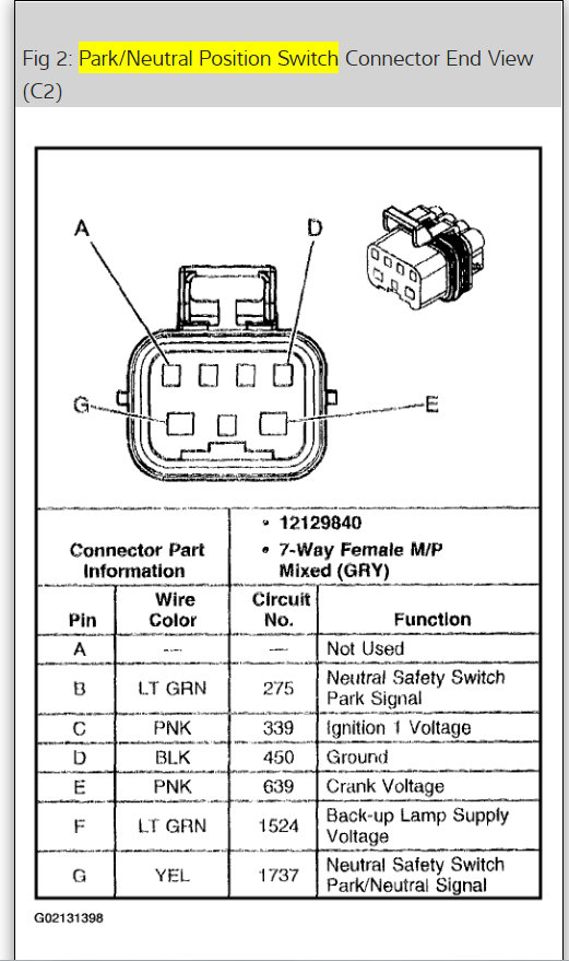

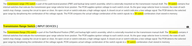

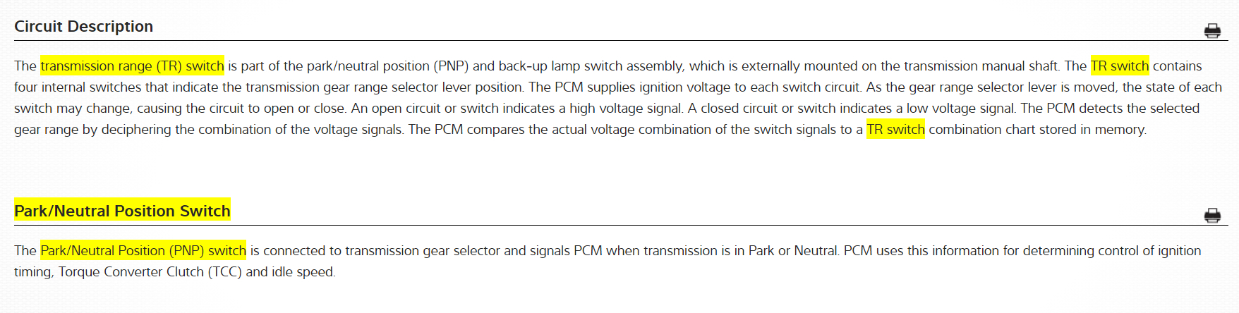

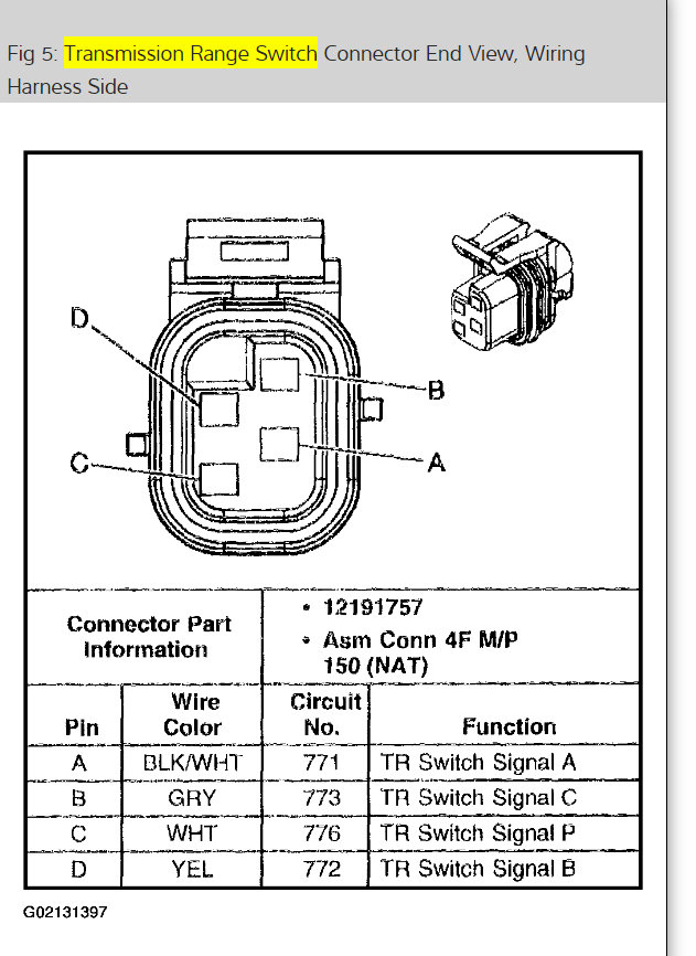

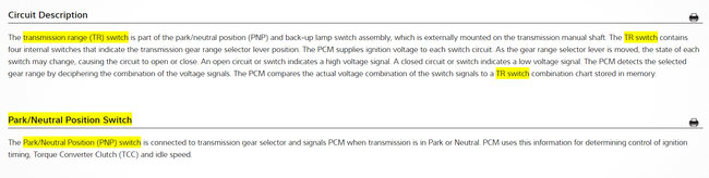

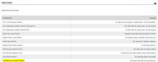

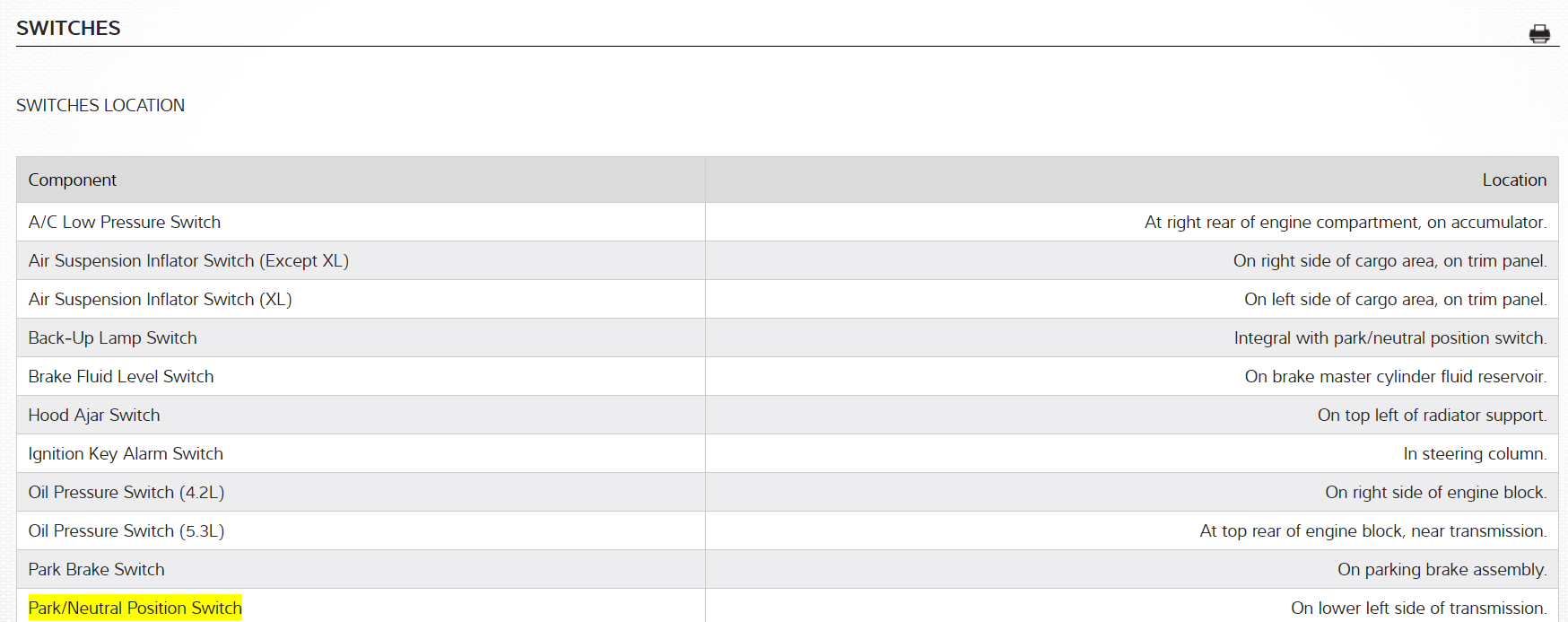

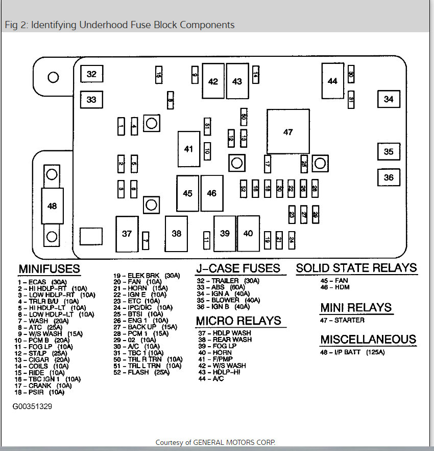

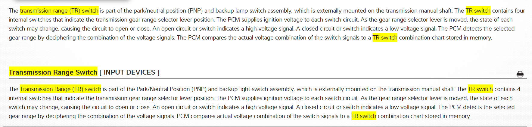

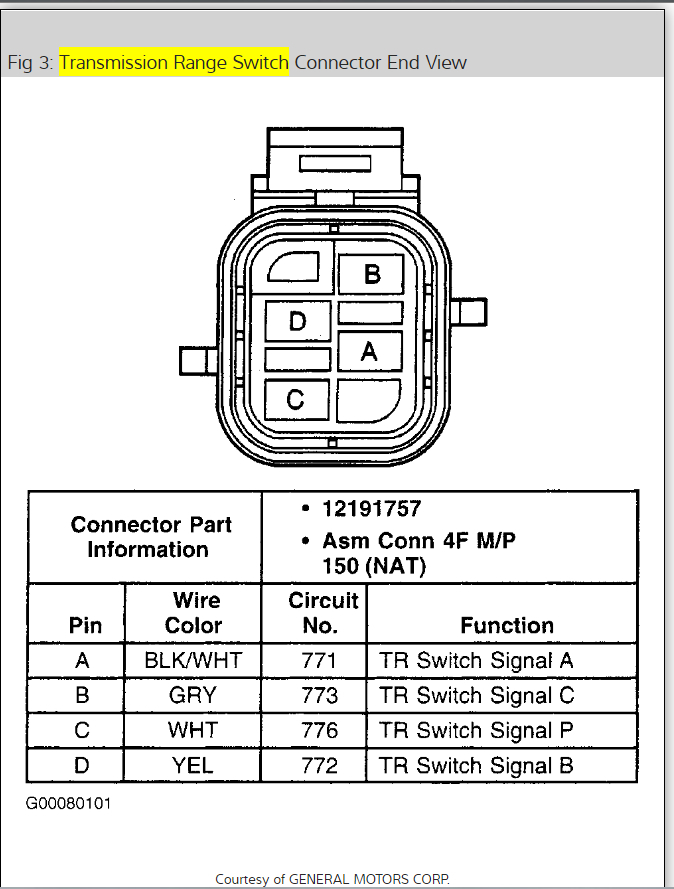

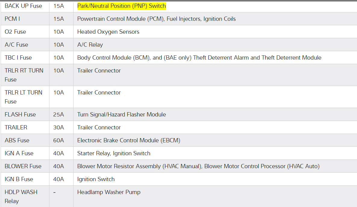

This could be a problem with your neutral safety switch. I have included in the diagrams down below. Troubleshooting, adjustment, location, and wiring diagrams for this system on your vehicle.
This guide can help us fix it or see whats wrong.
https://www.2carpros.com/articles/starter-not-working-repair
and
Please go through this information and let us know what you find out. Check out the diagrams (Below). Please run this test and get back to us.
