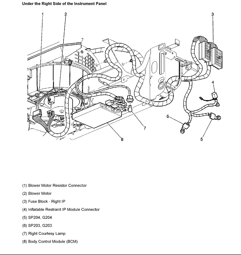

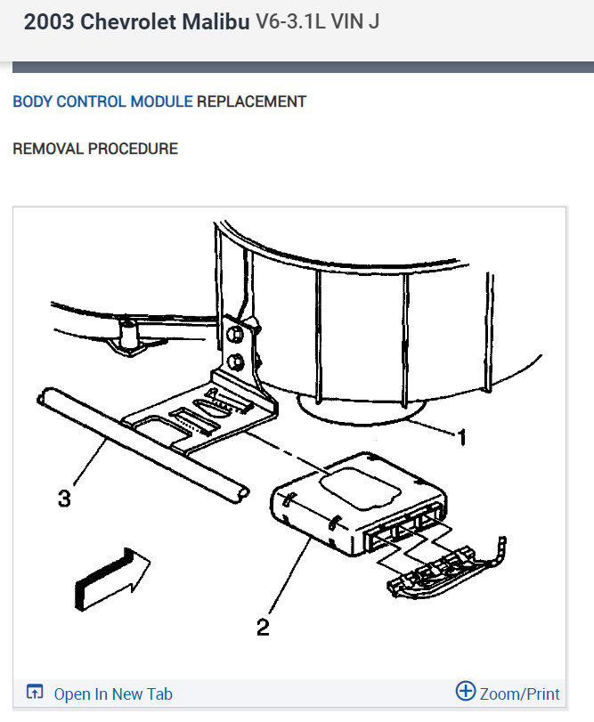

Here is the body control module location which I would check the electrical connections for corrosion, and if there is none and you have codes for it, I would get a preprogrammed unit by searching Google or Ebay. Check out the images (below). Please let us know what happens.
