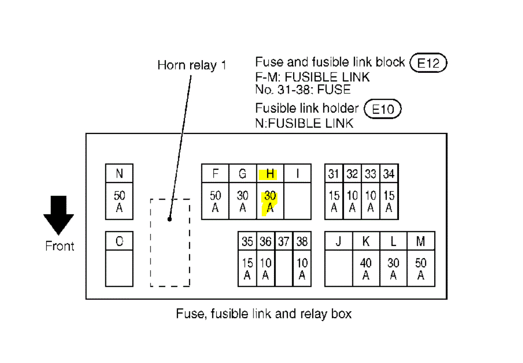

If that is all good, check the fusible link (30 amp) in the fusible link block. See pic 1

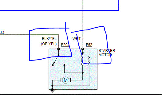

If the fusible link is good and has power both in and out, check for power at the starter. Pic 2 shows the starter. The wire from the battery black/yellow will have 12v all the time. Confirm that. The other smaller wire which is white should receive 12v when the key is in the start position, so you will need a helper to check that.

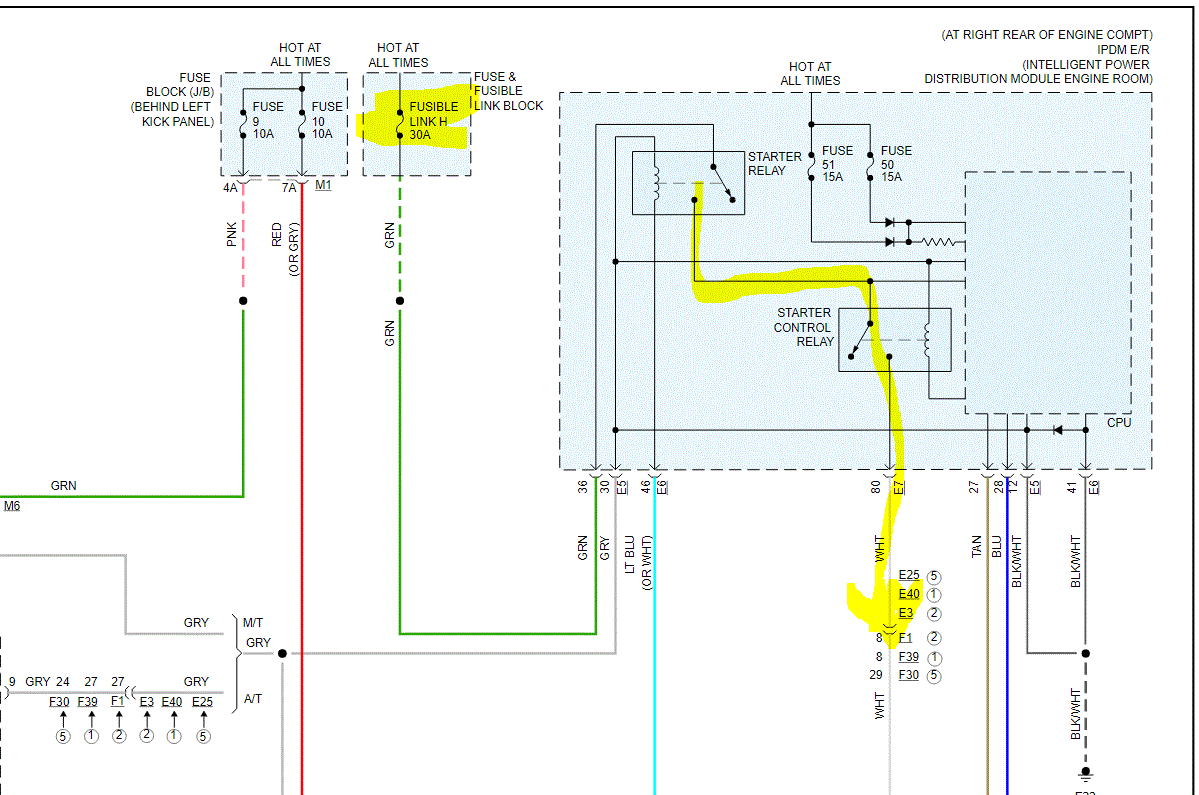

Pic 3 shows fusible link H.
