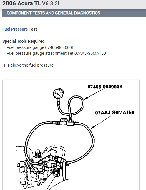

Before you changed the pump, did you test to see if it was indeed the pump?

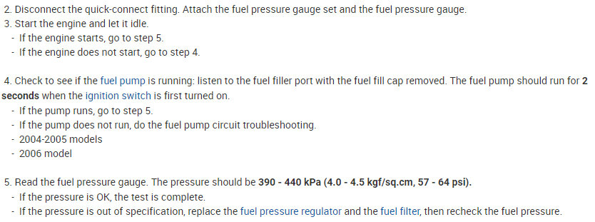

When you turn the key, can you hear the fuel pump come on?
You should have about 57 - 64 PSI of fuel pressure with a good pump.

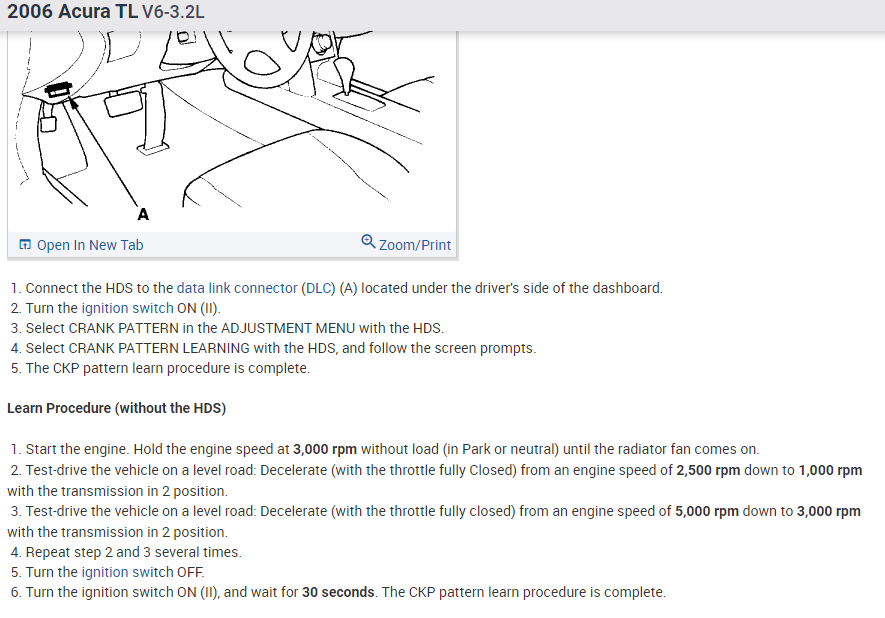

No, the car cut cut off while I was driving and i got i towed home. changed the fuel pump and relay went to go crank it up then i heard a weird noise under the hood and it never started.

So it cranks but no start, right? Can you upload a video of the noise?
