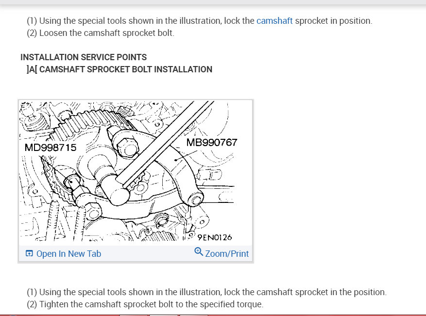

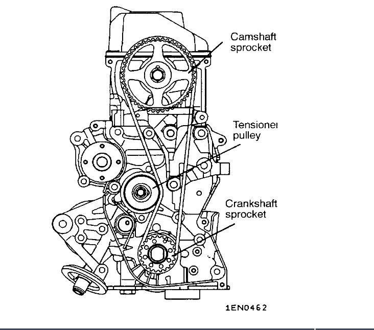

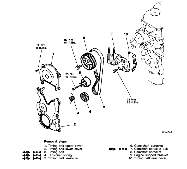

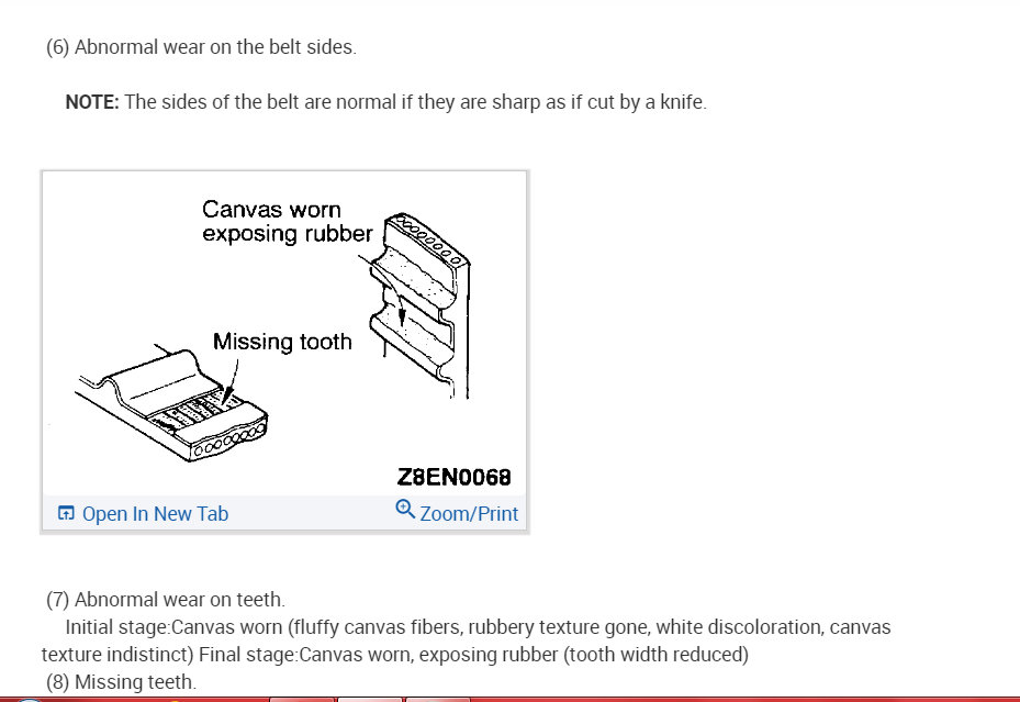

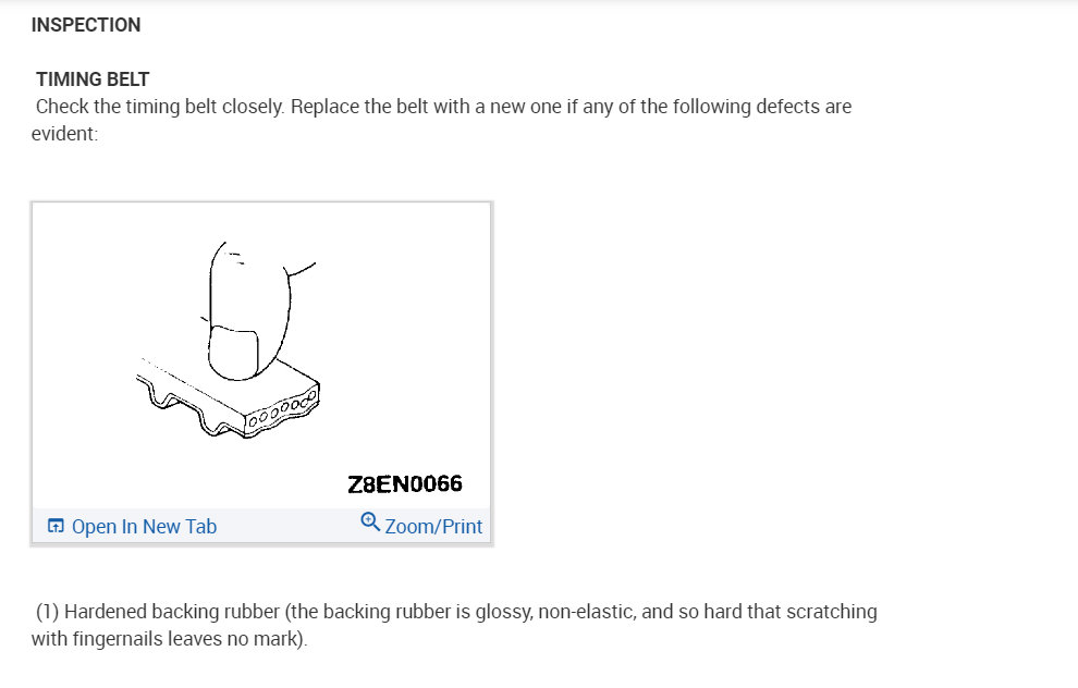

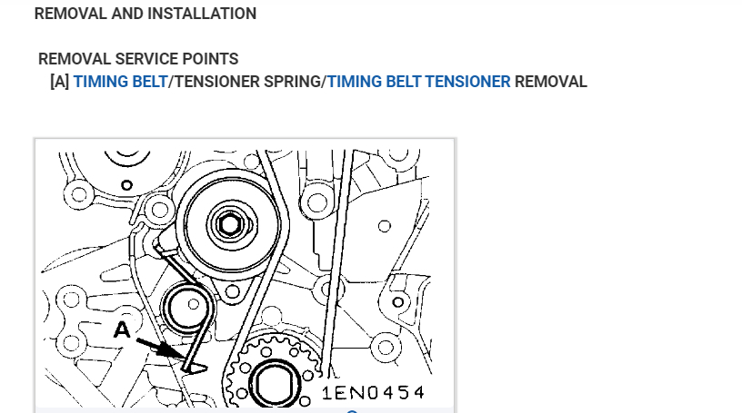

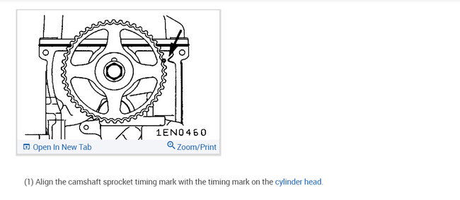

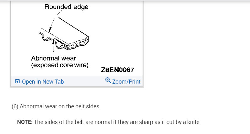

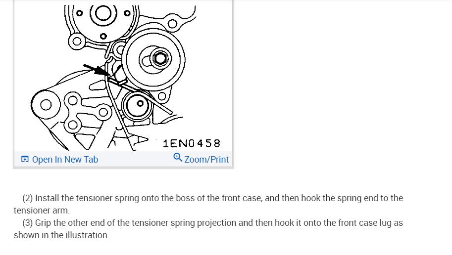

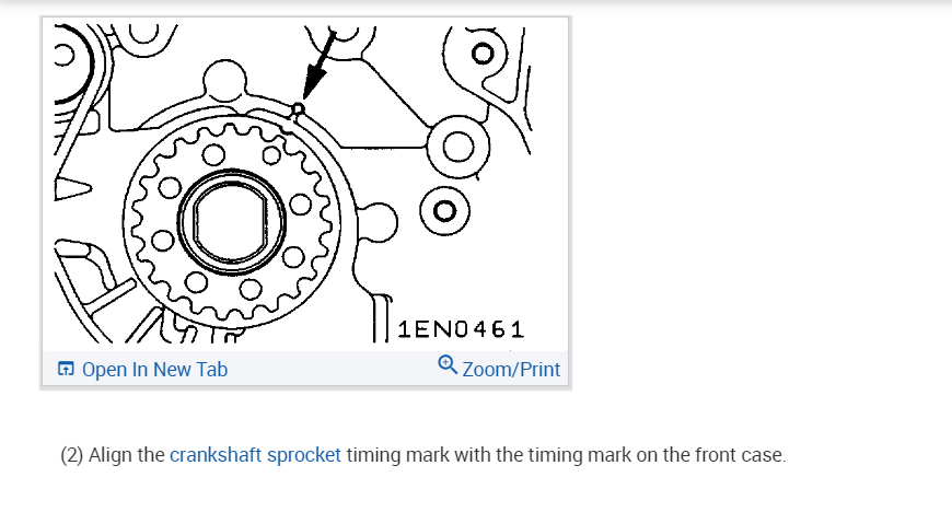

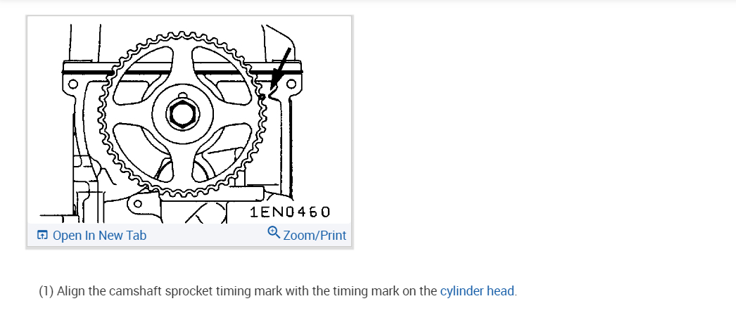

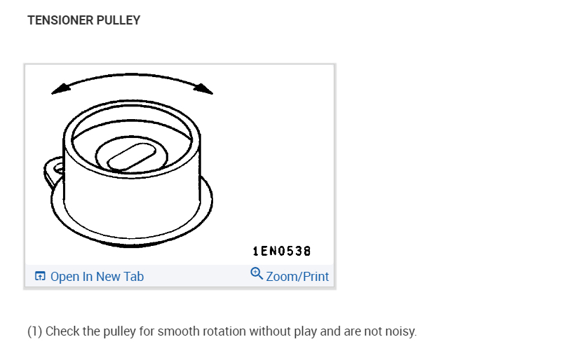

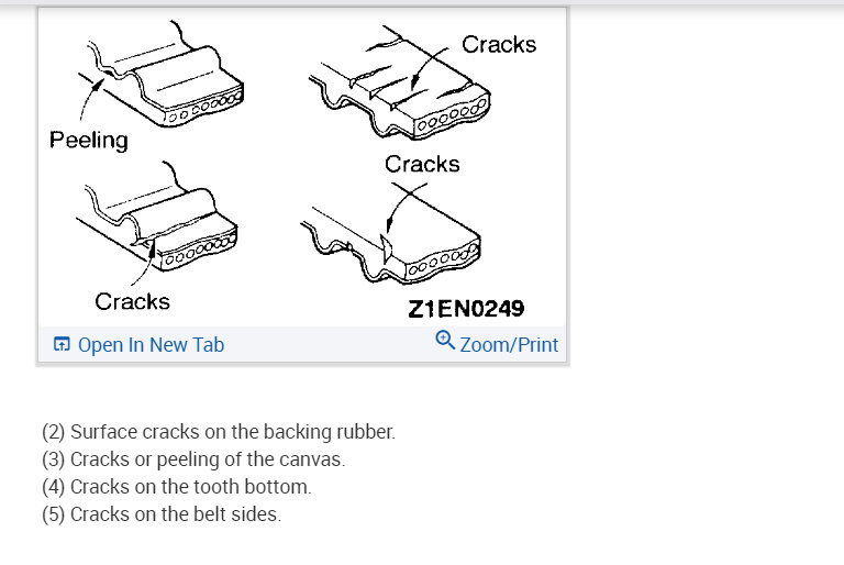

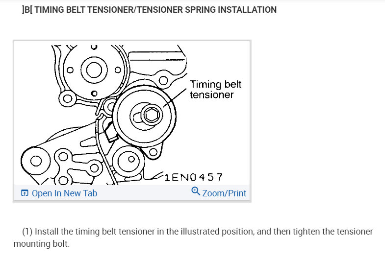

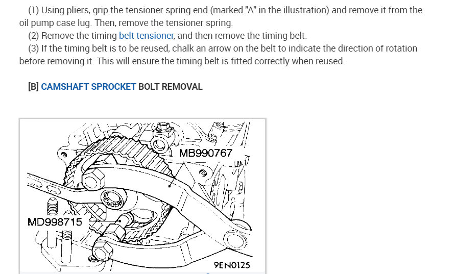

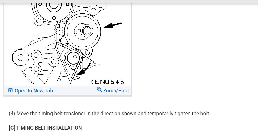

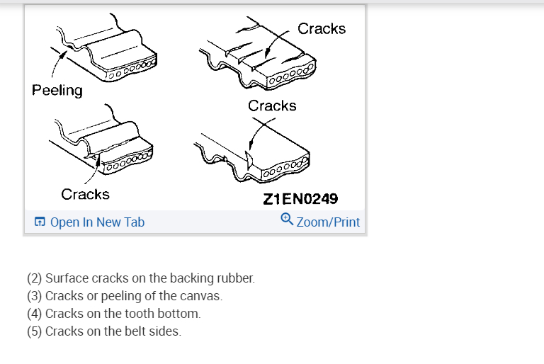

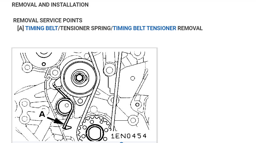

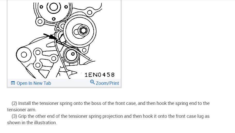

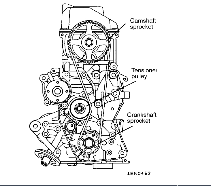

Have you had the timing belt replaced on this vehicle? It sounds to me like the timing belt may have broken on the vehicle. So, you are going to have to take the timing belt cover off to get a look. In the diagrams down below I have included the factory guide for the removal, installation, and inspection of the timing belt on your vehicle. Please go through this guide and get back to us with what you find out and we can go from there.
Thanks,
Alex
