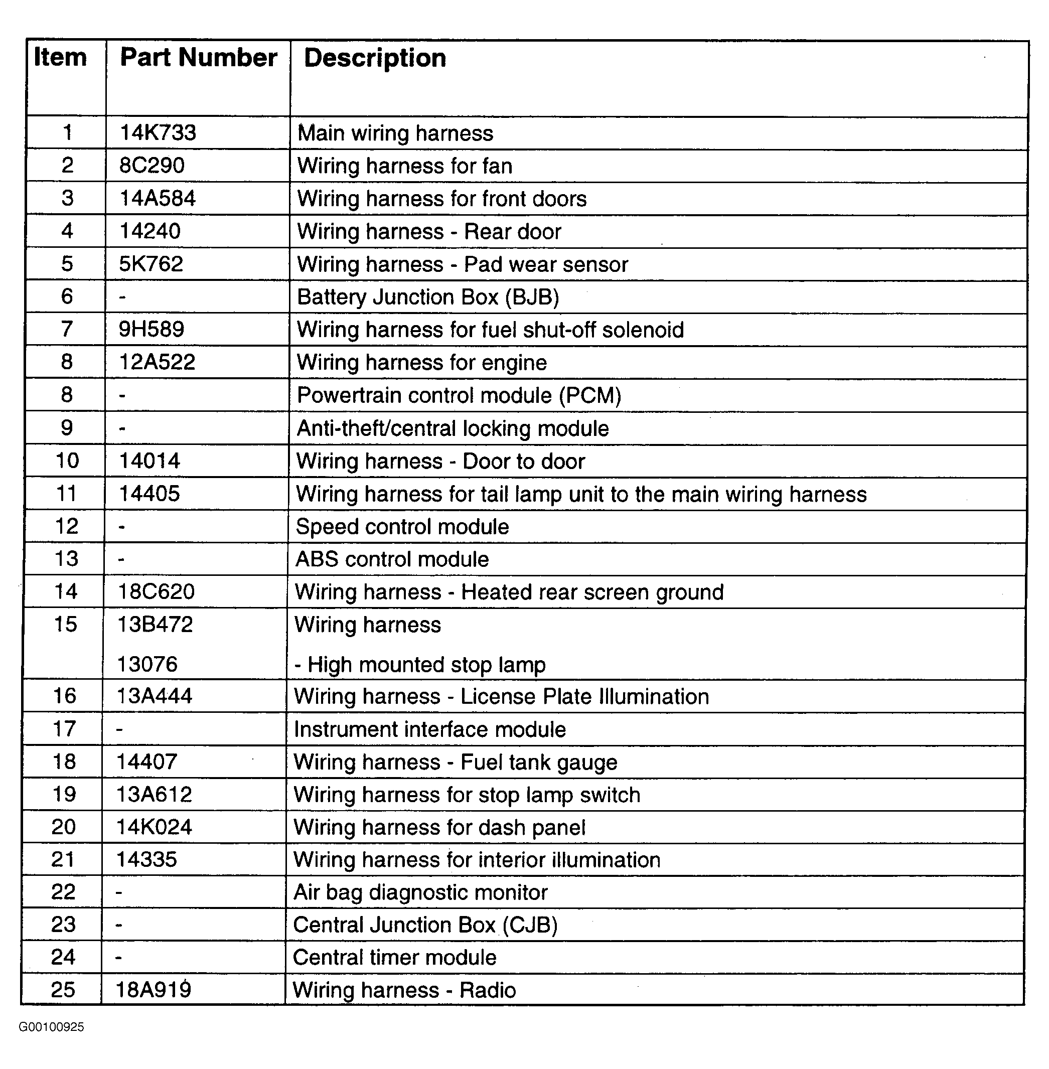

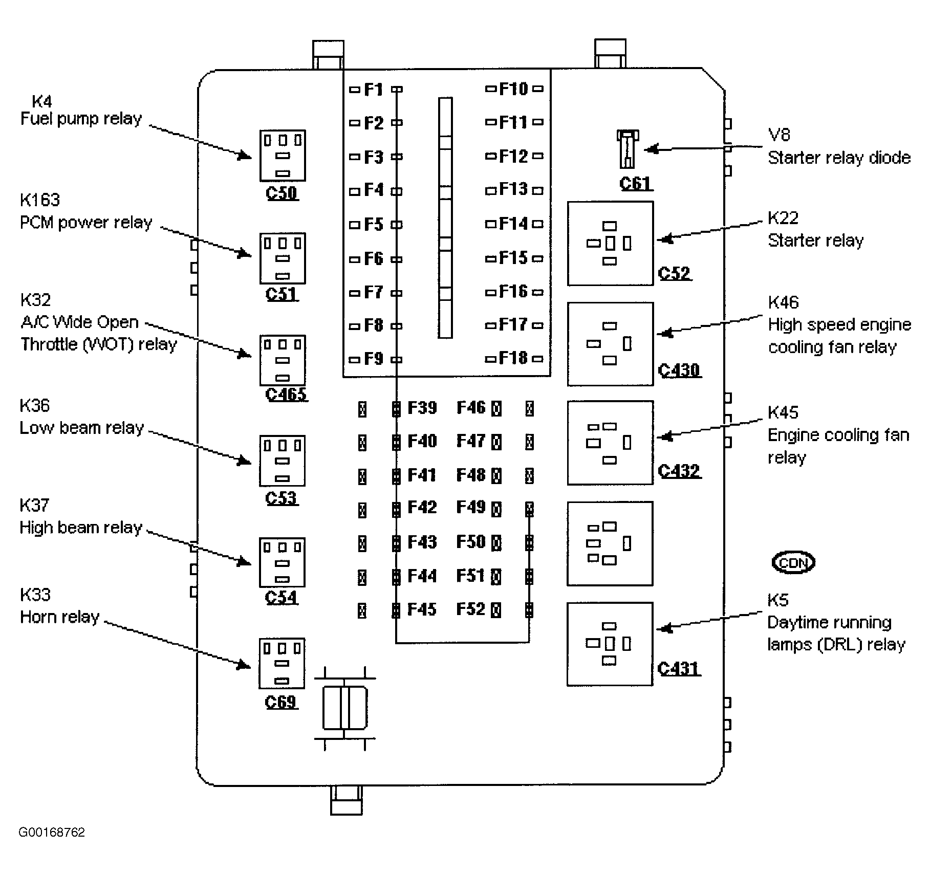

Can you get me the diagram for both internal and under the hood for the fuse boxes?

Battery junction box fuse and circuit identification

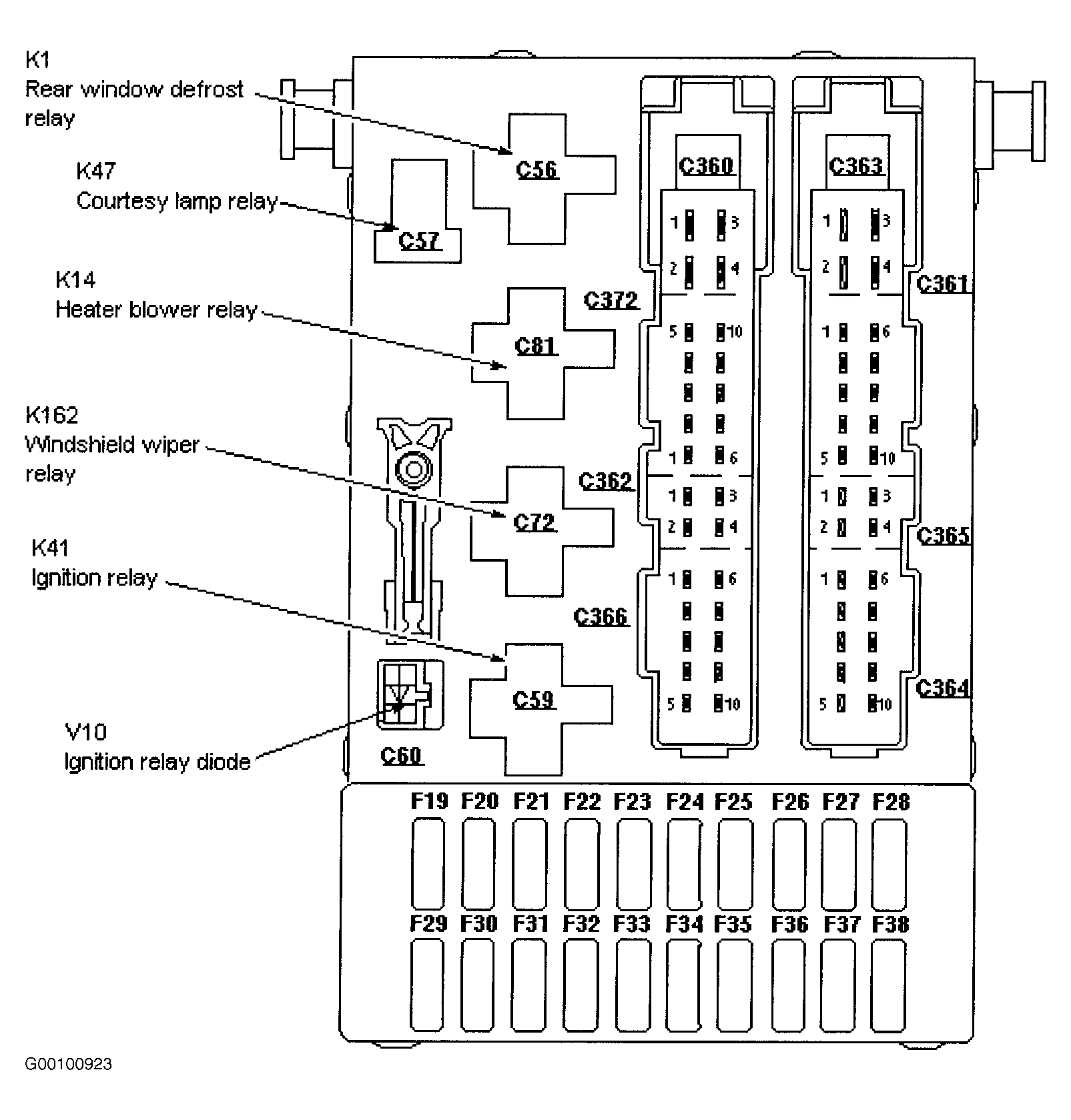

And can you get me the one under they dash please?

That was included in them, that is the central junction box. these two.

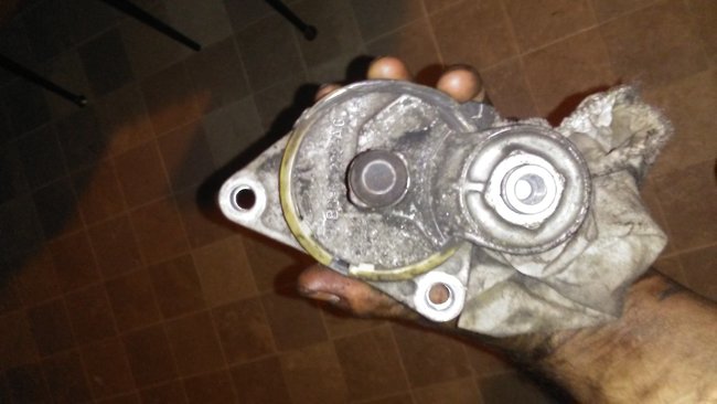

What part has the inprint 97BB-6A220-AG. Please and send a picture if you can.

No this is some kind of tensor.

I have no idea what that is. A search of that part number comes back with nothing at all.
Perhaps you should include the location of where you found it, what it looks like and any color wires going to it.
If you are just asking a general question as to what it is, where did you get this part number from?
A snap shot of it may also help identify what it is along with all the other information.

Here is the tensor and will kerosene hurt a motor? because I took the oil filter off and I am smelling gas or kerosene.

Are you saying that is a serpentine belt tension-er that you are holding in your hand?

Yeah, that is what AutoZone said.
