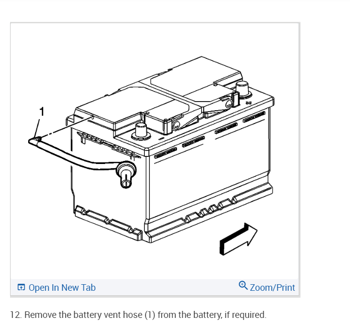

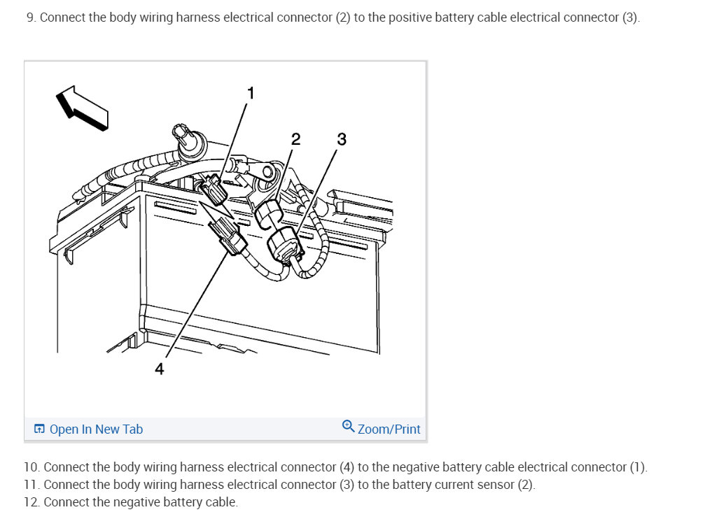

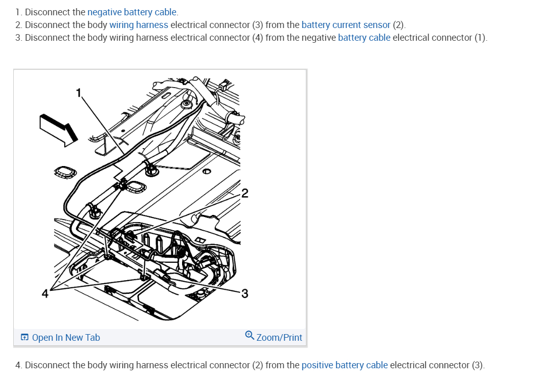

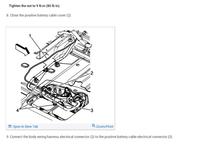

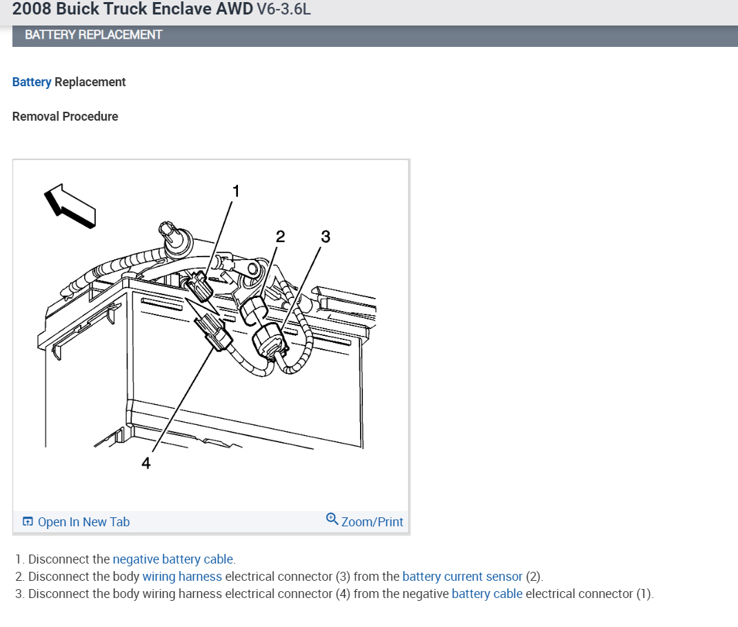

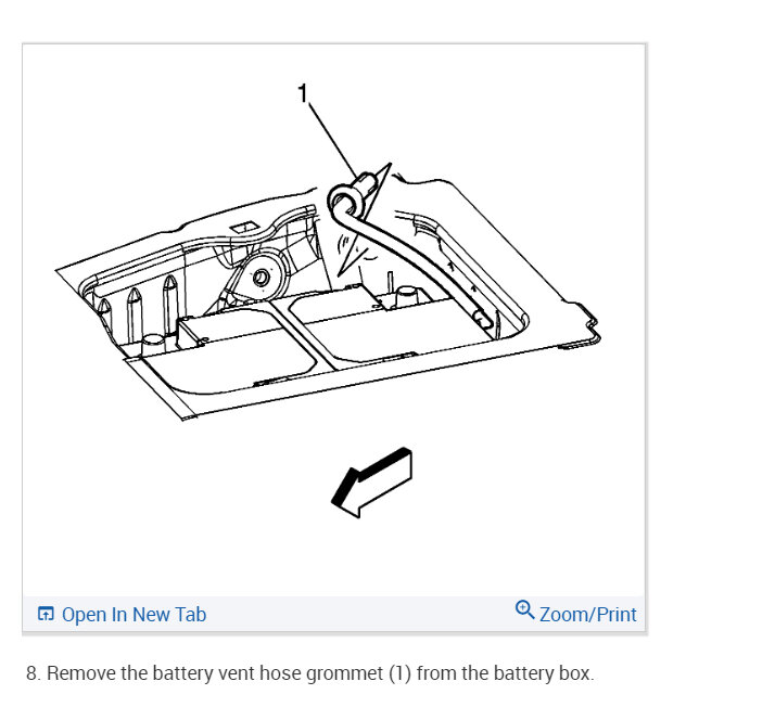

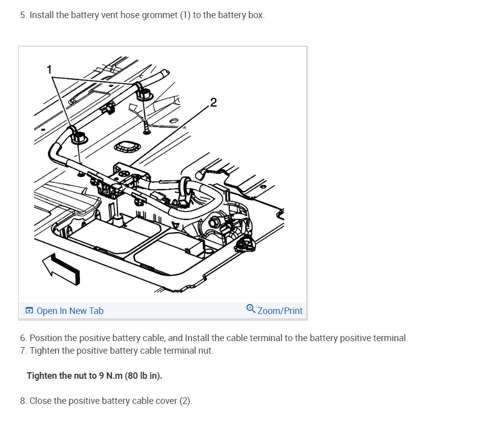

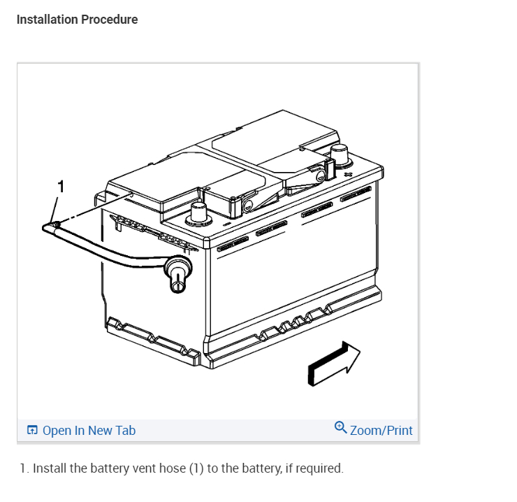

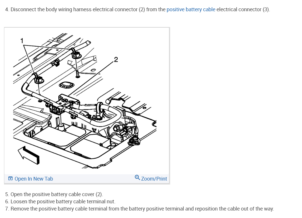

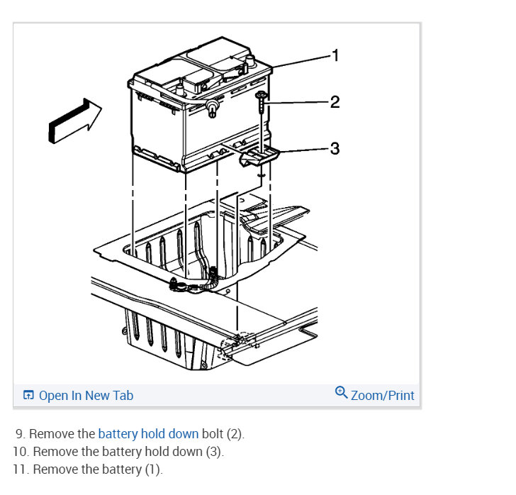

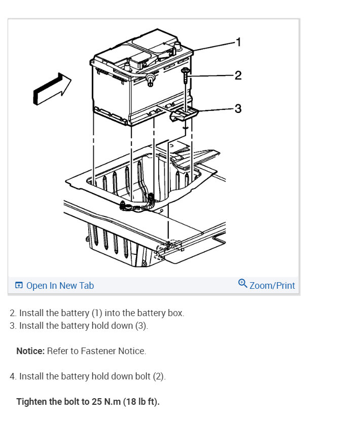

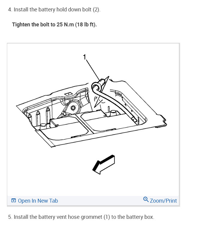

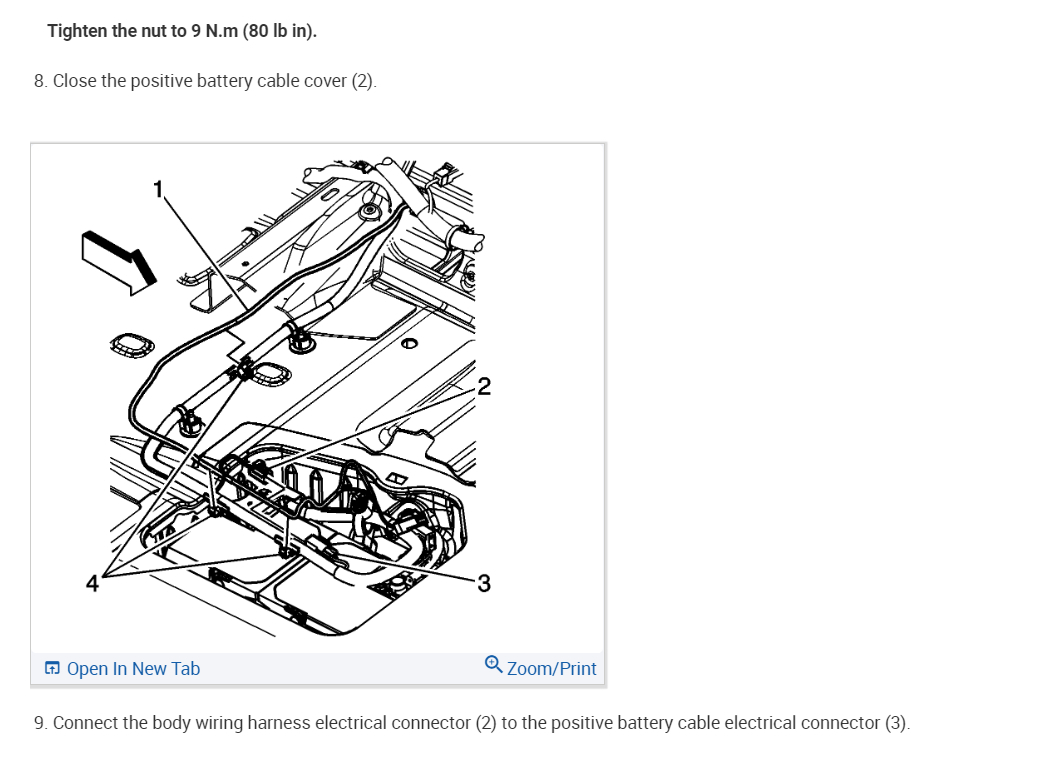

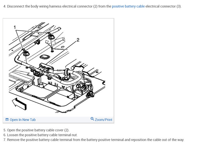

It sounds like the battery is weak, this guide can help confirm the problem:
If so, this generic guide will show how to change the battery and instructions in the images below to show you on your car:
https://www.2carpros.com/articles/how-to-replace-a-car-battery
Check out the images (below). Please let us know what you find. We are interested to see what it is.
