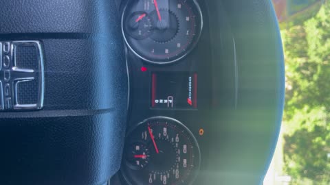

When I push the start button the car tries to start but won’t turn over all the way.

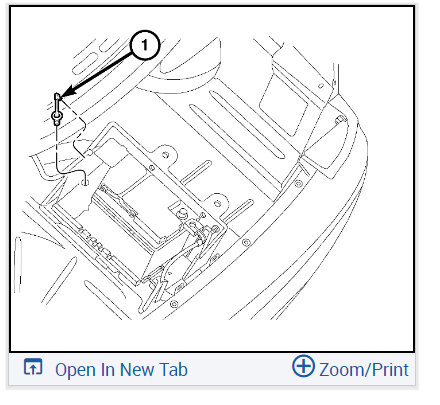

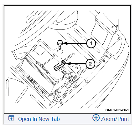

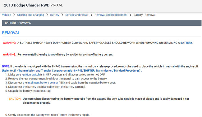

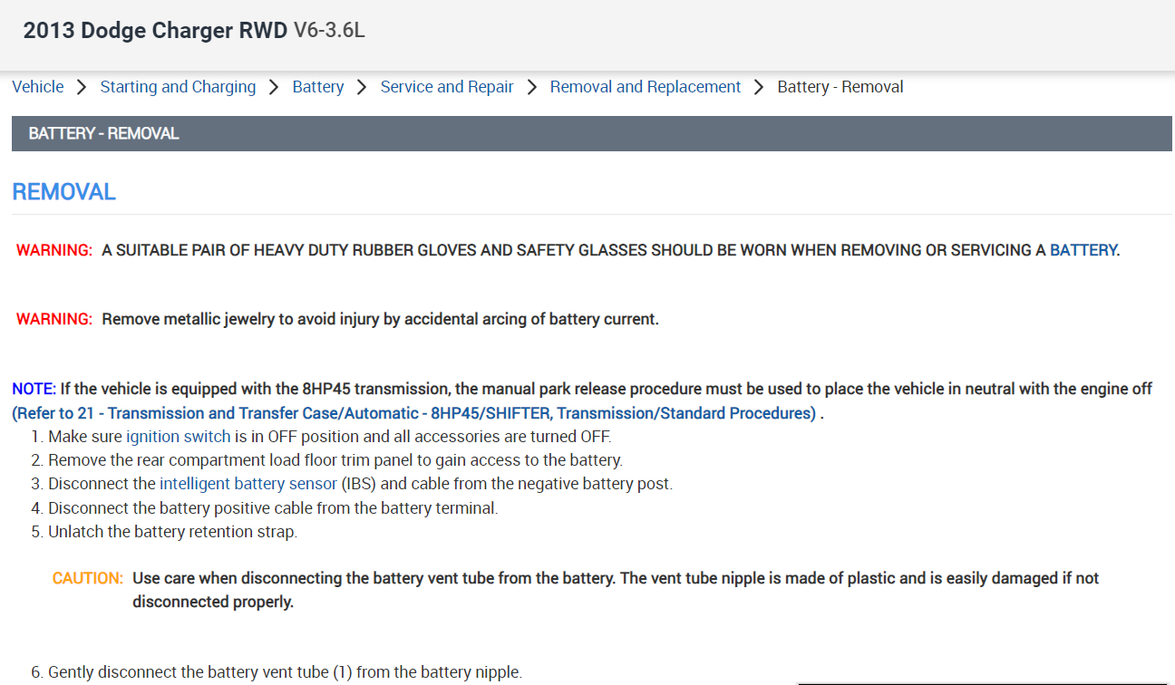

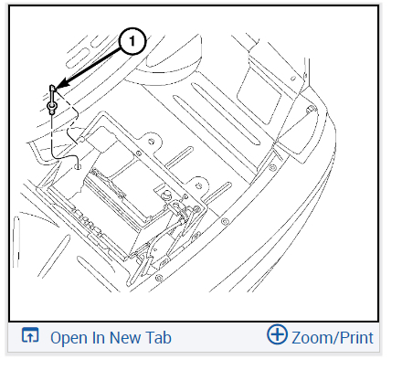

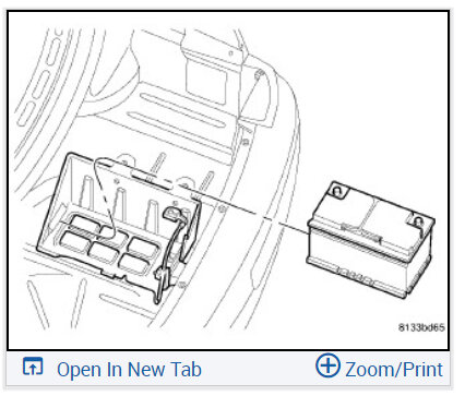

It sounds like you need a new battery, so the engine cranks over and then stops? Do you hear a ratcheting sound? We need more information to help you. Please upload a video in your response of any problems so we can see.
Here is how to remove the battery so you can have it tested:

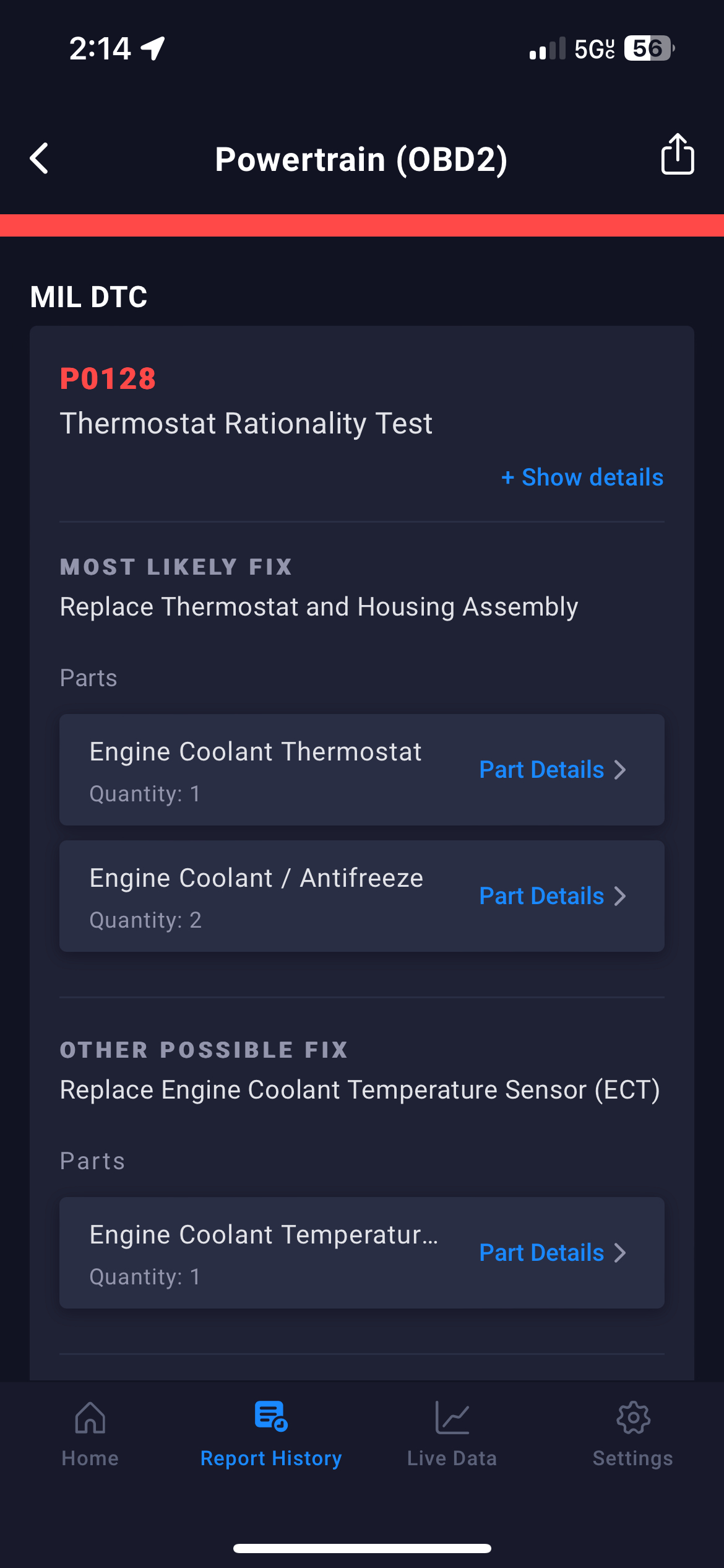

I’ve posted a picture of the codes.
Sep 9, 2024 at 11:13 AM
Okay, these cods are telling us the engine has over heated and that the thermostat needs to be replaced but this will not keep the engine from starting cold. I would head out to the auto parts store and rent a compression gauge for cheap or free and do the test.
