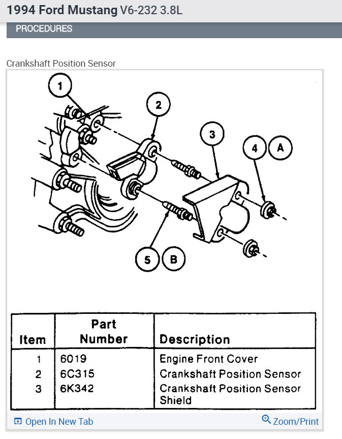

When i turn the car key on only the battery light pop's up. Fuel pump wont turn on. No spark from the spark plugs. And injectors wont pulse. I have already change the computer and the (CCRM). What can be the problem?
Jan 5, 2019 at 8:16 PM
It sounds like the crankshaft angle sensor has gone out. here is a guide to help walk you through the steps and the location of the sensor for your car is in the diagram below:

Jan 7, 2019 at 12:27 PM
PENN12345
I got it stared.
I run a hot direct wire to the PCM.
I guess there was a shortage in the hot wire somewhere.
Jan 8, 2019 at 1:09 PM
