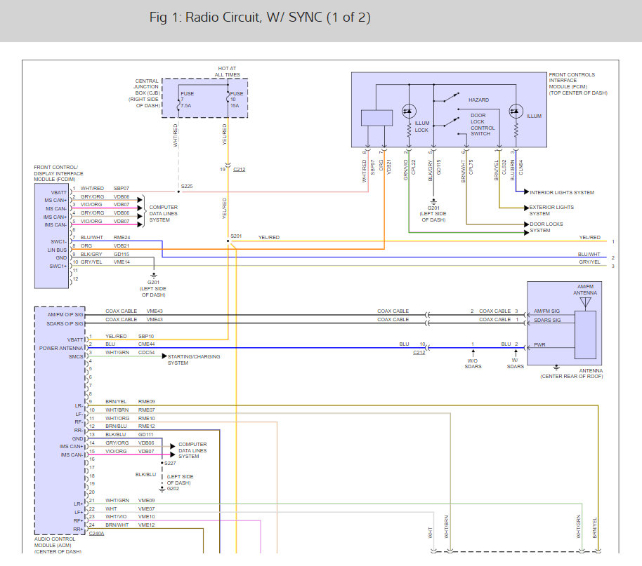

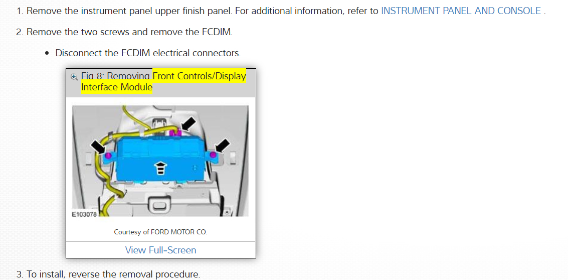

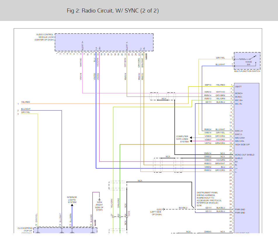

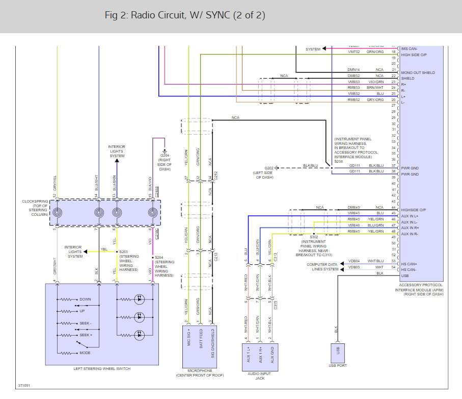

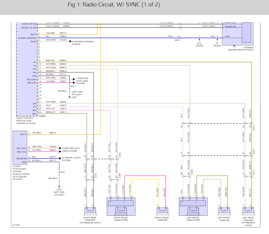

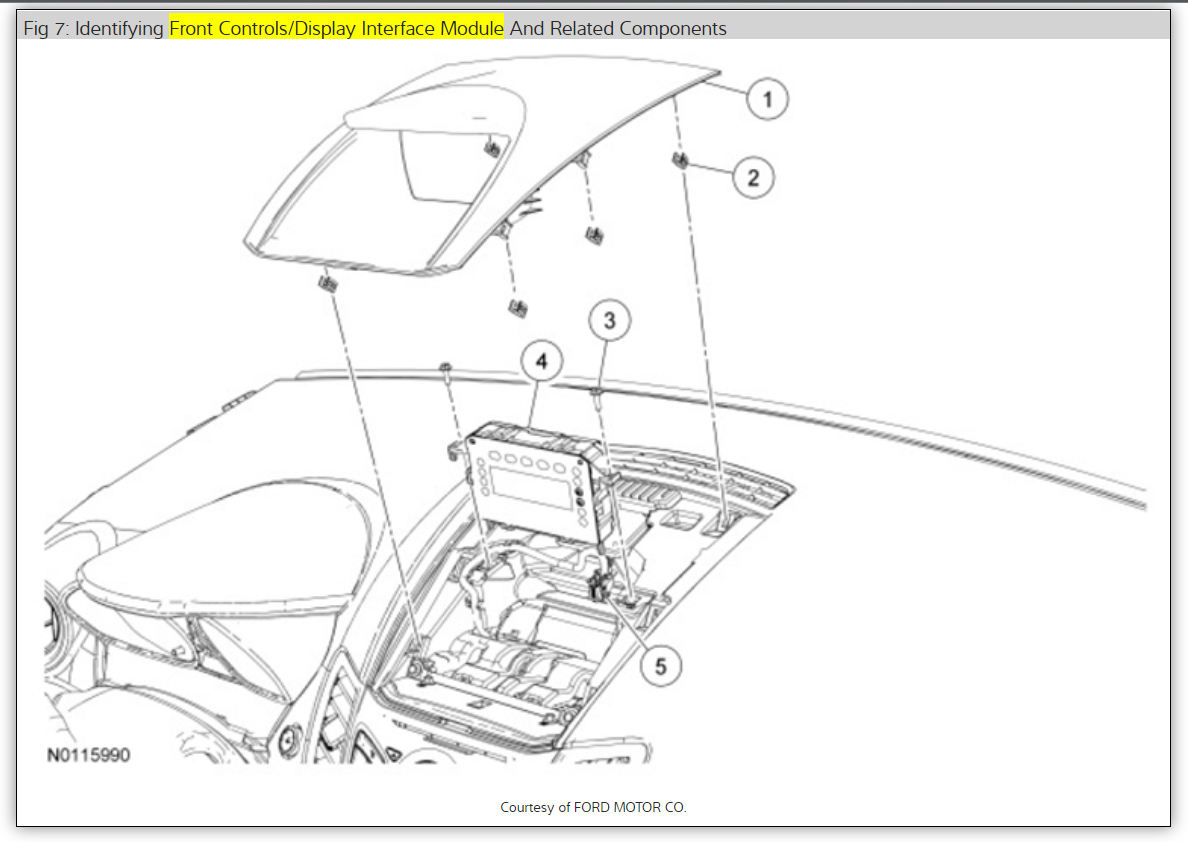

It sounds like the Front Controls Interface Module has gone out. Here is the radio wiring diagrams so you can see how the system works and the location of the module below. To be sure the CAN will need to be scanned which we are doing a video this saturday on which I have saved this post to add it to then. I will message you when its up. If the Interface Module is out it will need to be initialized before it will work which should cost about $130.00 at a shop.
