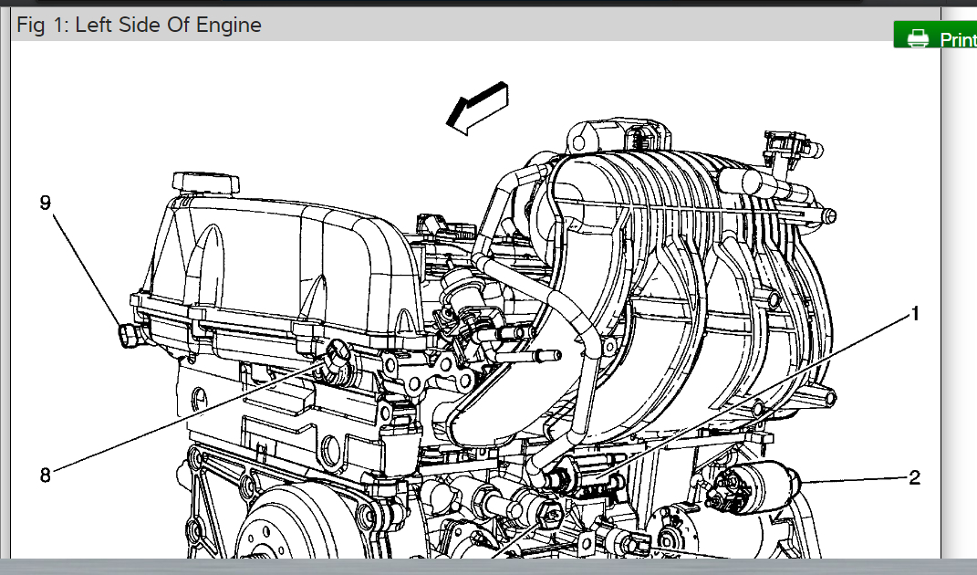

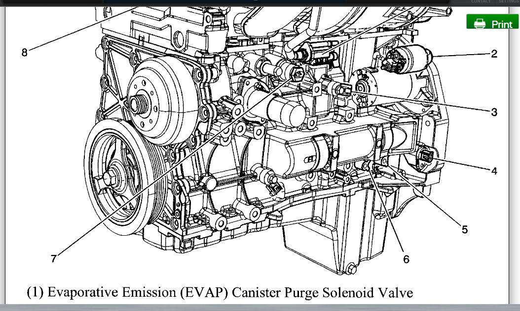

This could be a problem with your vehicle's Crankshaft Position Sensor (CKP) starting to fail. When a CKP sensor is starting to go bad, it exhibits exactly what you described in your question. I have included a few links below for you to go to:
https://www.2carpros.com/articles/how-a-crank-shaft-angle-sensor-works
I have also included the location of your vehicle's CKP in the diagrams down below. Please go through these guides and get back to us with what you are able to find out.
