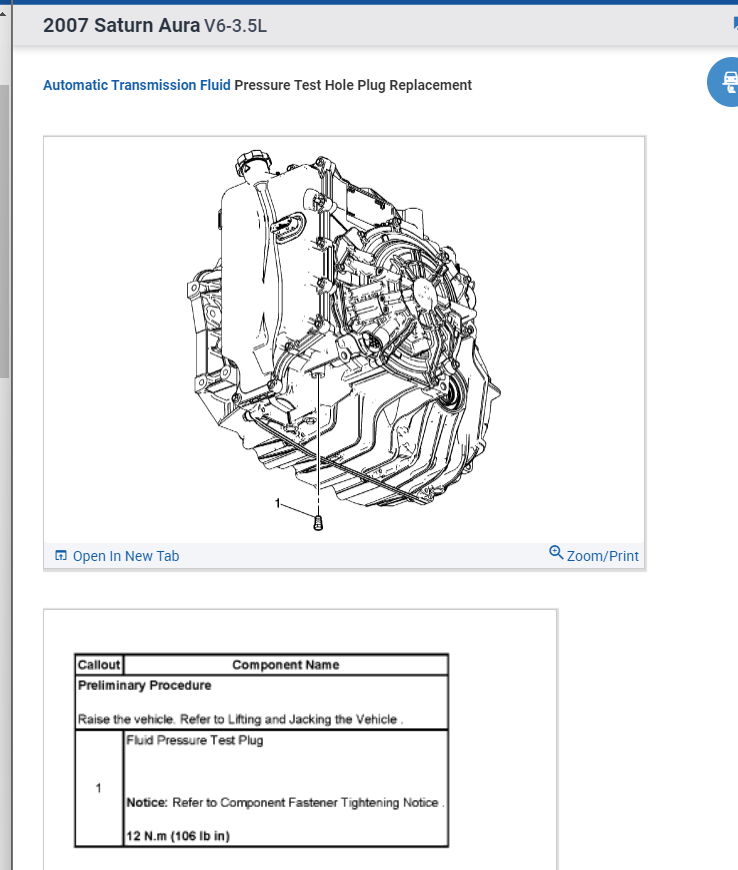

Once we know the fluid is the correct level then we will need to check the pressure when in drive and in reverse.
I am attaching the test port below which will be needed in order to find out the pressure.
Let's run through this and let me know what you find.
