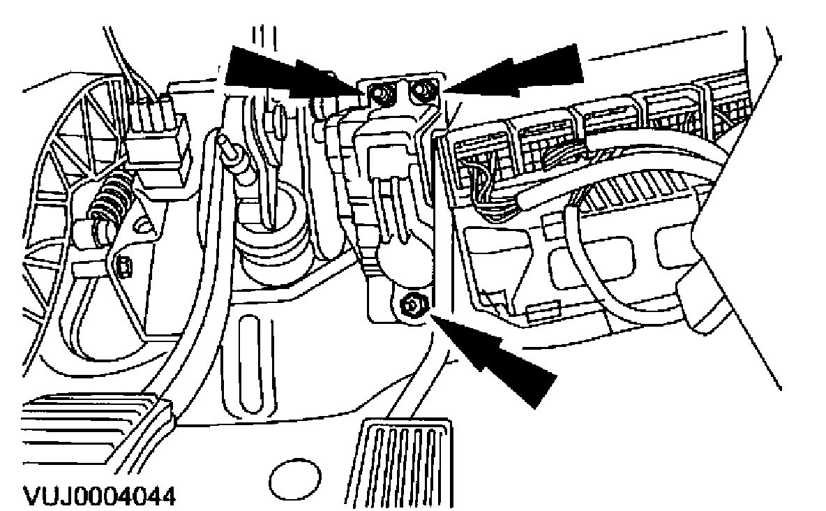

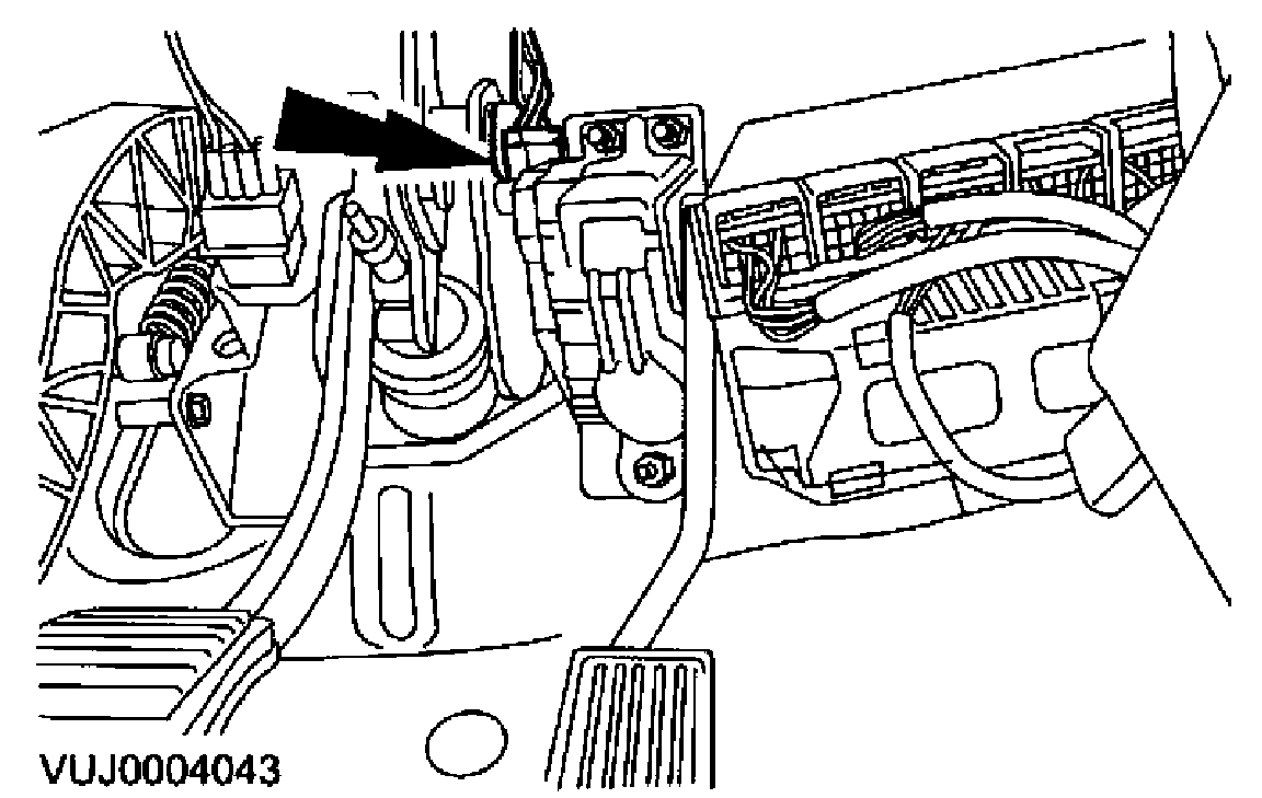

There is also a sensor on the gas pedal. Here are the directions for testing it. Let me know if you have the tools needed.

I attached two pics so you can see which sensor I am referring to. Let me know if this helps or if you have other questions.
