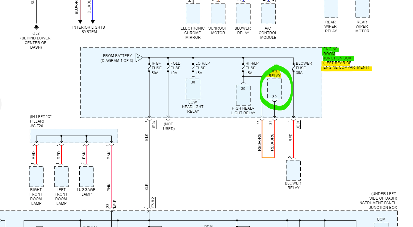

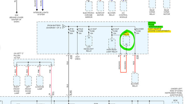

From some extra research on this issue because it's definitely the weird one for the month, one suggestion for a temporary fix was to remove the DRL Relay (daytime running lights). It might be something having to do with the headlight switch, brake lamp circuit because it's tied into the transmission control module, or some module needing an update or has failed. Do any lights work if turned on after you're in Drive? These cars have a lot of electrical issues. But try removing the relay to see if you can at least get your brake lights working. Because that's a safety issue there.
