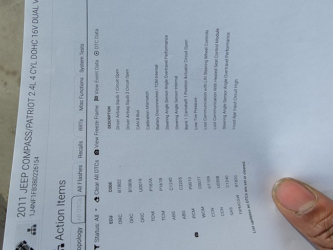

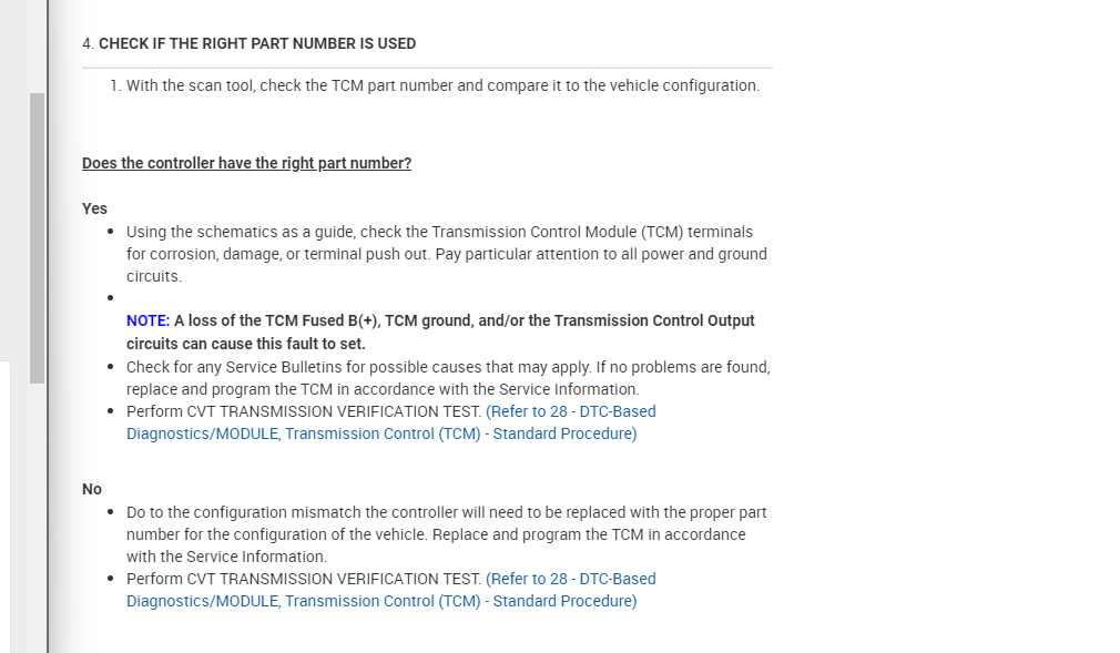

Okay. Let's start with the VIN of the other vehicle because your vehicle is telling you that the calibration in the TCM is not correct. So, can you contact the dealer and ask if they ran a report called a scan report and if you can have a copy of it?

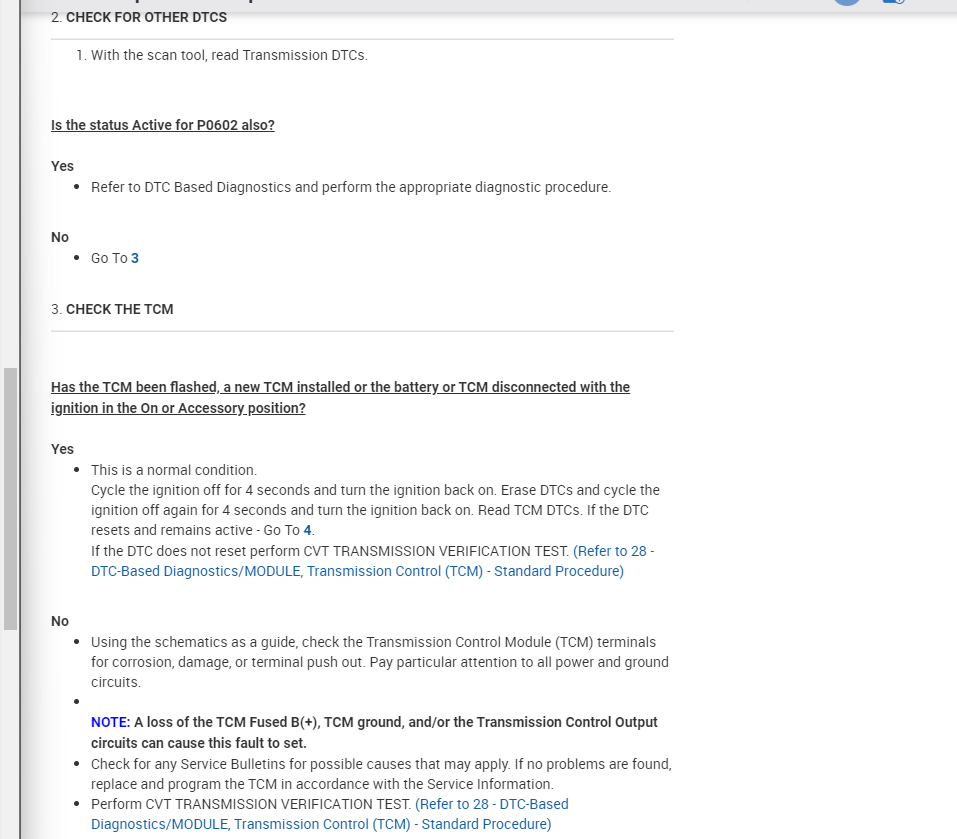

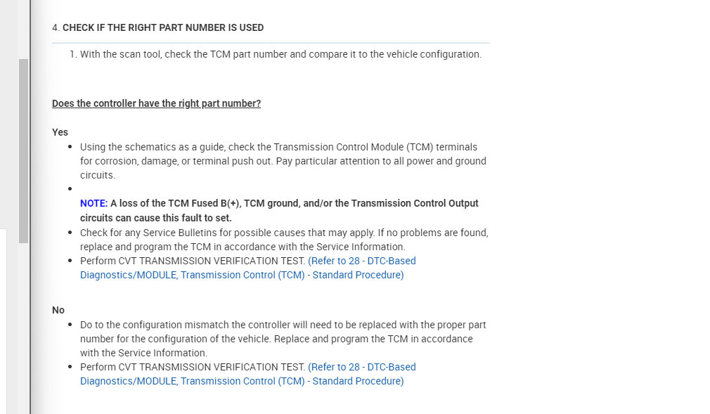

This is going to show the software number that is the TCM which I suspect is going to be wrong for this replacement transmission. Take a look at the attachment below.

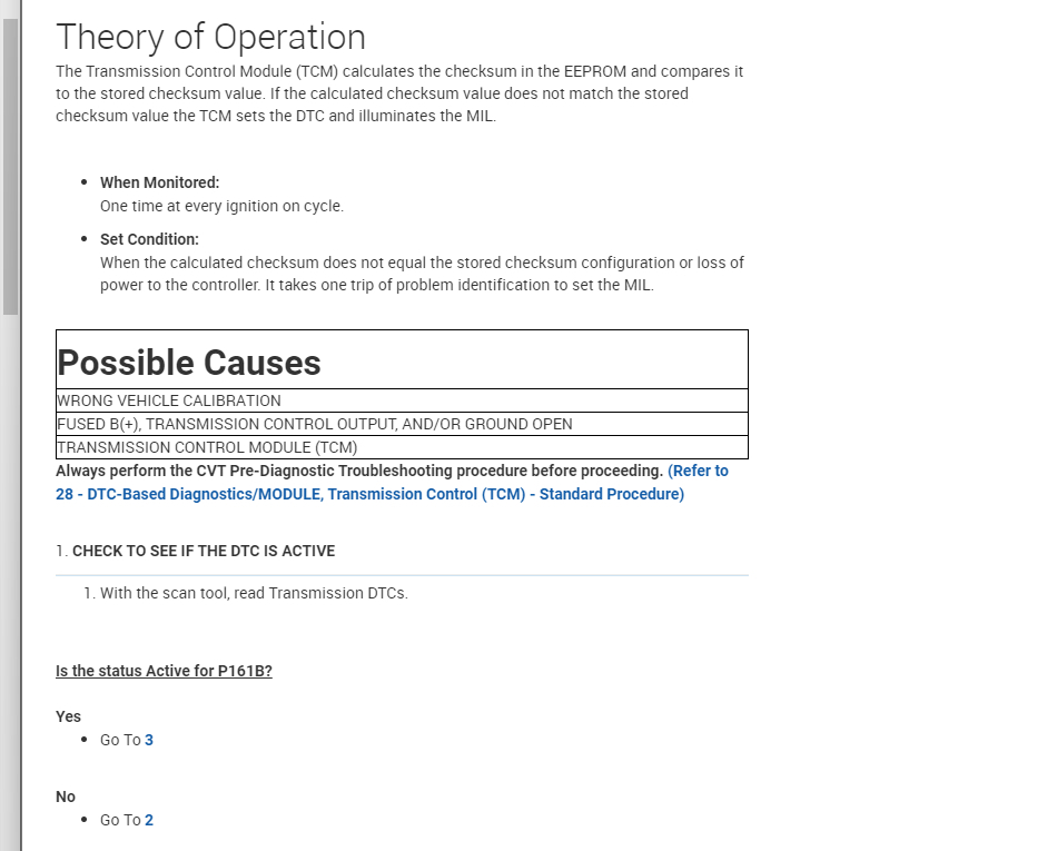

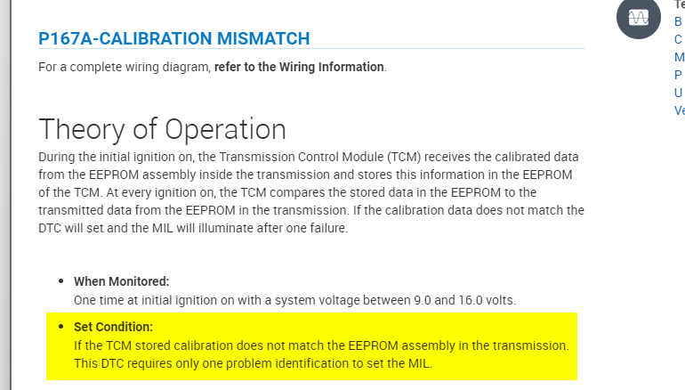

What this is telling you is that there is a software calibration in the transmission which the TCM needs to recognize. When it doesn't it sets this code.
You should be able to do a relearn process and it will correct this but if they did this relearn and the code is still there, it is not possible to relearn this again.

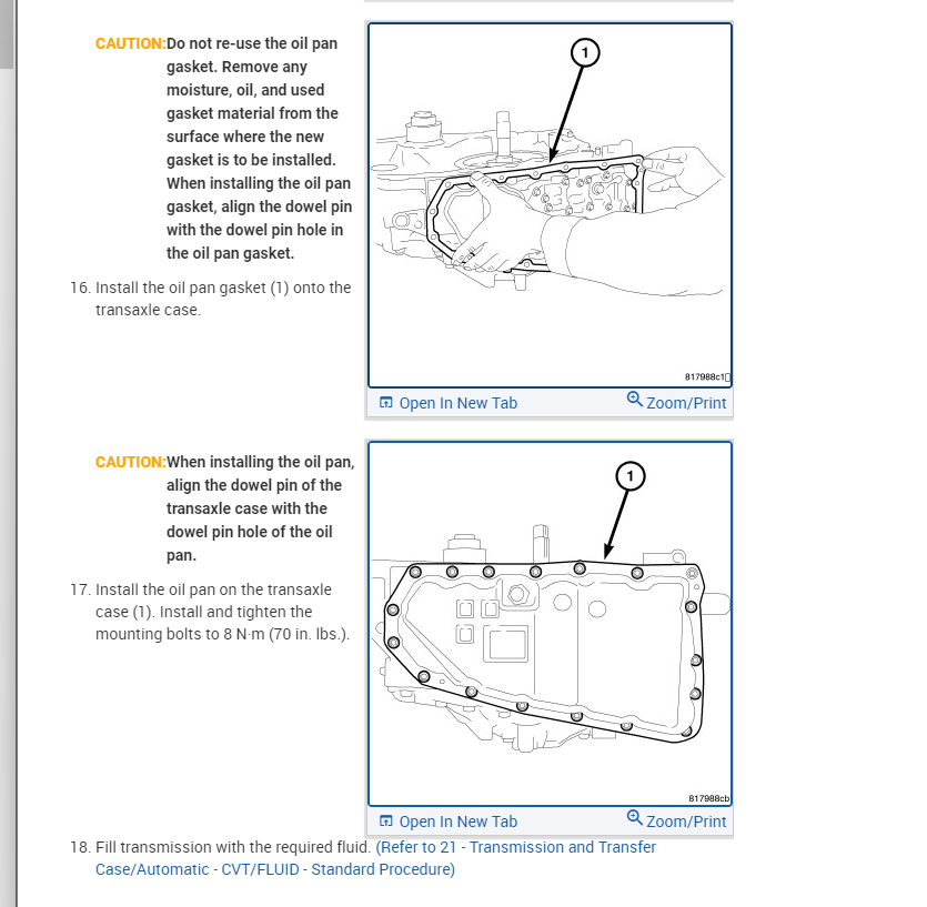

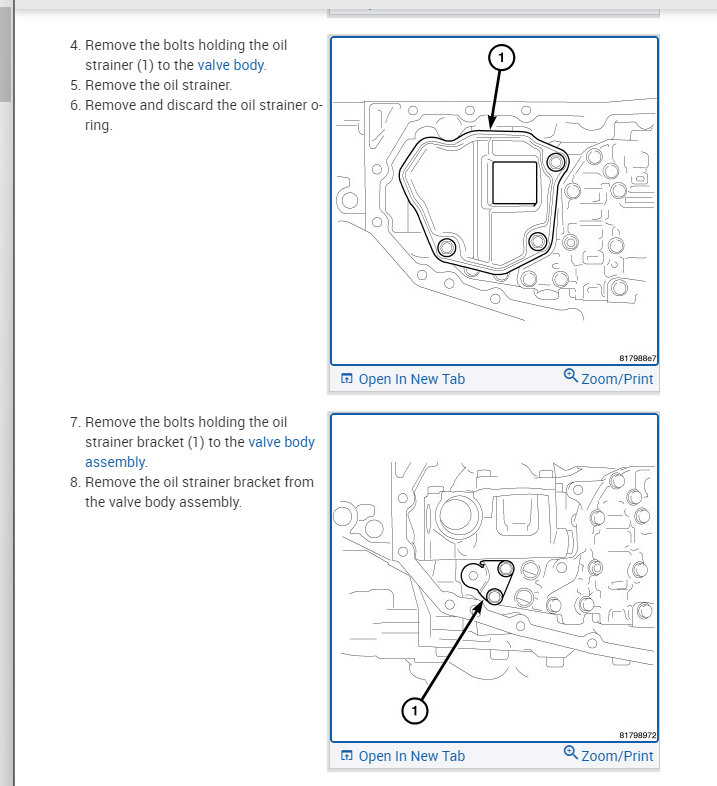

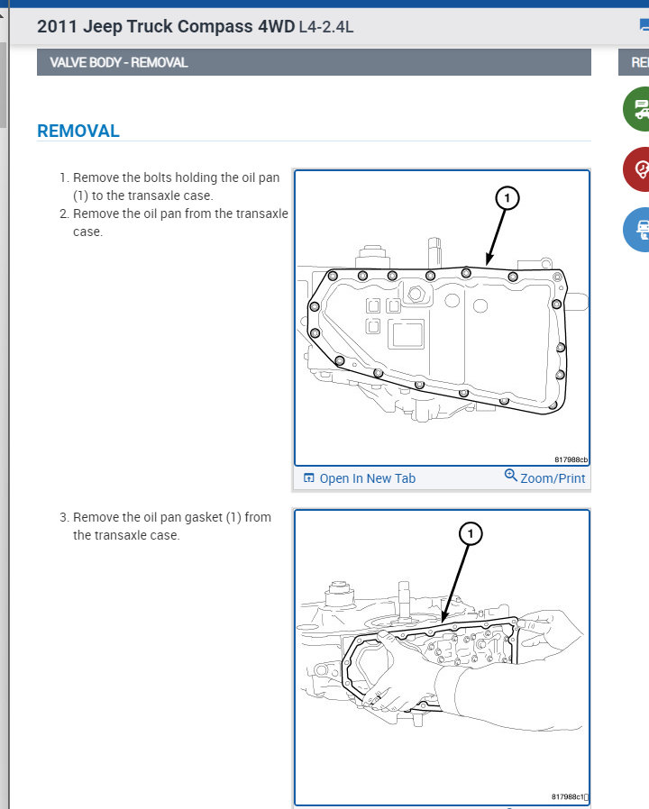

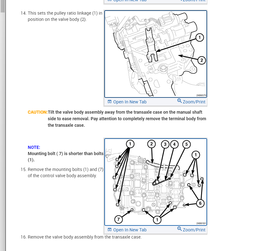

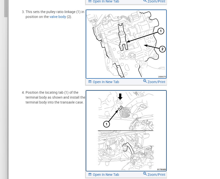

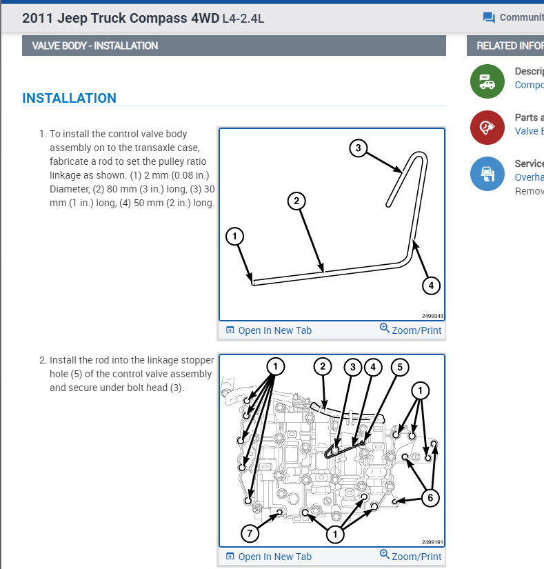

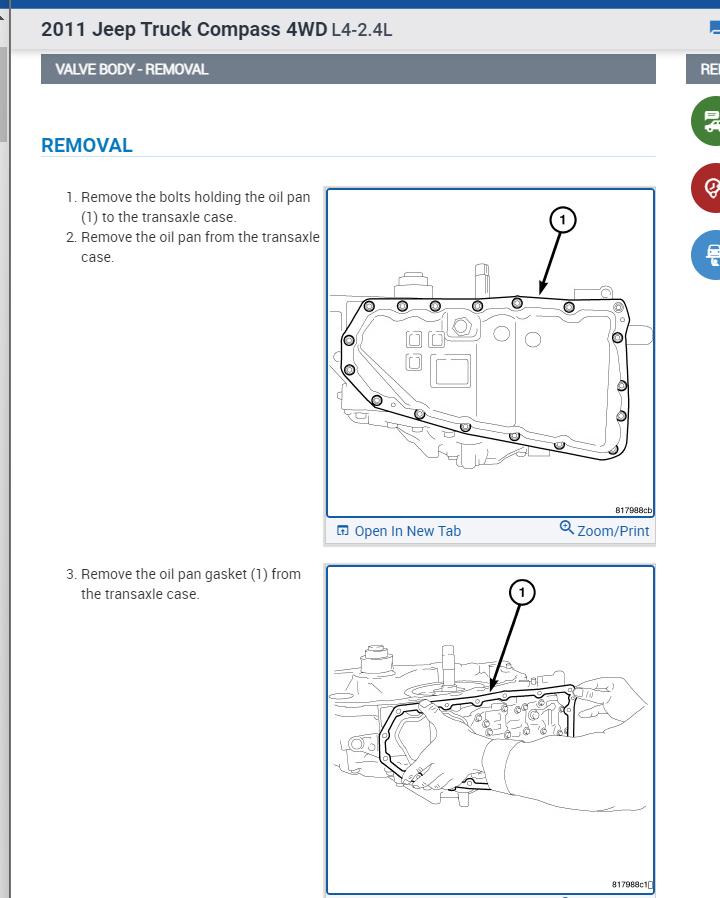

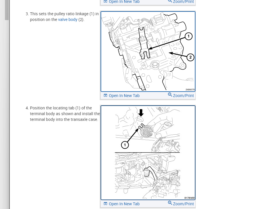

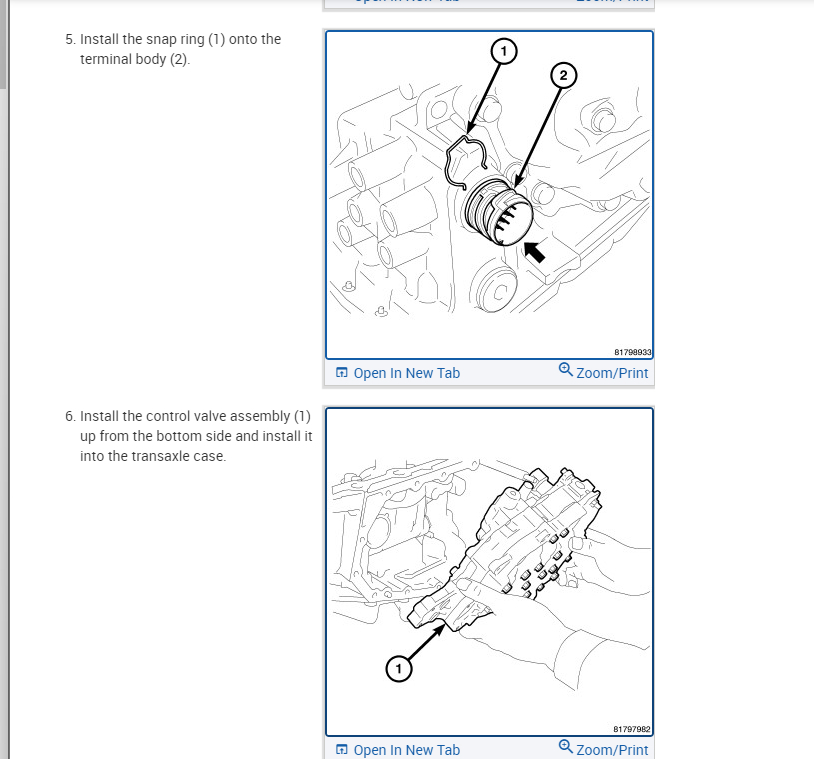

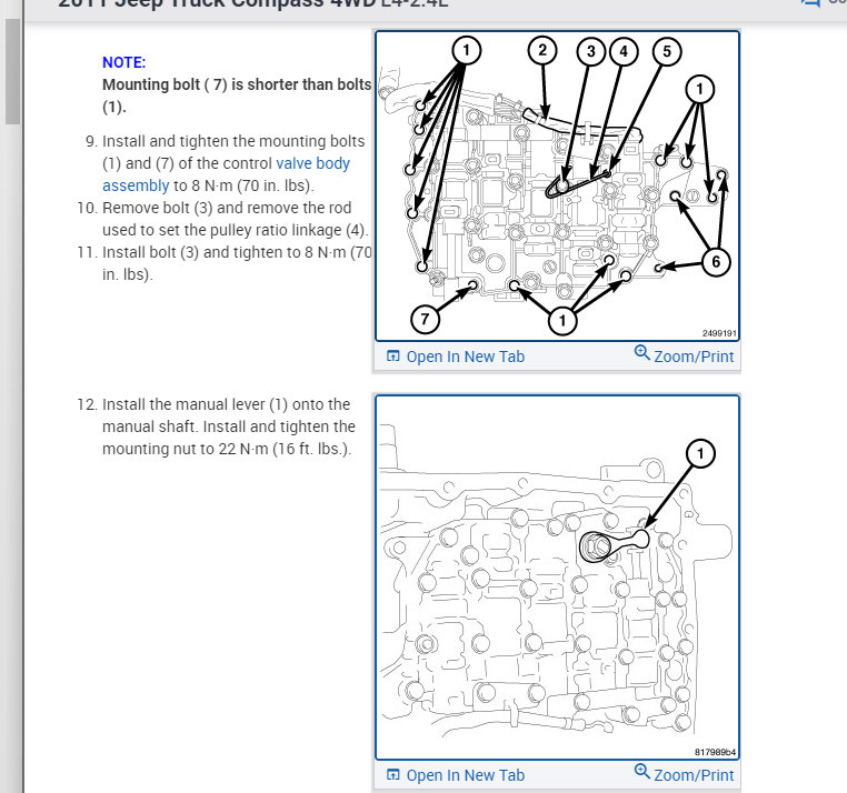

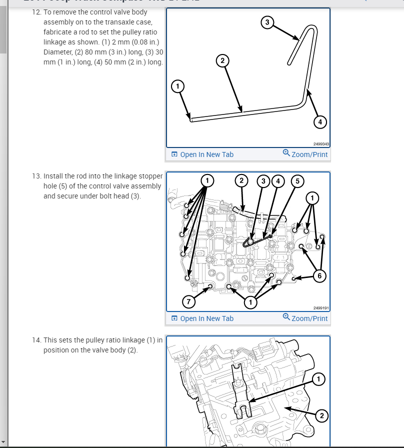

Which means it was learned to the previous vehicle and cannot be programmed again. At this point you would have to replace the valve body inside the transmission and then have it programmed to this vehicle.
So, the part number of the actual transmission may be the correct one, but the problem is this was already programmed to another TCM.

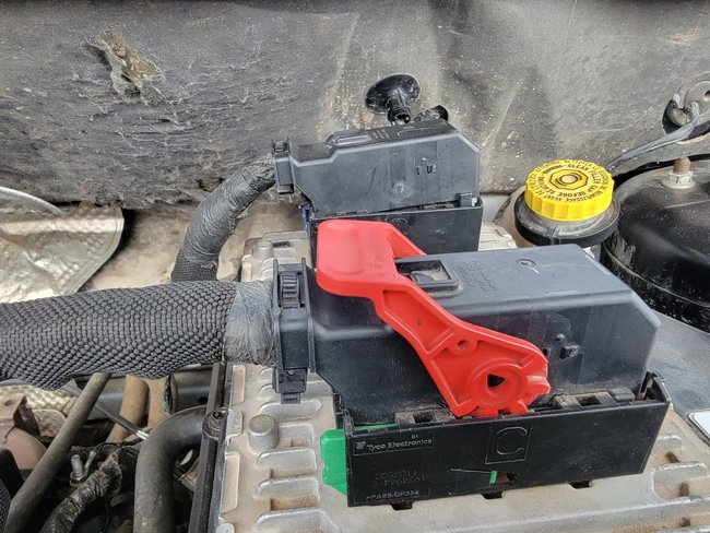

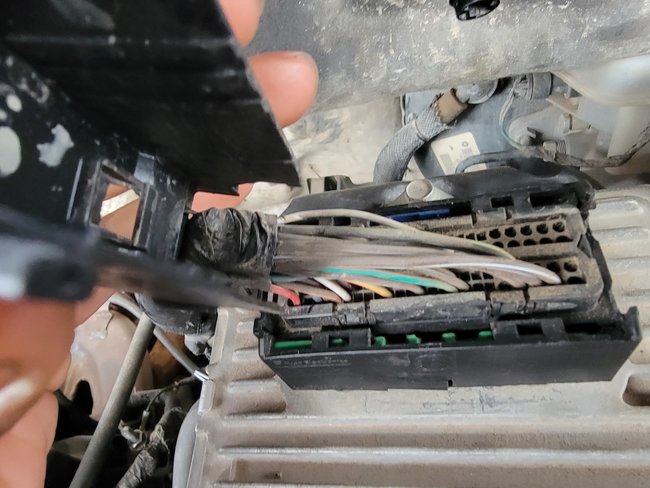

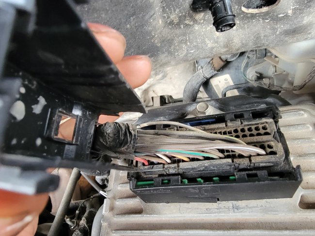

There may be an issue with the wiring connector, but I don't see this causing these codes.
