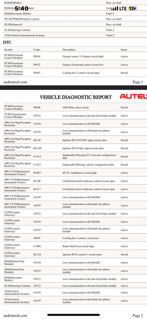

Hi Ken, the car listed above wont enter gears, when put in D Or R, no reactions at all. I noticed the ABS unit does not appear when I scan the car for fault codes.
2B3KA43G37H644931
May I as well get the can bus for the ABS, could be a short or open circuit in the wires. I have attached image of the codes below.

Yep, this looks like it might be the CAN BUS system, but the image with the codes is too small, I cant read it, can you please reload a more viewable version?

AUTEL
PCM(Powertrain
Control Module)
P0688
ASD/Main sense circuit
Stored
U0121
Lost communication with anti-lock brake module
Active
Sep 4, 2025 at 8:53 PM

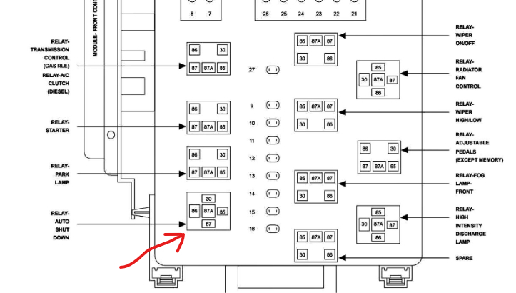

Cool, thanks, I would swap out eh ASD relay. here is the location. Check out the images (below). Let us know how it goes
Sep 5, 2025 at 5:56 PM
