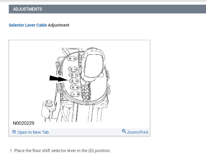

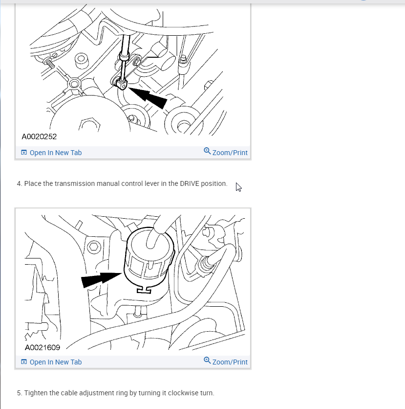

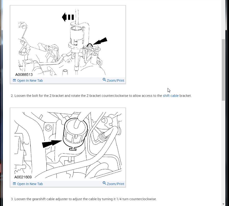

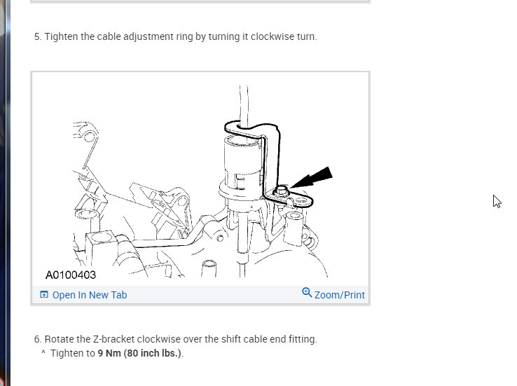

This is one of two things in most cases. Either the shift cable is pretty far out of adjustment so I attached the process for this.
