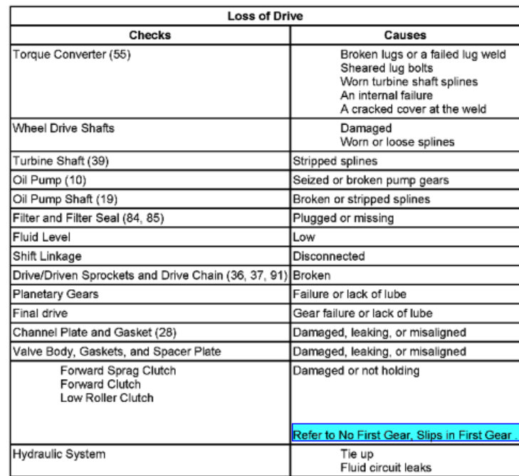

This does sound like a torque converter or fluid pump issue. You can perform a line pressure test to confirm this. If line pressure is low the transmission would need to be pulled to replace these items. I'd recommend a good salvage yard unit or reman transmission if so. I'll post the test info below. Most parts stores have the gauge in their loan a tool program.

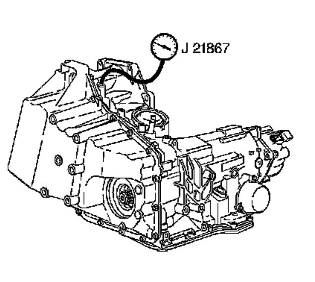

8. Remove the oil pressure test hole plug and install the J-21867-65 adapter (5.3L only) and the J 21867.

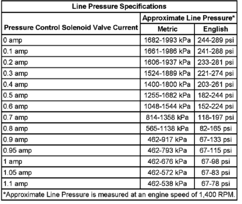

12. Increase the PC solenoid actual current from 0 to 1 amps in 0.1 amp increments. Allow the pressure to stabilize for five seconds after each
pressure change. Read the corresponding line pressure on the J 21867.
13. Refer to the Line Pressure specification table. Compare the data to the table.
