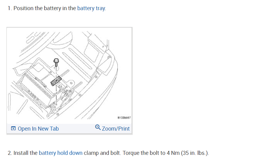

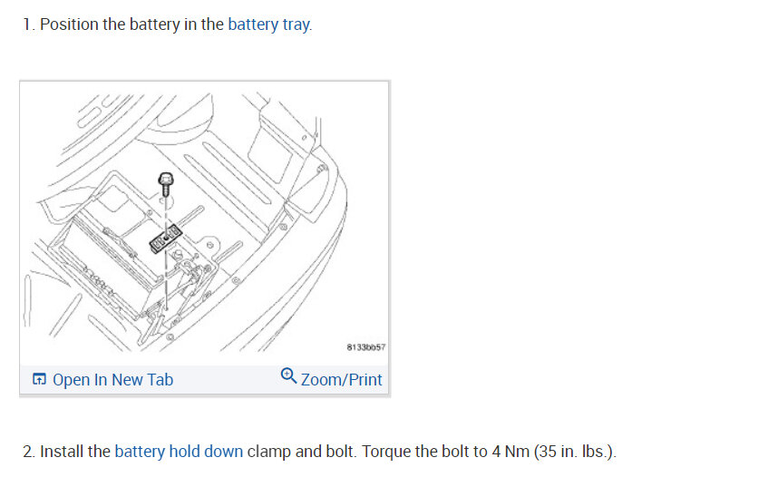

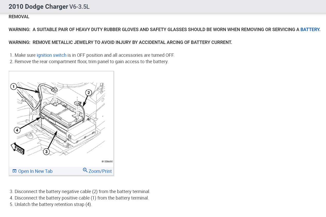

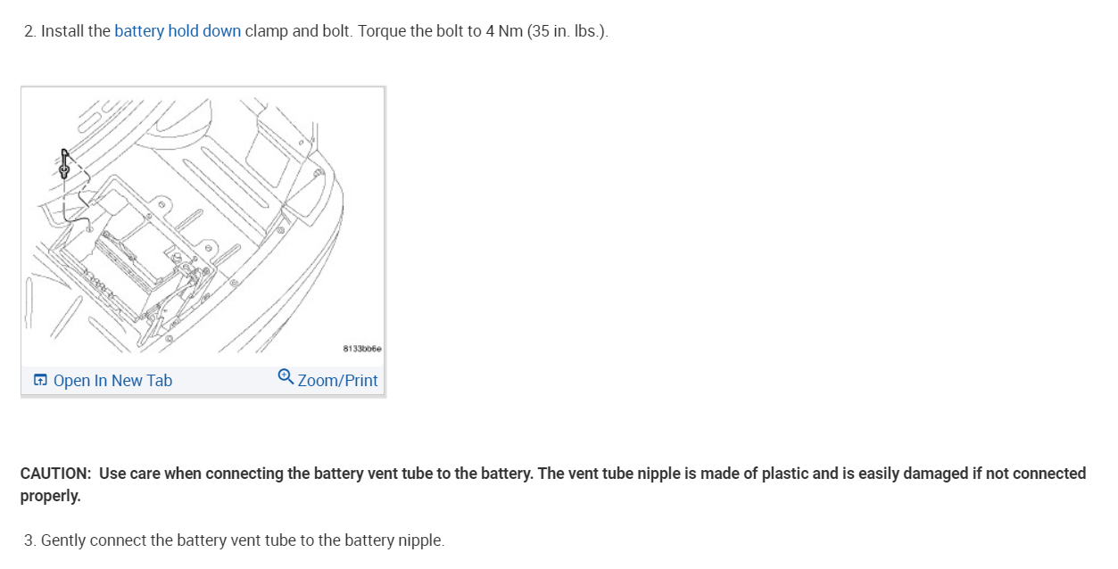

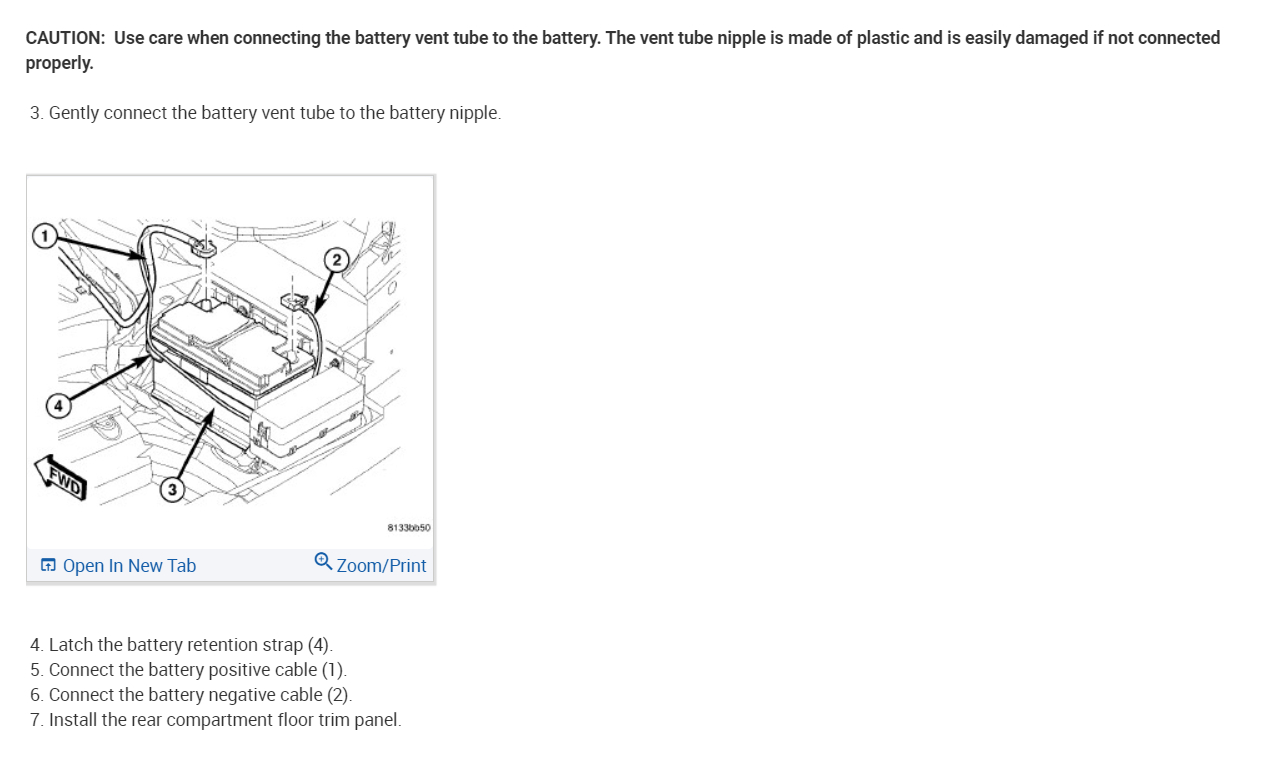

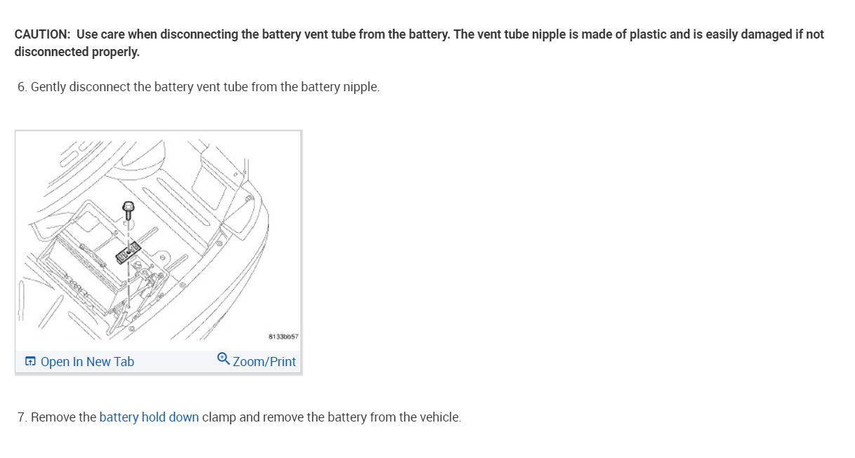

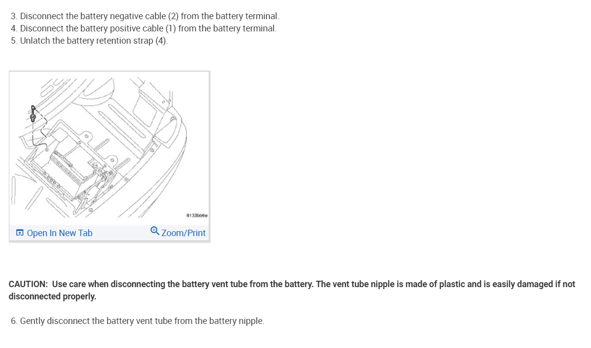

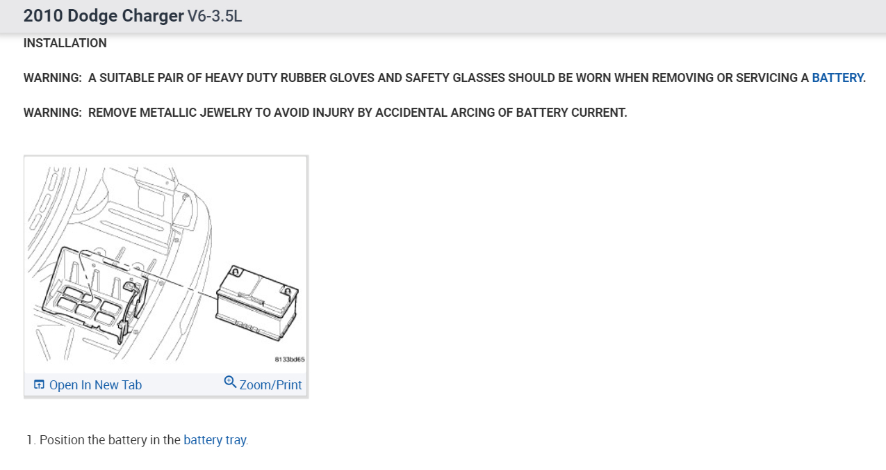

This sounds like a classic bad battery connection or a bad battery which is common in the wintertime. Here is how to clean the battery terminals or change the battery out step by step with instruction below to show you how on your car. Follow these guides to help fix the problem:
and
https://www.2carpros.com/articles/how-to-replace-a-car-battery
Check out the images (below). Let us know what happens and please upload pictures or videos of the problem.
