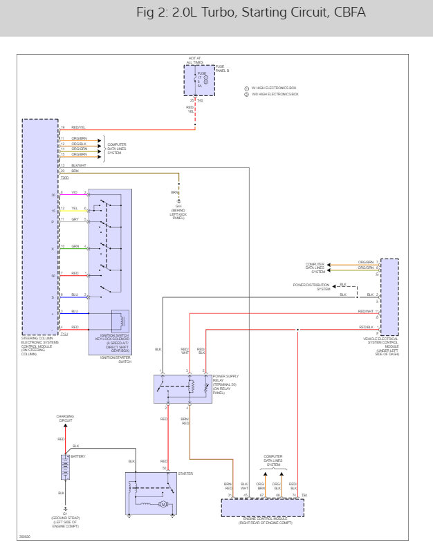

Car wont crank over and there are no clicking sounds or lights at all. The cap and all the accessory lights will not true on when key is turned. What could be the issue?

Can I ask if the security light is flashing? Also check for make sure the gear selector is in park all the way. Here is a the starting wiring diagrams so you can see how the system works and a guide to walk through to see what's going on:
